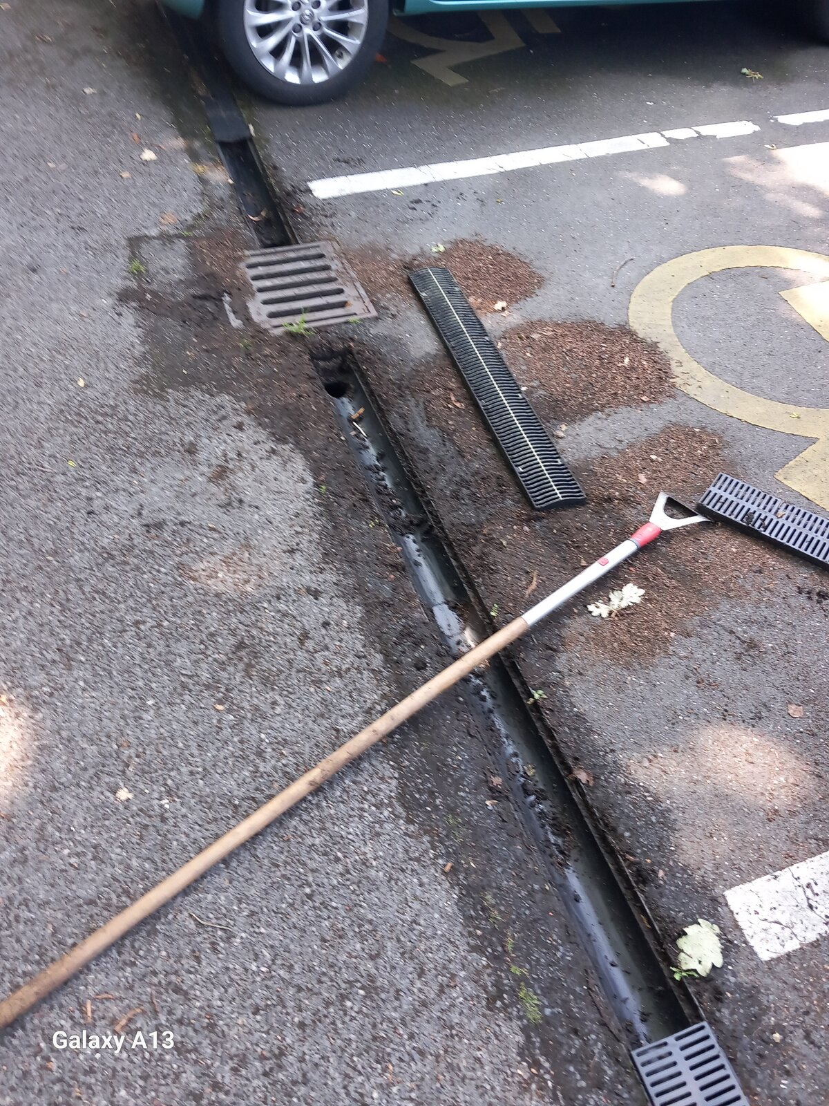

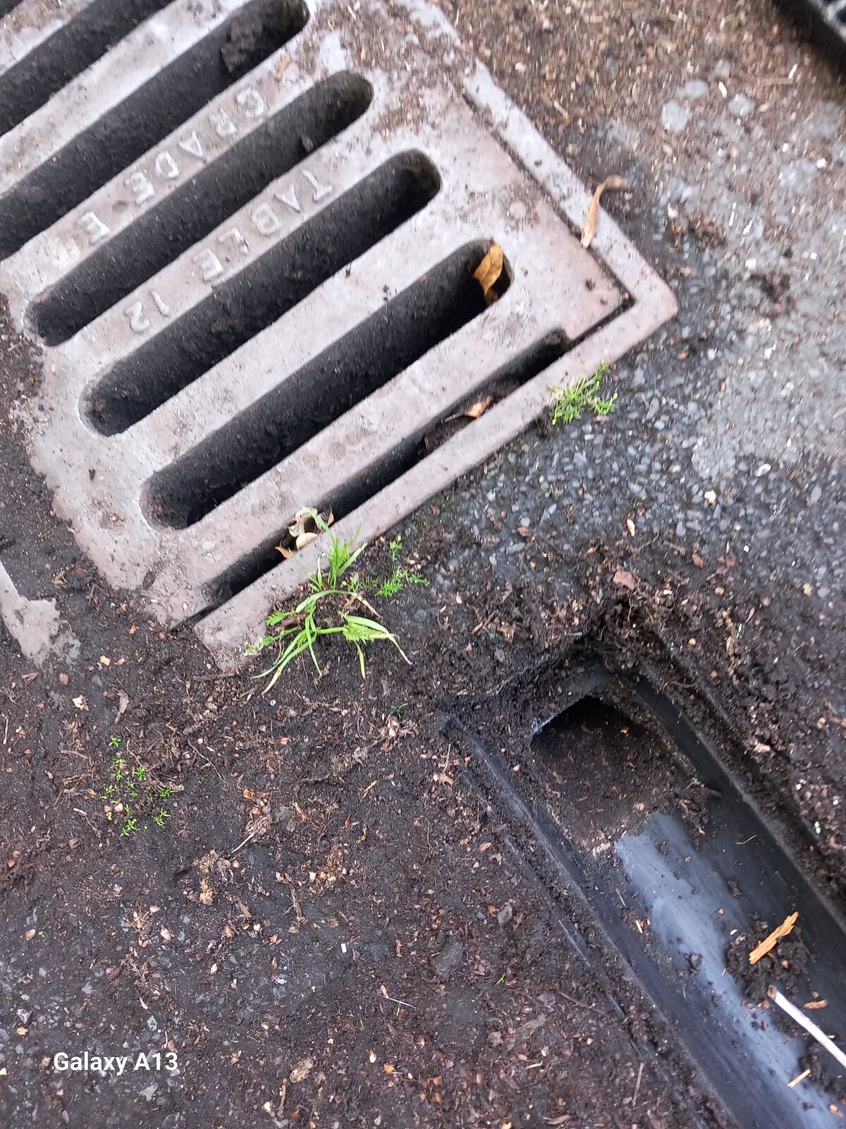

Tried pushing a wooden handle into this hole going into drain but wouldn't go through into drain. Drain rod with corkscrew attachment?
Bunged up with soil
Lift the lid and see what's what. Shovel out the accumulated mud, find the other end of that pipe then rinse the whole lot out with a hosepipe.
It looks a bit hand-crafted, possibly a length of square plastic downpipe concreted in. So it's probably fairly delicate so don't do anything daft like ramming a wooden pole down it.
I'd start with a long-armed glove!
