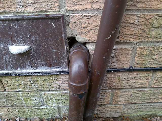

Hi, my kitchen sink drains very slowly. I have taken all the pipes under the sink and cleaned them but it is still slow so i can only assume the problem is the pipe that takes the waste to the outside drain but i cant get access from the kitchen end due to the kitchen units so the only way is from the outside. My problem is that on the outside there is an l-bend which I cannot get off to rod the pipe out. How do I get the l-bend off please :( Many thanks, Chris

That L bend you mention is it glued or a pushfit? If its glued then it won't come off. Better still can you take a picture of it?

Hi thanks for the help. Sorry, I cant take any pictures my at the moment. It must be glued as it just wont budge! There isnt much spare pipe. I will have to see if I can cut it off and get a pushon to replace it I think. Many thanks, most helpful and so fast as well :D

Hi sorry, I have looked at it properly with the pics provided, thanks! It is the glued/welded sort. I have tried soda crystals to no avail. Would you suggest trying oneshot or something like that? Taking the back off the unit isn't an option as I have felt where the pipe goes and it seams to go underneath the unit so I would have to cut the base off the unit if that makes sence? Just to clarify the sink is not on an outside wall and the pipe run to the outside is approx 1m. Thanks again!
Ok got a picture from my mobile, how many years have I had a camera on a phone and never used it! Hope this helps!
Solvent weld it is then.
Have you checked where the pipe terminates in the drain?
Hi sorry I should have taken another photo. The pipe doesn't go into the drain it exits onto a cover and the little drop after the l-bend is clear. Thanks
Exellent to get a pic :wink: - There is a Get Over It thing you can do :idea: --If you drill a hole in the bend so you can get a cleaning wire thru` ...you then whittle a piece of wood to fit the hole like a plug in a cask of beer- you could smear a bit of silicone sealer round it after.
Thats a cracking idea! will give that a go tomorrow. Just hope it is a straight run to the blockage, cant really see it being anything else but who knows!
