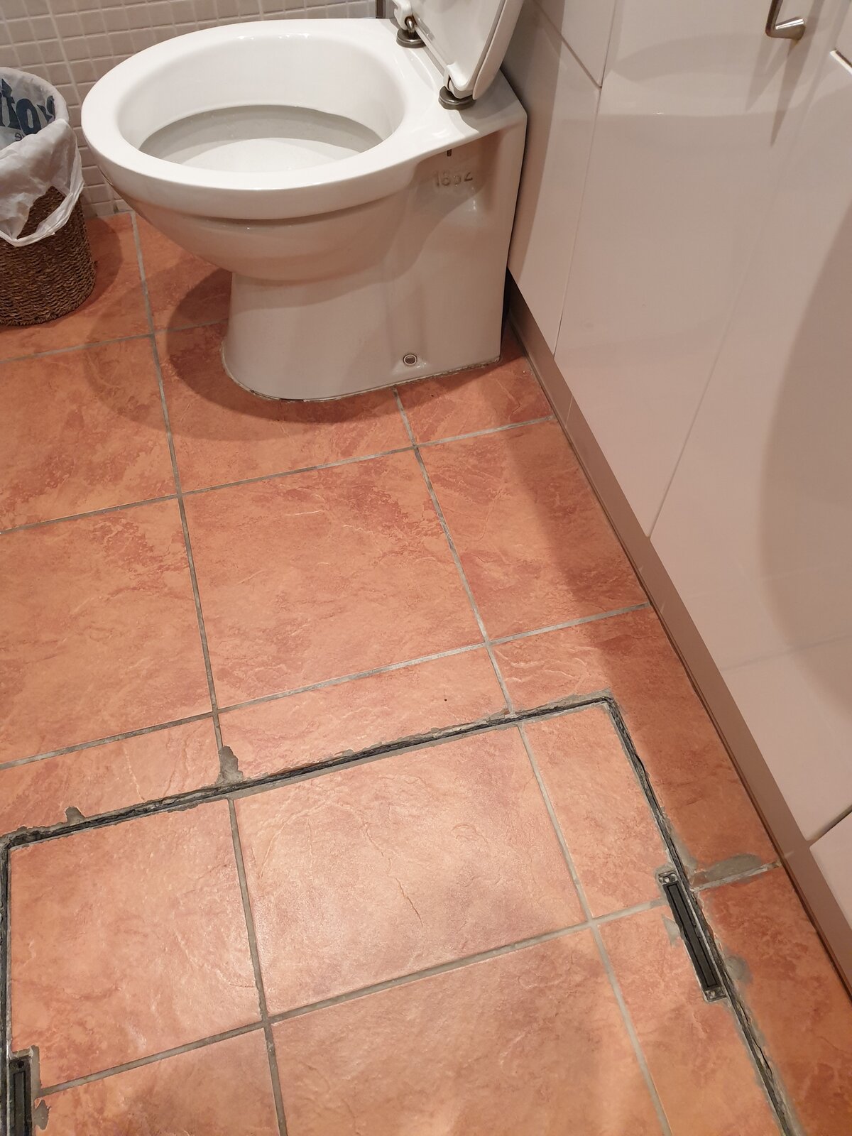

Can you put a pic up of the cover? May be able to offer some tips.

For information, the wall you can see behind the toilet, the other side, is the garden - this is a downstairs toilet/shower room in a 30yr+ extension and, as such, doesn't get used as much as the main upstairs bathroom.
Pictures below.

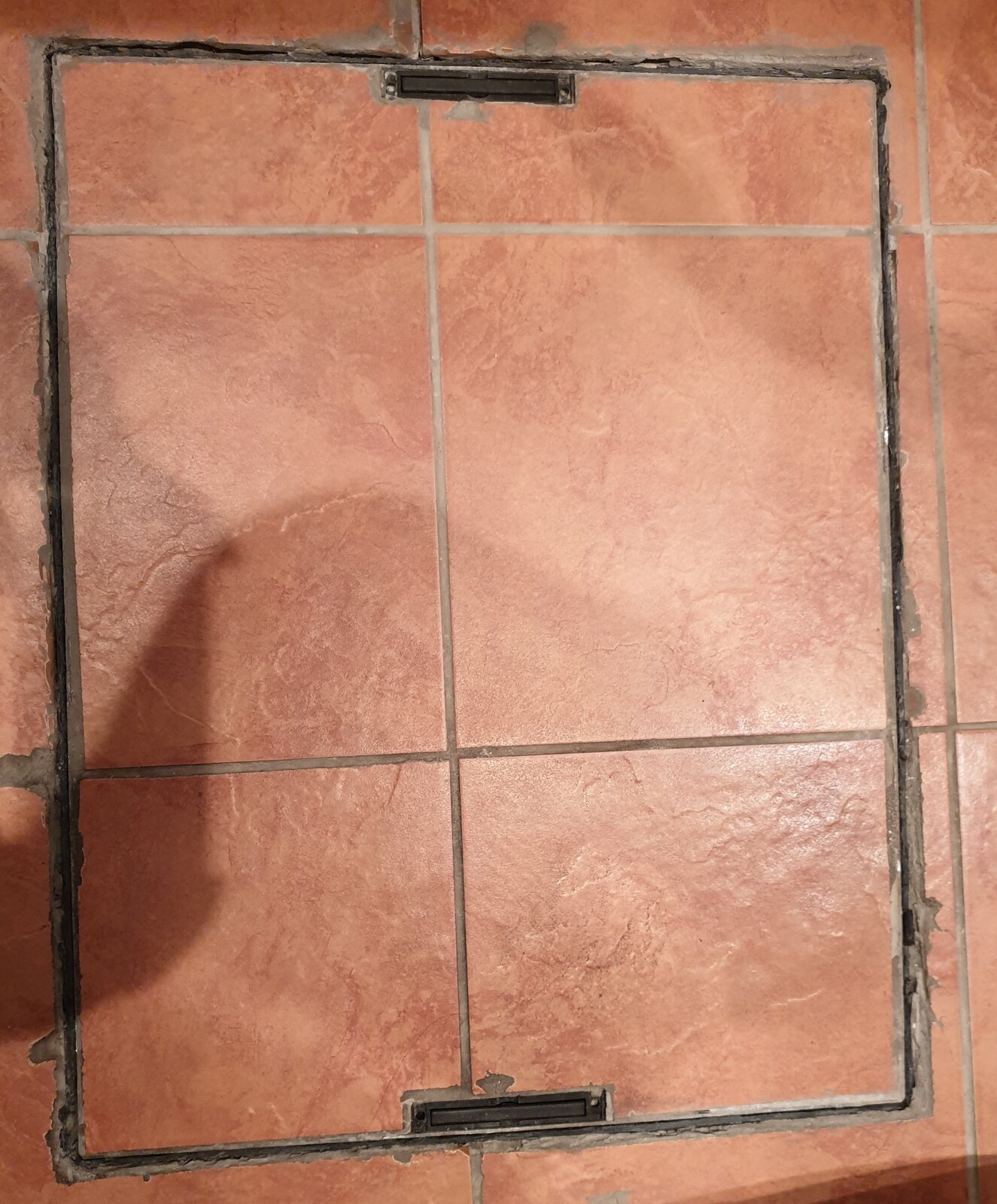

Ok, not an easy one.
2 large screwdrivers pushed in between the lid and edge and use a 'walk up and down method'.
I take it you have tried using the handles.
Andy
Is that not a couple of lift up handles I see? Like on a recessed cover?
If its a shared sewer that is the issue, then it is the Water Company's issue. Likewise, a private sewer (serving one property), from the point it goes under the boundary into a neighbours property, should be the Water Co's remit.
With the Cover, pull both handles up, and if need be, get an assistant, and try and lift it squarely upwards. It must be lifted square or it'll pinch and jam.
Google "responsibility for drains " and loads of diagrams will be revealed . Not necessarily as you thought nowadays;) As to the manhole , maybe there are keyholes under the black strips.
Believe those covers can be deep & heavy so having built in handles or a pair of keys would be most helpful

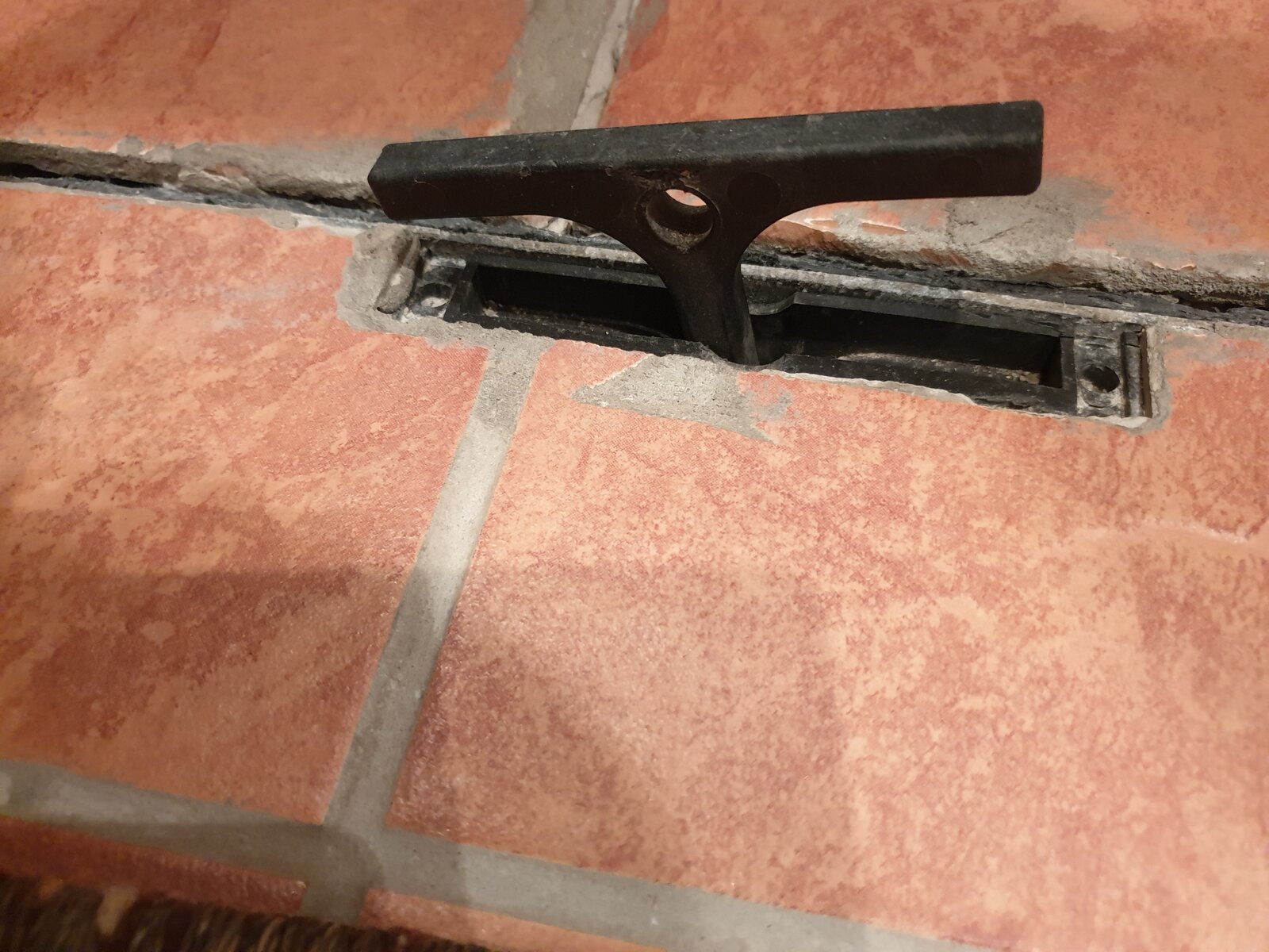

Yes, it has recessed handles which you lift up to use.
Have tried lifting with the handles but would not budge so have assumed there is still some grouting in place which needs to be chiselled out but, for the life of me can't see where.
Tried to pry one corner with a small pry bar and there was some movement but was worried about cracking the tiles so stopped - felt as if there was still some resistance so again assumed there may still be some grout in situ but based on some of the replies here could be the weight of the hatch.
