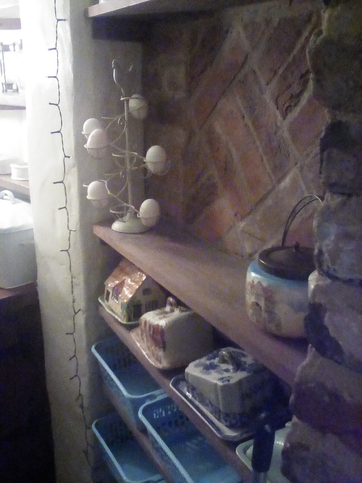

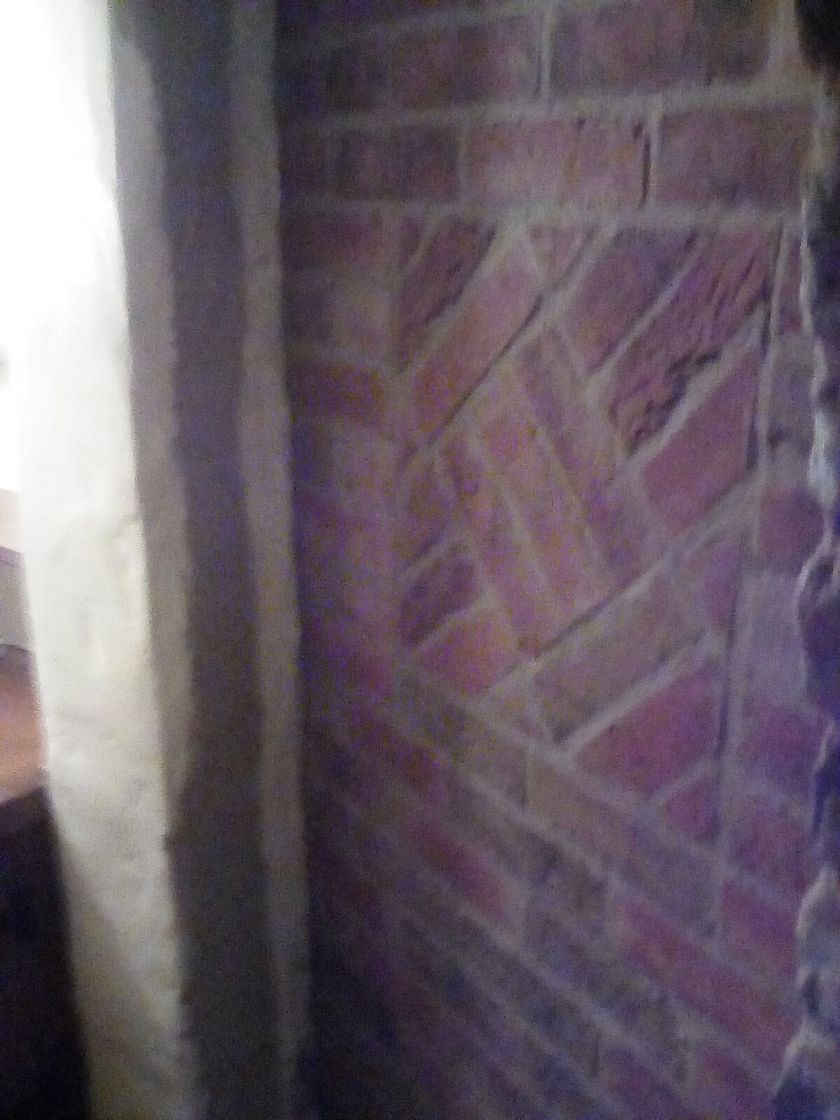

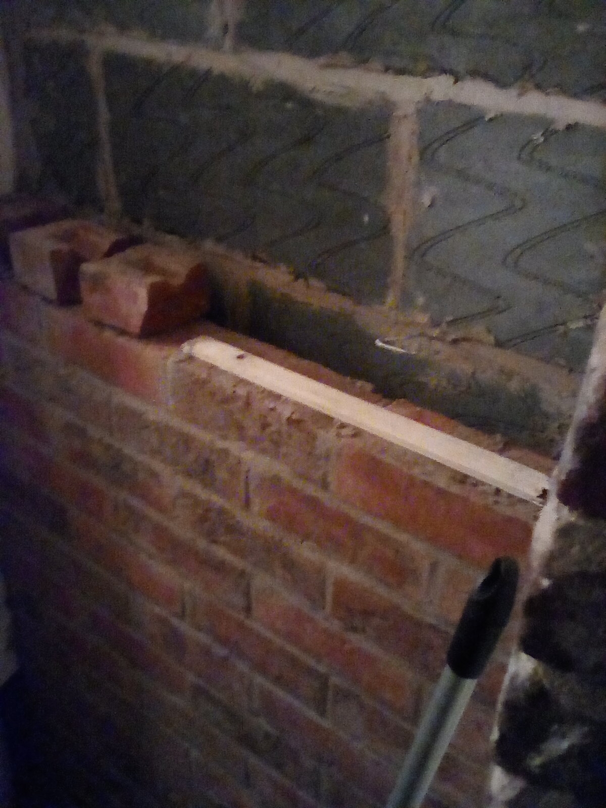

Exactly! I'm no bricklayer, but years ago, I needed a door bricked up, and an alternative door opened up. As the bricks were bare, and on show, I opted to tooth the bricks in properly, and use original matching bricks, from my store, plus what came out from the opened up new door. I would challenge anyone, to spot where in the wall, the door used to be. It wasn't difficult, it only needed a bit of straight timber, to properly align it, as I built.

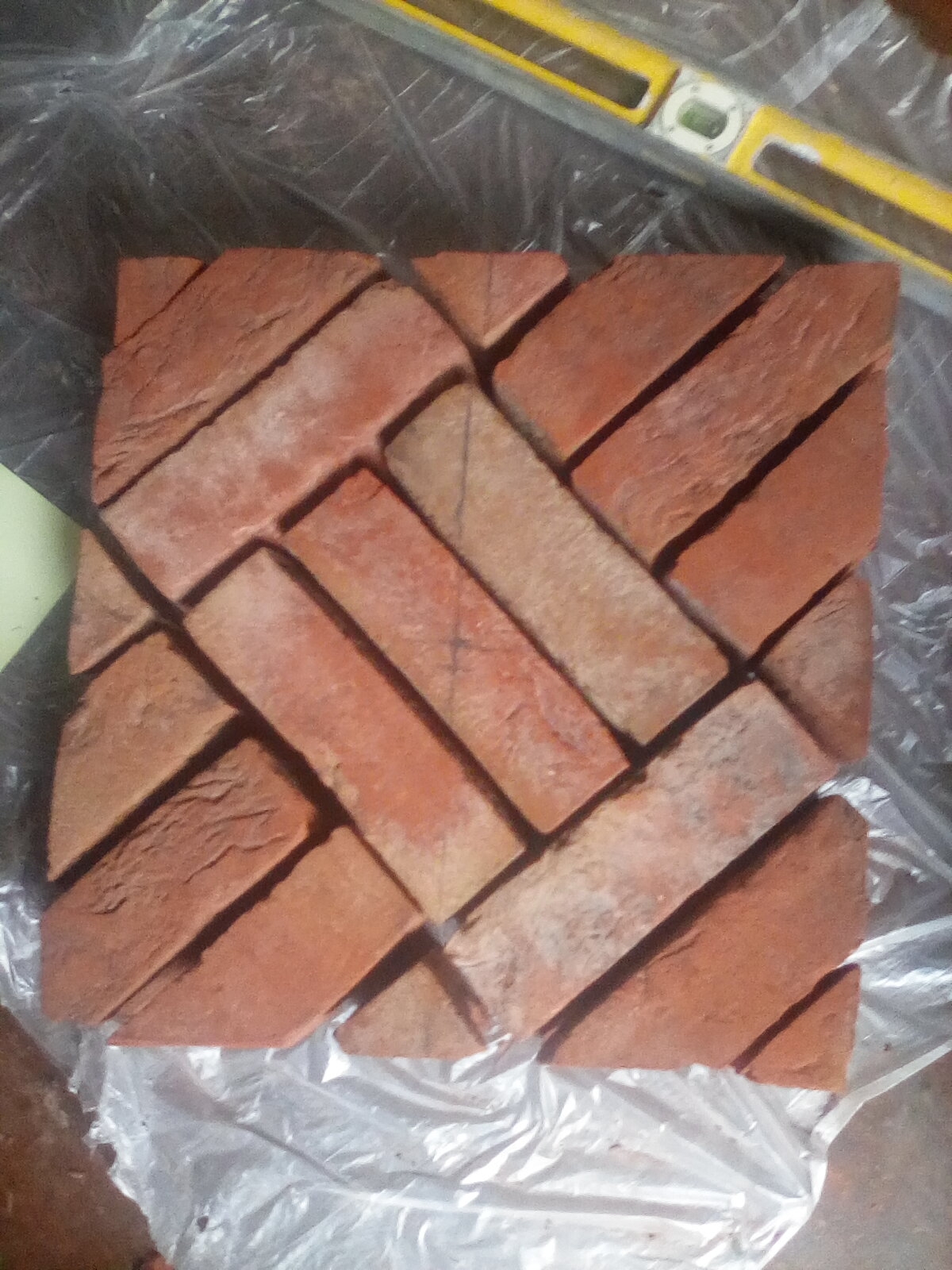

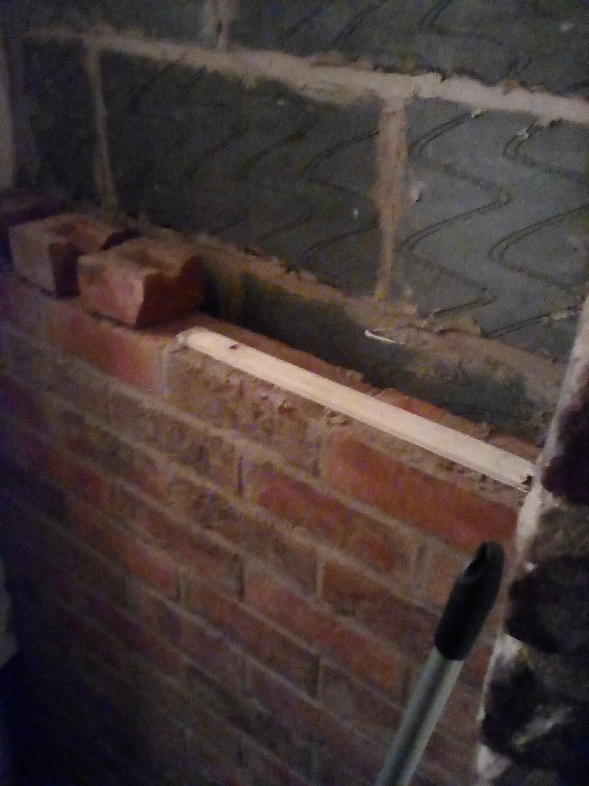

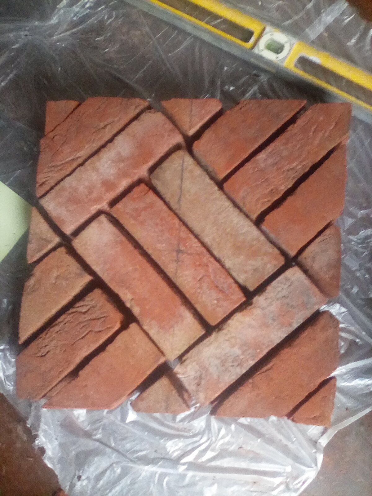

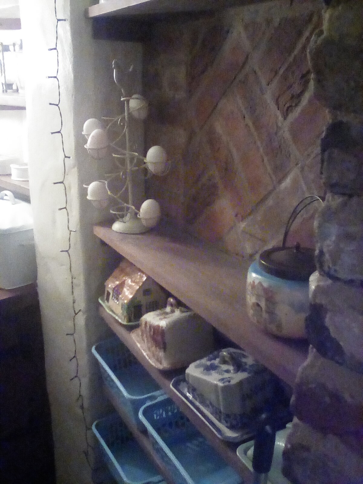

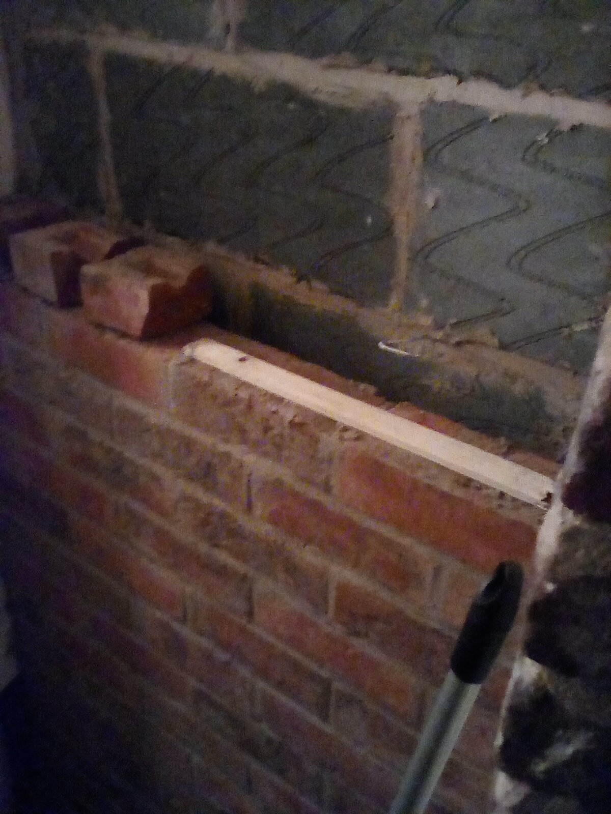

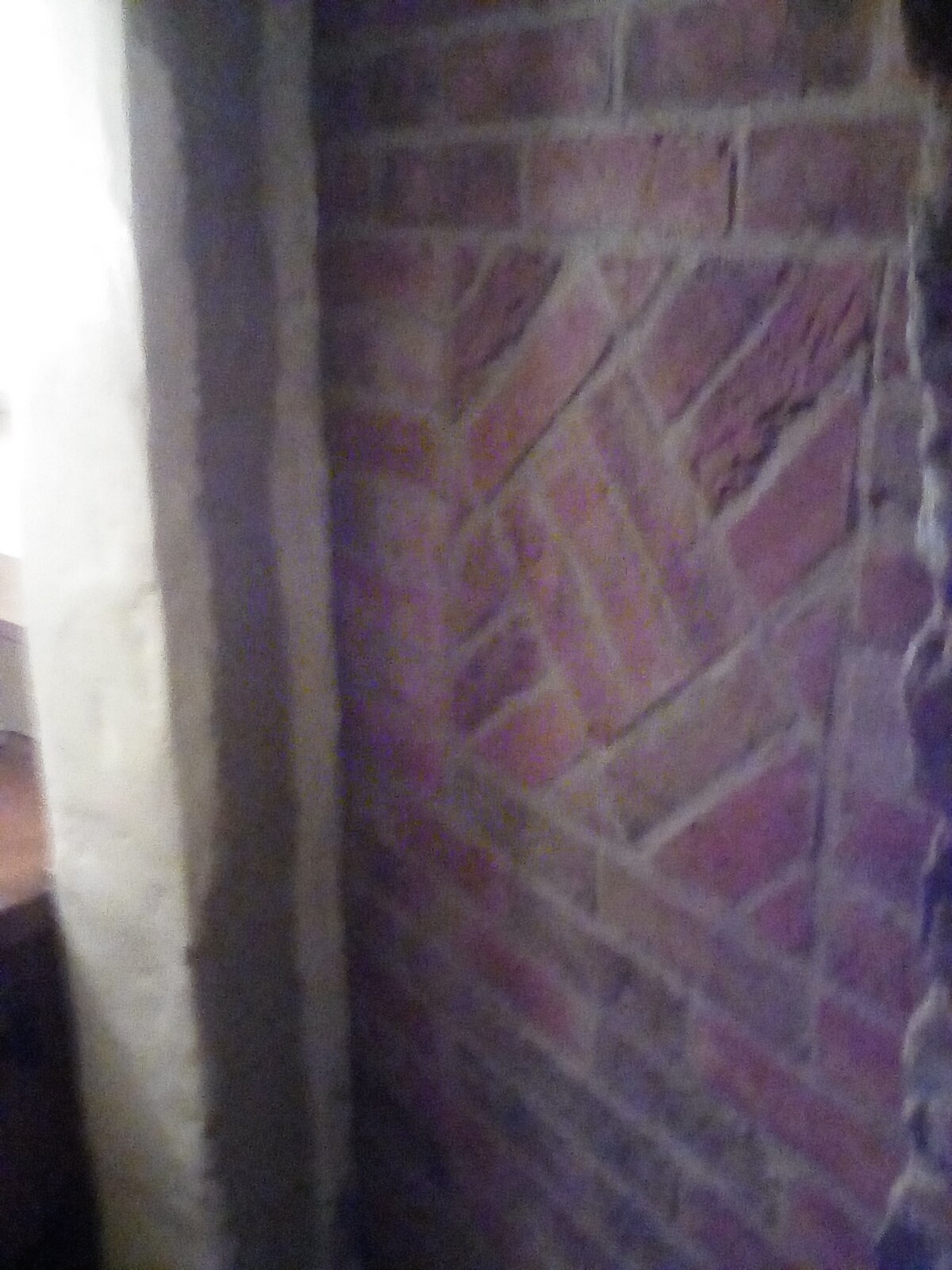

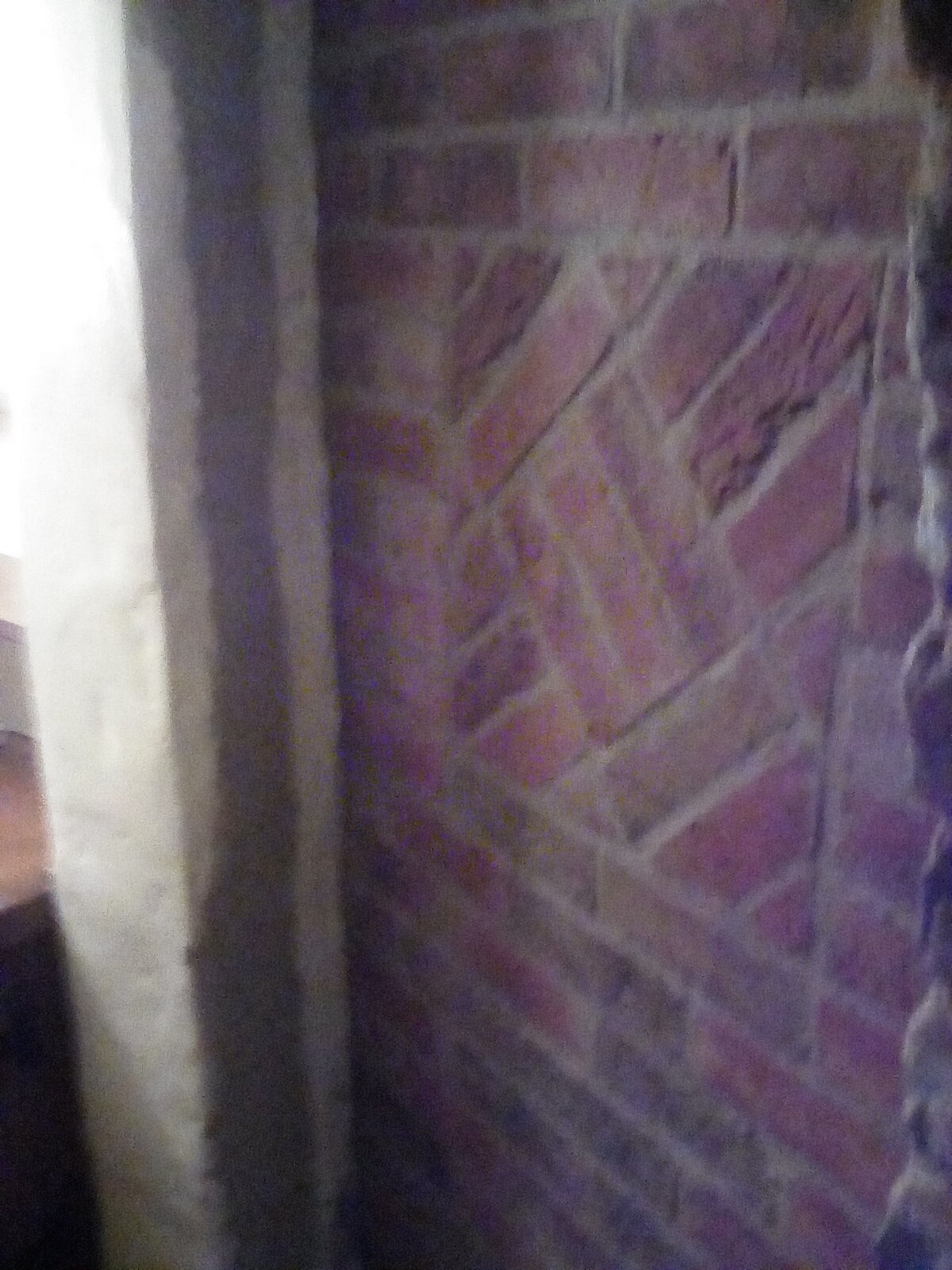

Did well with that stihl saw didn't he!?
My wife insisted I cut the bricks for him. Being soft hearted I tend to spoil the grand kids so I cut them for him. She wanted the basket weave panel, was really she should have made the cuts, but used the excuse that she's too tired after doing all the housework, ironing and cooking etc.
Always wise to be kind about support services that enable a smooth life; they probably soak up more than 40 hours a week :)
Genuinely impressed with the end result though!

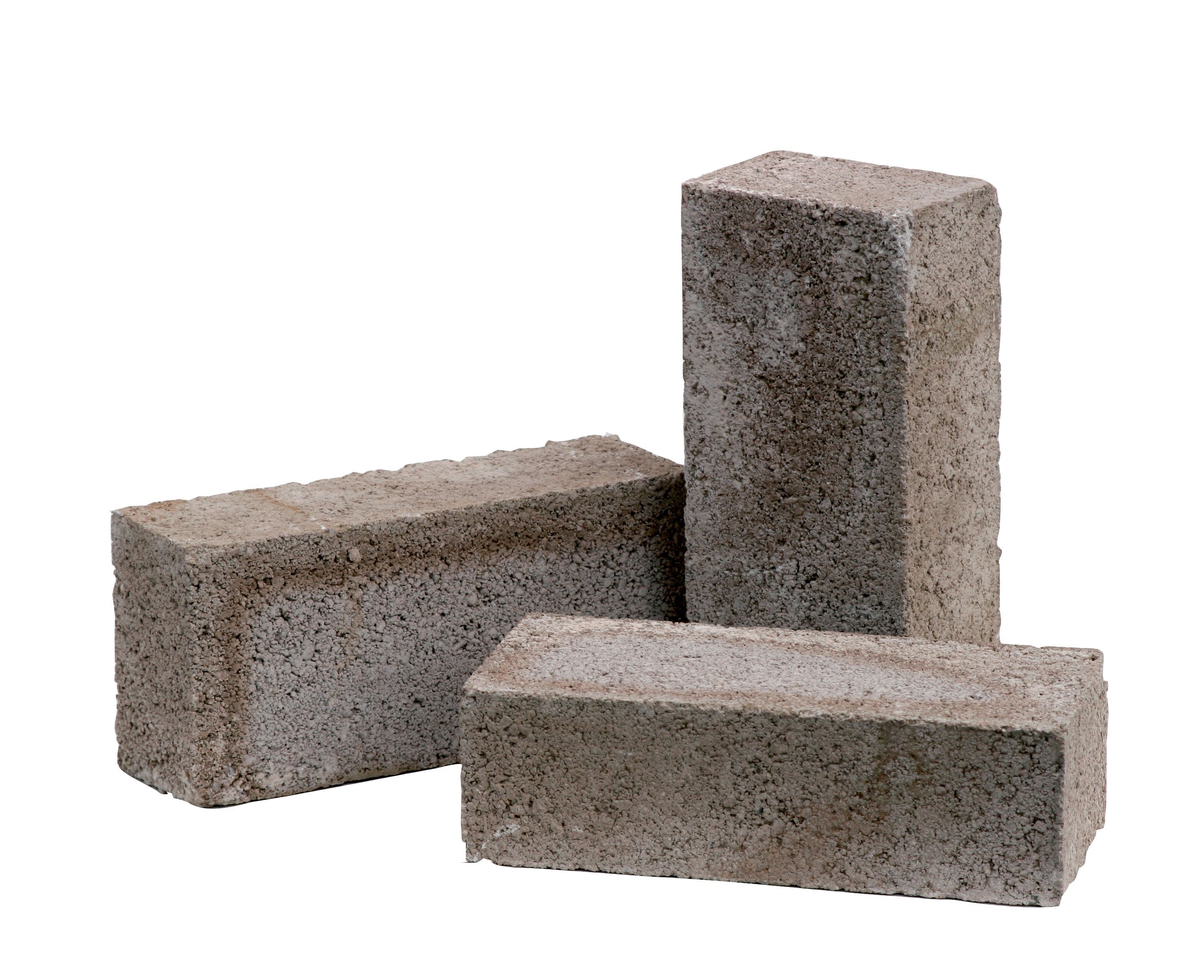

Absolutely anything will be 1000% better than timber and plasterboard! As you'll be trimming every other block to fit the width, I'd suggest getting some that can be sawn with a cheap or old wood saw.
Ensure you get a good bonding pattern. E.g. if you need almost two blocks on the first course then on the next course put a block in the centre and sawn pieces either side - don't just put the slightly trimmed block on alternate sides so you end up with a very slightly jagged line right down the centre.
Bricks can be used to fill in where you need a block plus a bit. The cheap concrete "common" bricks from B&Q are perfect for this.
