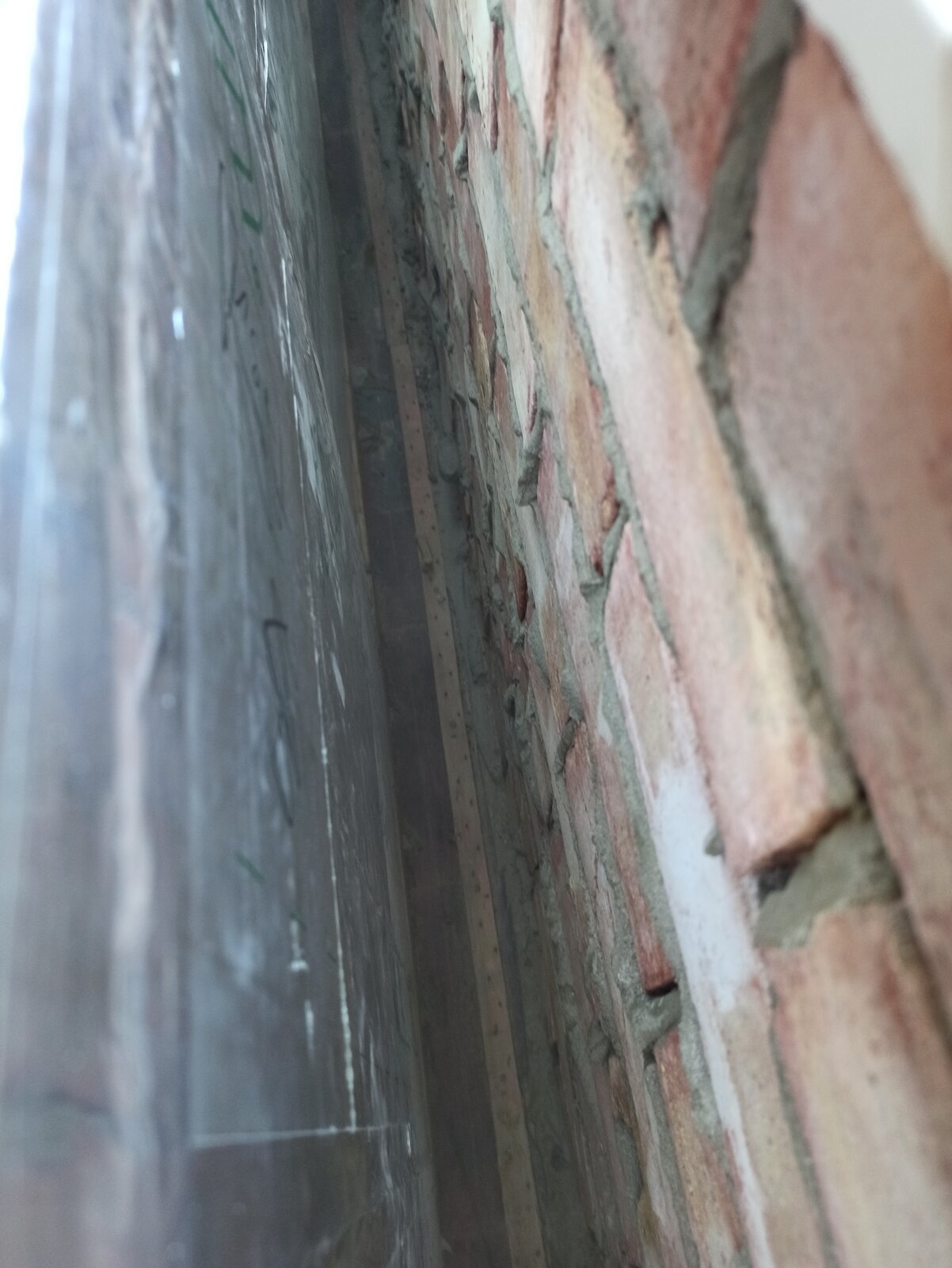

Hi all, Im going to be bricking up the bottom half of a full height window, A false wall was built inside the property years ago to cover this bottom half of the window so the bricks will be single skin toothed into the existing wall. With regards to rising damp we have a dpc. Im a little concerned over rain though and want to ensure we don't suffer with penetrative damp.
The existing false wall is 100mm away from were the new wall will sit. Am i best off leaving this as an open cavity and sealing this single skin of bricks with a liquid dpc or membrane with battens and cellotex/Kingspan or is there any better ways. Building a proper cavity wall would require ripping my living room to pieces and isn't an option right now.
Any help is appreciated here im a little lost which is best way to go

As the false wall is made of a wooden frame with regular plasterboard infront. Its not brick and it isnt a cavity as my floor screed is at the bottom. Were is there for water run off if the bricks turn into sponges from wind forced rain over the winter? This face of house does take a bit of a battering over winter time. This is my only worry about potential trapped moisture behind this brickwork.
Rising damp we won't have any issues with as the Dpc will do its job.
The insulation should be within the studwork of the timber wall, the cavity facing side lined with 9mm ply and breather membrane.. the new brickwork should be tied into studwork with frame fixings. Insert weep vents into brickwork to keep cavity dry.
Any advantage of 9mm ply and membrane over foil lined plasterboard? It's something iv seen often recommended
Foil lined plasterboard to room side, ply and membrane to cavity, the membrane protects the ply and stud from moisture.
Kingspan is in the stud wall, brick wall is up. Cavity bottom has an old carpet gripper in I forgot to remove. Cleaned up as much debris as I could.
Have I missed anything here or is this good to go?
