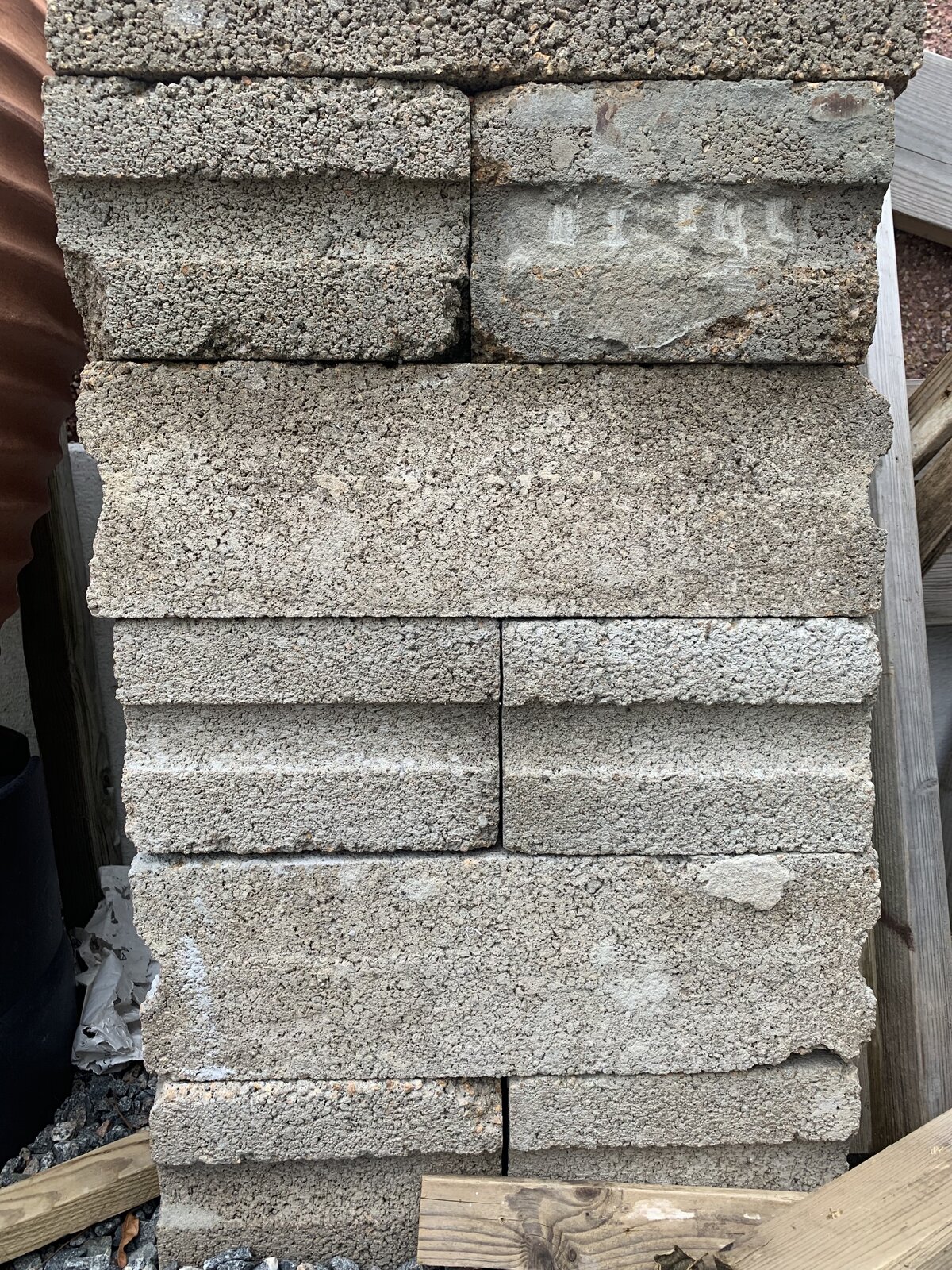

OK thanks. I may just go for the ones that are cost effective then. I had been told by a local builders merchant that dense concrete blocks used for B&B floor are different to ones used for wall construction.
There are special ones, which don't have frogs on the ends. Not sure it matters or not though!
Concrete blocks don't have frogs?
I always forget the term for blocks that have an indent at both ends..... thought it was frog, like a brick. Hopefully someone can tell me the correct term!
I've never seen a concrete block that's anything other than plain rectangular...
Oh... maybe it's something we just get in Jersey then!
All blocks are like this.....
