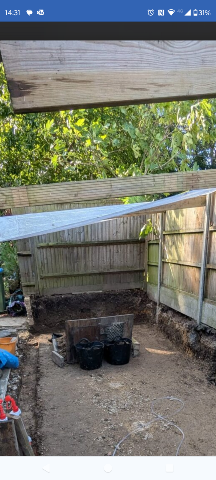

I am building my workshop out of 215mm x 100mm blocks.
I want to maximise my permitted development height allowance by adding 100-150mm extra wall height
100mm Concrete blocks are the usual 95mm wide.
100mm bricks are 103mm wide.
I don't want to cut all my blocks length wise.
I can't seem to source dolly blocks in Hampshire UK.
What options do I have for finding 100mm wide (but actually 95mm) blocks/bricks?
Ta

Your sub base looks about 3mm low in the back corner there. Keep that lack of precision up and you'll have the leaning tower of pisa on your lap by the time you're 4 courses up!

I'm measuring my final height from the pavement on the other side of the fence. 2.5m up. This gives me 100mm insulation on flat roof, and a ~2.5m ceiling height when I account for the joists.
Well, if I use full blocks it's 2.6m roof hight. If I loose a row it's 2.37m and my internal 2.5m ceiling drops under 2.4m
I don't want less than 2.4m because.... Principle :)
Will get the 10th course in and assess from there based on your replies. Cheers all!
