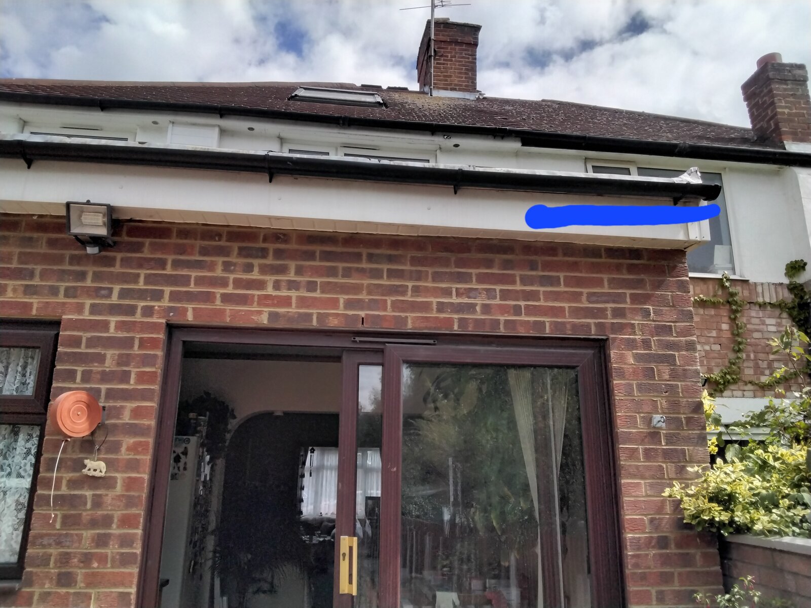

Wood under extension facia is rotten hence leakage right in corner as highlighted in the photo length approx under a metre
Do I replace the rotten part or entire length? Any guess on man hours? So can estimate cost thanking in advance for help

Remove all of it, and replace it with UPVC, you can buy it quite cheaply from eurocell, once done, it will last forever and never need painting. You also need to work out why the original got wet.

My bad the white you see is uPVC( plastic me old school) there is marine ply board beneath which is rotten I think gutter was
Not aligned properly hence rain water did the damage to the ply I may be wrong
Well, remove both, then refit the uPVC. if necessary make some plastic packers, to get the uPVC, and/or the gutter to where it ought to be to catch the water run off.

You can just see what looks like the line of the drip edge just behind & below the gutter - the drip edge should discharge over the gutter not behind it.
This means that there is no drip edge piece forcing the drip edge off the fascia.
You cannot leave rotting wood and a defective leaking corner - you will probably have to strip: wood, plastic and drip edge.
To remove all or any of the fascia & wood sub-fascia might anyway cause damage to the drip edge - same with the codged up raised edge.
Why not post pics showing what you expose after any stripping off? And pics looking down into the gutter and a pic showing the whole flat roof ?

OP eaves protection might be needed as well on your roofline.

Just a warning that facia comes in 2 thickness, what you have now 9mm for over boarding and a thicker one for fitting without the wood under. You will also no doubt need felt trays.
