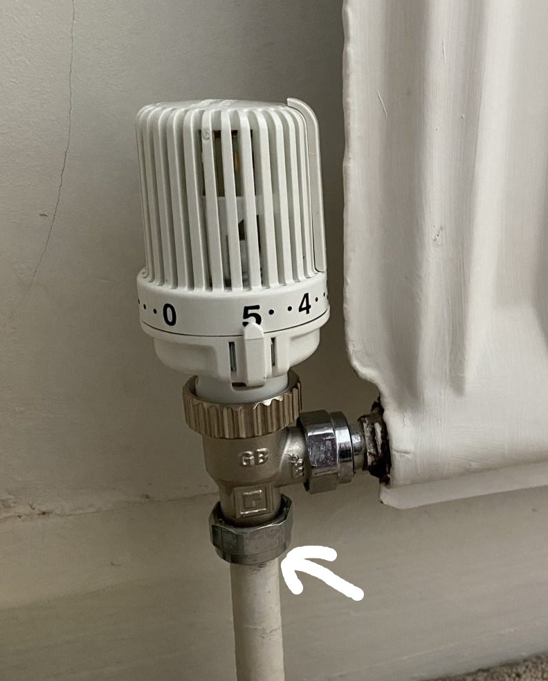

This is on the thermostat side where the feed enters the valve -so would need to drain to fix permanently/loosen nut etc. It is in an old hall where I work - so CH system is massive. Plumber is coming out to do a full service and fix this leak on Monday. We knew we had a very slight leak a few weeks ago, just weeping very slightly when cold.
However over the holidays the heating was off (just frost protection on) and since we turned it back on a few days ago and it got hot the leak got quite a bit worse, and now it it is leaking quite badly even when it is cold. I topped up the pressure just before the holidays and I have had to top it up a day or so ago and it looks like I will have to do it again tomorrow.
We have tried with the radiator turned off at the thermostat and it doesn't seem to make a difference -but difficult to tell. So first which is likely to be best to slow the leak - radiator on or off?
Secondly could I use plumbers mait or denso tape (I have both!) or? just to slow it down until plumber comes. I did try and nip it up but it seems quite tight anyway and I don't want to risk a disaster...I don't want to use epoxy resin as the plumber will do a 'proper' fix and I don't want to make it more difficult for him.

If tightening the joint where the supply pipe enters the valve doesn't stop the leak ,it will need taking apart to sort it out.
Plumbers mait is wholly useless for using as you suggest ,as is denso tape.
A picture of the joint may be helpful.

I can't post an image of the pipe just now (not at work) - I don't know if this helps but this image off the web is similar - with the white arrow showing where it is leaking from. (I was going to post one of my rads but I have microbore but like this image the ones in the hall are 15mm feeds)
It is definitely coming from the lower side of the nut, running down the feed pipe.

I have but I think it is tight enough - I put quite a bit of force onto it and it didn't move - I'm really wary of overdoing it and ending up making it worse/getting a flood.
I did think I could try loosening it a bit and then tightening it back, just in case it i didn't move because it is a bit seized anyway, I'm guessing it hasn't been touched for many many years....

Standard 15mm compression. As it's below the valve I'd switch your boiler off (and pump if it's not integral to the boiler), chances are you can loosen the compression locknut without draining the system to drop the pressure, and wrap 4 or 5 turns of PTFE tape around the olive, or smear some jointing compound around it, like boss universal. Don't overtighten it.
If when you loosen the locknut water starts sperting out at pressure then you'll have to drain the system before you do the above.

I changed a TRV valve a few months ago, I just switched off the boiler and pump, drained the system a little bit to release a bit of pressure, then replaced the valve. The system water won't all run out when you undo the valve locknut if it's unvented, same as when you fill a straw with water then keep your finger on the top.

If the pressure is not too high, you could try self-amalgamating tape, usually sold in electrical type outlets. It's like a stretchy rubber tape, which sticks and amalgamates to itself. You would need to stretch it tight, whist wrapping it round the pipe, building up the level, to the size of the nut, then continue wrapping up over the nut.

Well - It has a much better chance of slowing the leak, than either PTFE tape, or Plumbers Mait plastered around it.
