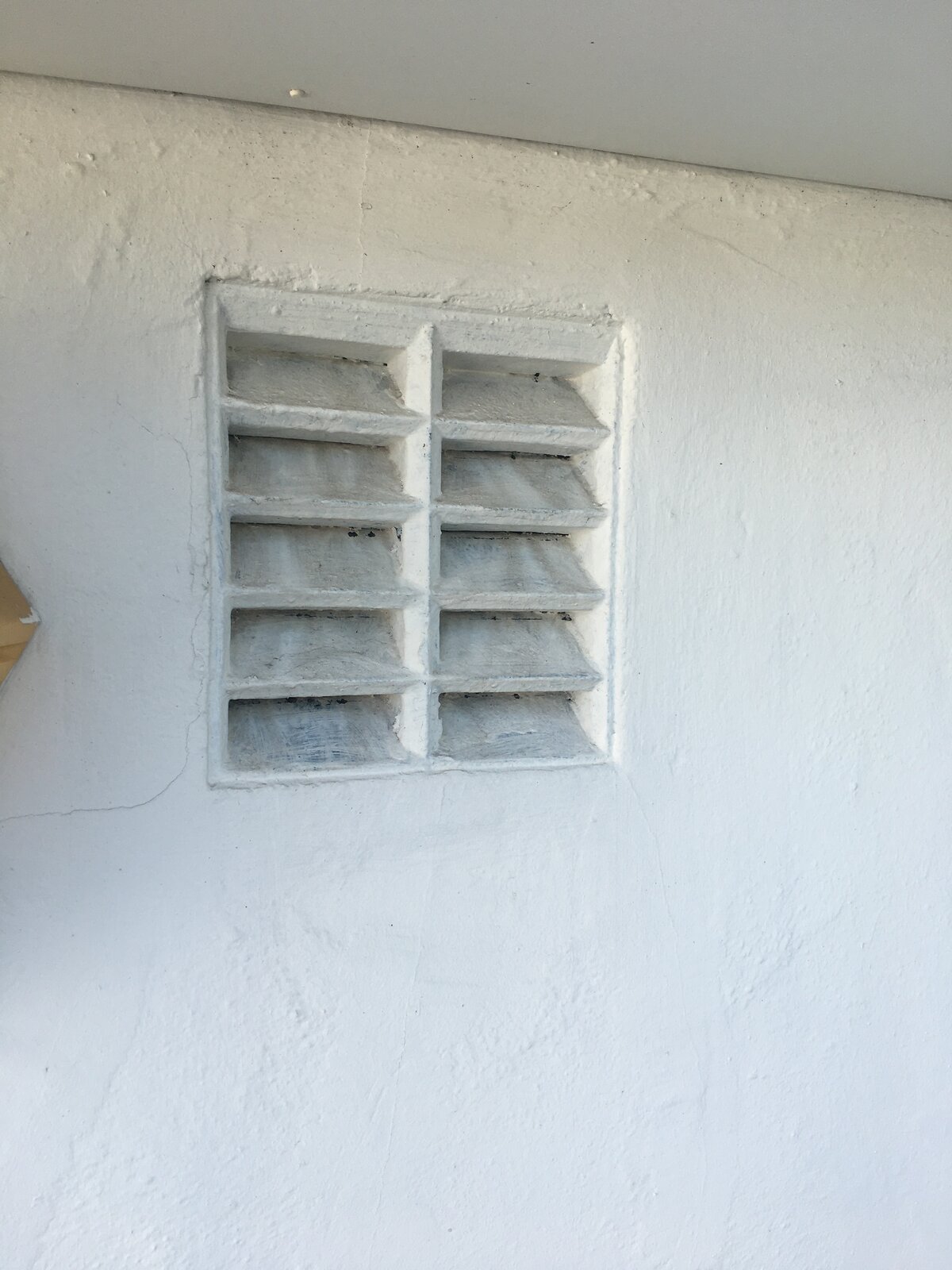

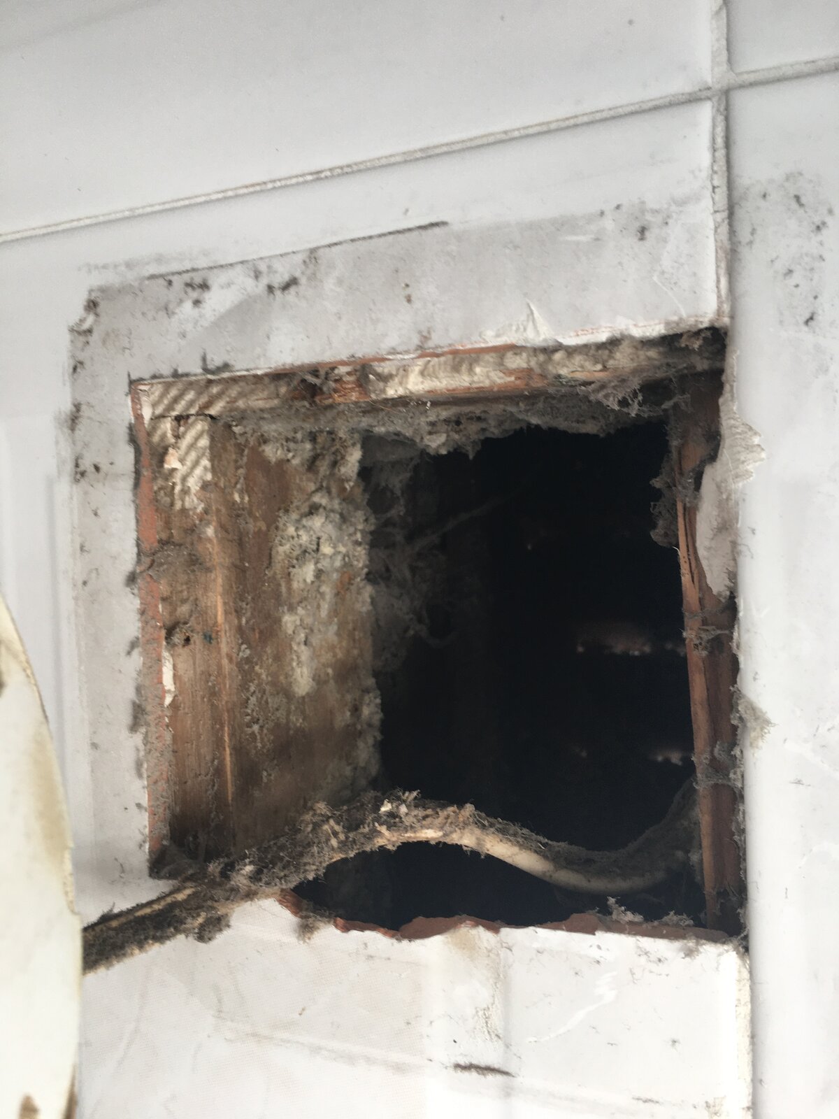

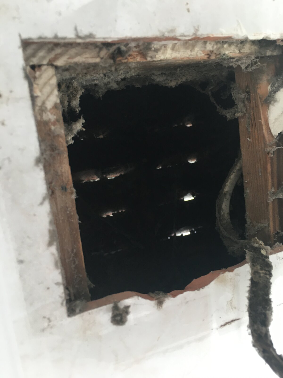

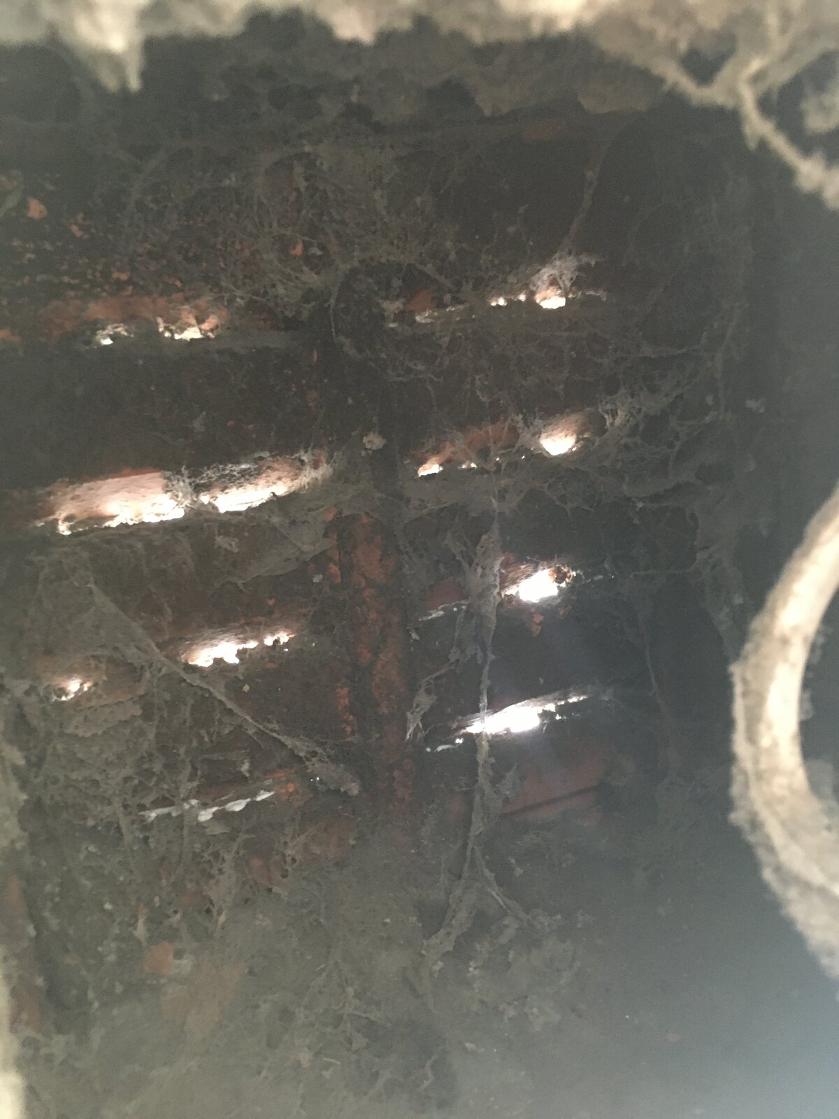

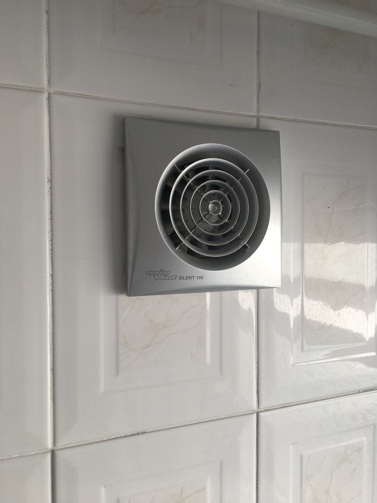

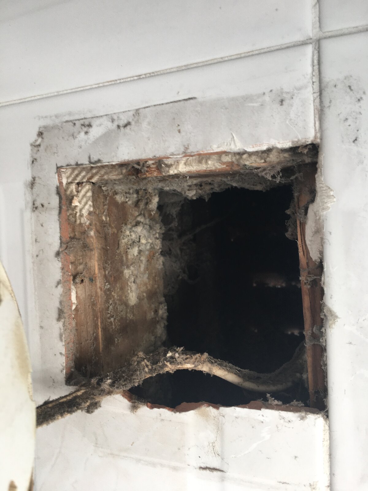

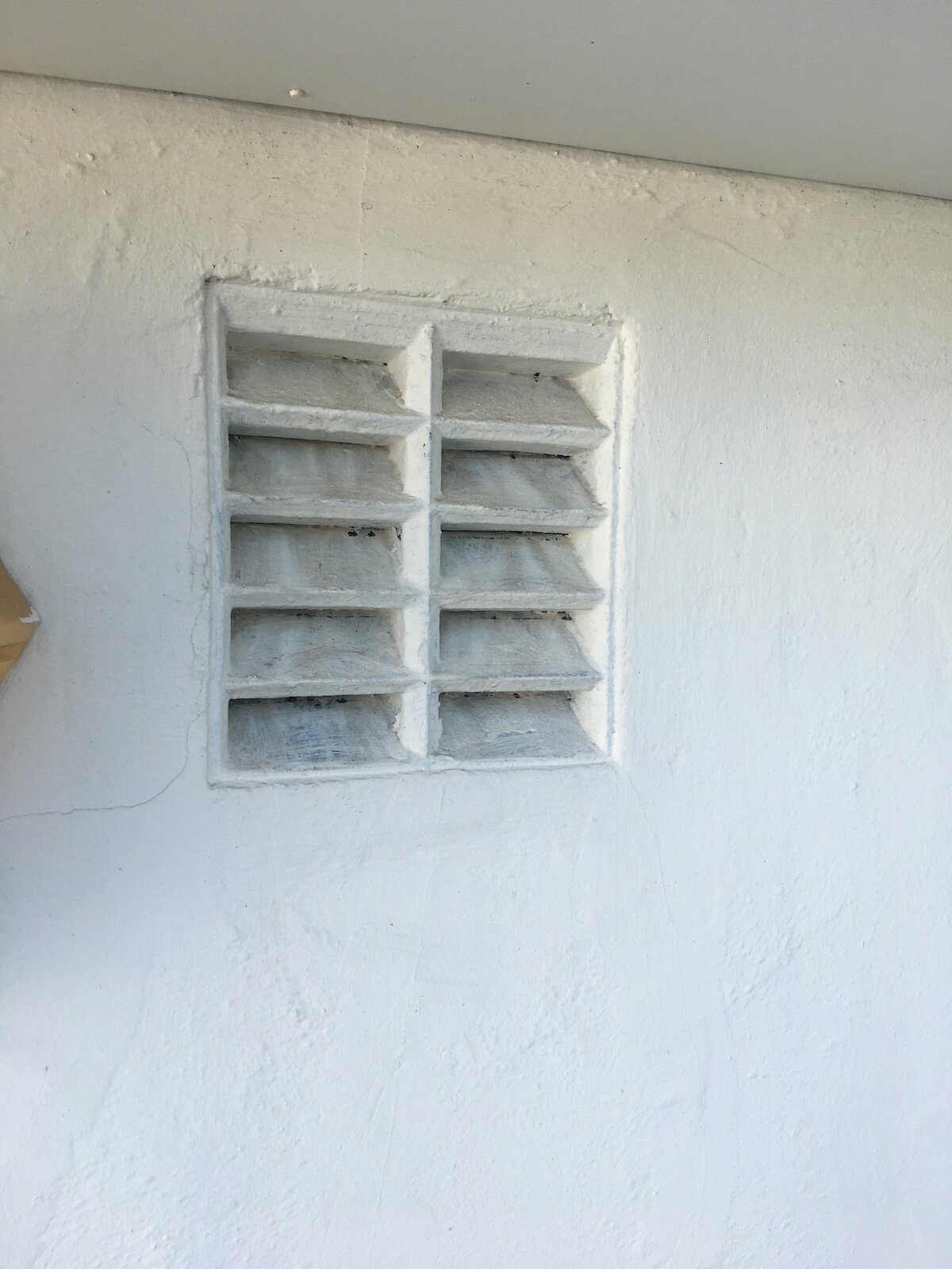

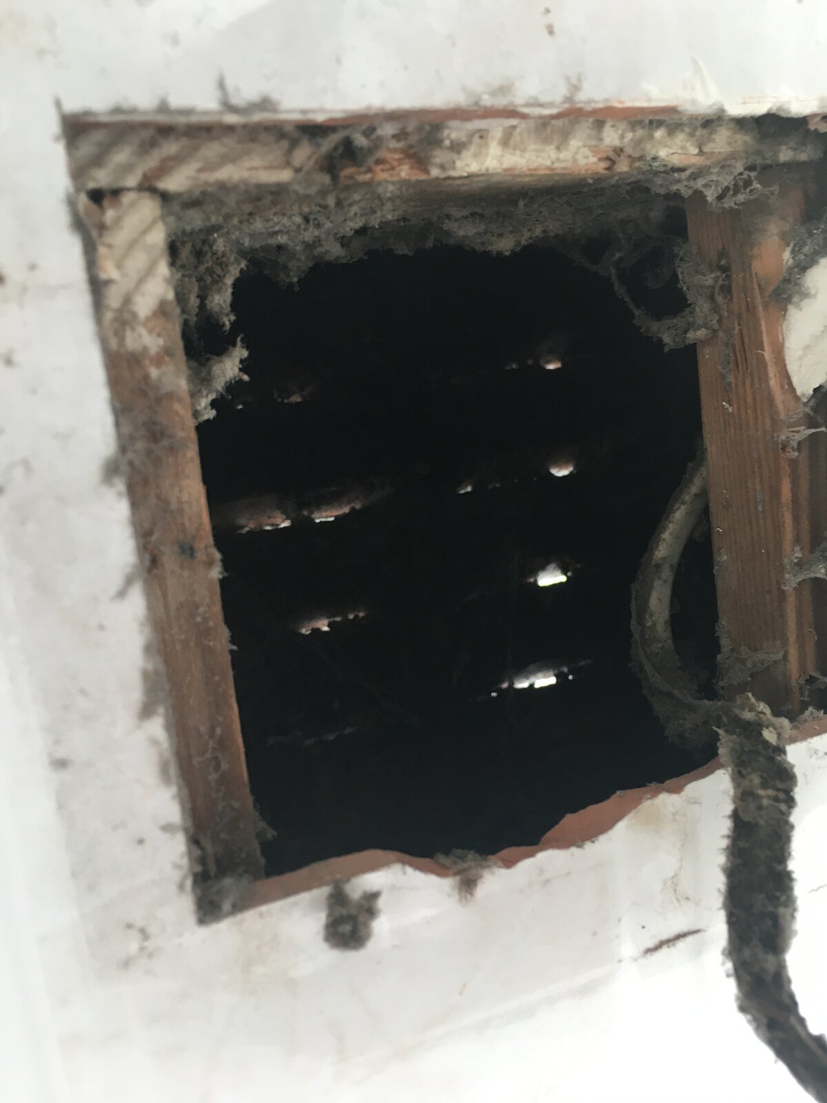

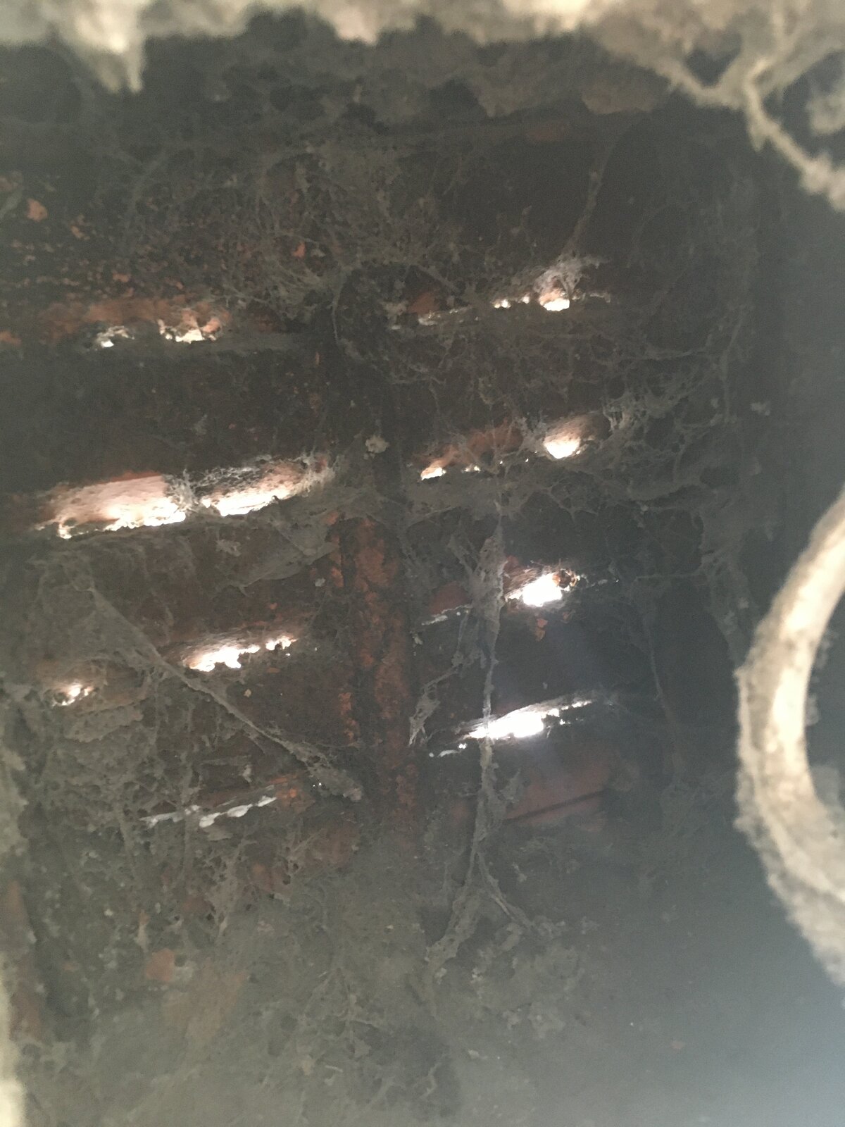

Hi everyone the previous owner of my house installed a bodged extractor fan how do I install a new one correctly, the current fan works but is not screwed into the tiles on the inside of bathroom and it seems to push air into a cavity in the bricks there is no tube, also the outside is an air Rick not the proper extractor fan flaps? Any help would be much appreciated thanks
View attachment 223412 View attachment 223413 View attachment 223414 View attachment 223415 View attachment 223420 Hi everyone the previous owner of my house installed a bodged extractor fan how do I install a new one correctly, the current fan works but is not screwed into the tiles on the inside of bathroom and it seems to push air into a cavity in the bricks there is no tube, also the outside is an air Rick not the proper extractor fan flaps? Any help would be much appreciated thanks
That was installed in a one time air-vent. They are usually lined with thin strips of wood, to isolate the vent from the cavity, but it looks as if they may have been taken out/broken.
