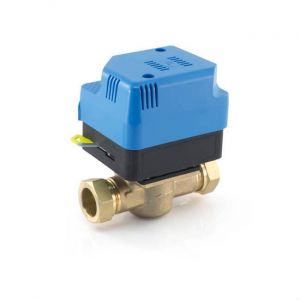

Thanks, that sounds like it might be a possibility. Having a look at all the obviously new work around the boiler there is a blue cube about 3in. Square with a small metal lever on the side which moves when the boiler switches on, whether it is via the timer for the old CH system, hot water or the new UFH system. Strangely it doesn’t seem obviously electrically connected to the boiler itself but it is certainly a motorised valve. It sounds like this should be the starting point when I call an engineer out.
If it's something like this:
Then the thermostat will open / close the valve and the grey and orange wires from the motorised valve are what control the boiler.
