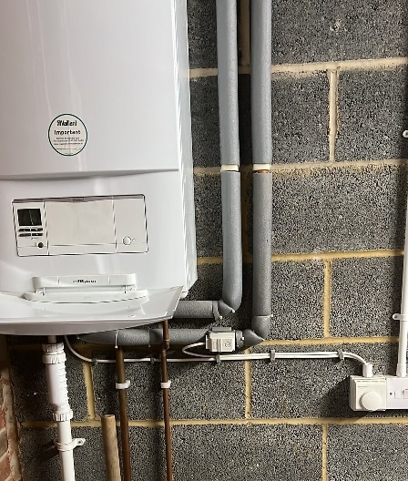

Here's a Pic of a pipe stat on the boiler return from a post earlier this week. The frost stat is indoors here though. :giggle:
Cool - thanks... no evidence of a pipe stat at all in the system... which would explain the continuous firing of the boiler when the externally mounted frost stat kicks in. I've confirmed there are no external pipe runs, so I've disconnected the external stat & will let the Hive system's frost protection take over (although as the wife has flu, I'm not going to drop the temp to 7 to test it right now...)... everything else is behaving right now...

This is the weird thing - its not in an unheated room - its a boot room next to the kitchen, where we have an Aga that is always on, so pretty much the warmest room in the house - plus there is no pipe stat at all, hence the boiler firing but not turning off until the outside temp triggers the frost stat to switch off - its like someone forgot to put the pipe stat into the system (if that was what they were aiming for).
