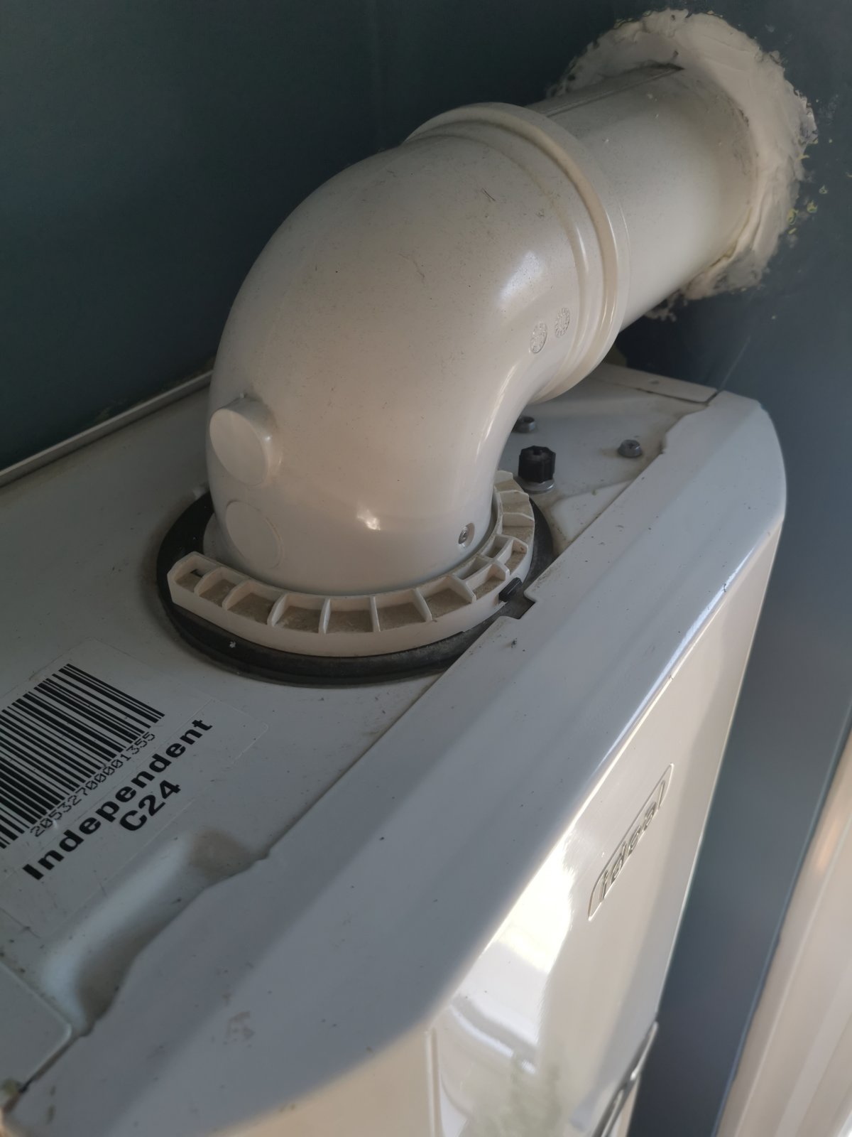

I had an engineer come round to re-pressurise the expansion vessel fairly recently, as the CH pressure kept rising drastically; causing the PRV to activate. He fixed this issue but said that the boiler was not technically serviceable due to a lack of inspection point on the flue elbow.

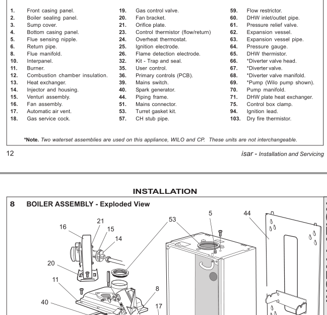

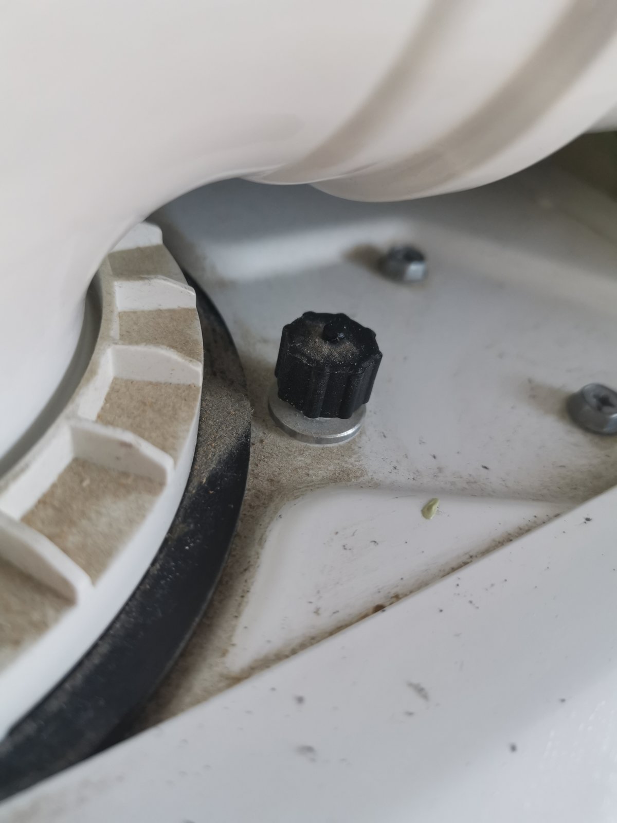

The boiler is an Ideal Independent C24 and going through the manual I cannot seem to find anything on this kind of inspection point. I have read about probes being used from outside but access is an issue. I have attached a couple of photos of the top of the boiler - I am wondering if the small black screw cap has anything to do with this.

If the engineer didn’t know, he should have contacted Ideal technical for assistance, they would have told him how to sample to flue, or asked on here in the gas forum.
Regards the inhibitor, it all depends how much you have been losing and topping up. If only a week, I’d say it’s fine, if a week or more I’d go with adding inhibitor - certainly wouldn’t do it any harm.
Boiler servicing is one for the Gas Engineers, I cant see a test point on the flue where it should normally be located, but there may be other methods of doing the required checks. The black cap is unlikely (in my view) to be a test point, possibly an air vent.

The black cap is the sampling point , not a flue inspection as you called it, it is how with a Flue gas analyser you can test how the boiler is burning, nowt to do with inspecting the flue, your install is fine, adding another litre of inhibitor will not do any harm but if you can, use the same brand as is already in there , not always a good idea to mix them
