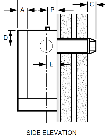

We have a Gloworm Ultimate boiler circa 20 years old with the flue straight through the wall per the installation instructions:
The problem is that the flue runs downhill slightly between the outside and inside of the wall. Ordinarily this is not a problem but with the wind in the wrong direction rain will blow down the flue and run down the wall causing the RCD to trip as the water gets into the FCU for the boiler.
Is it possible to change the straight flue for a snorkel? I have seen some houses close to me where the boiler has been changed and a snorkel fitted to get the flue away from the side door
Is your boiler condensing? If not then you can’t have one fitted. If it’s condensing, then I’m assuming you mean a plume management kit as opposed to a snorkel? It depends if you can still get a new flue for your boiler, which is likely to have one fitted. Is the flue sealed to both sides of the fabric of the building? Does it have a weather seal?

Is there anything that could be used to prevent rain ingress - something to shield the flue without causing problems?
Ours' has a 'hood' over the top of the exit point out the wall. By that, I mean the pipe exits the wall and has a shroud or hood type surround over the top so that no driving rain can enter the pipe. Has worked that way since 2012 and was put in specifically to stop rain ingress as it was a problem before.
You might be able to fit a weather shield, if it’s not sealed by mortar or equivalent then it will get in.
That's exactly what I've suggested too. Since found out there's a brand who make them called "Weathersnug".
