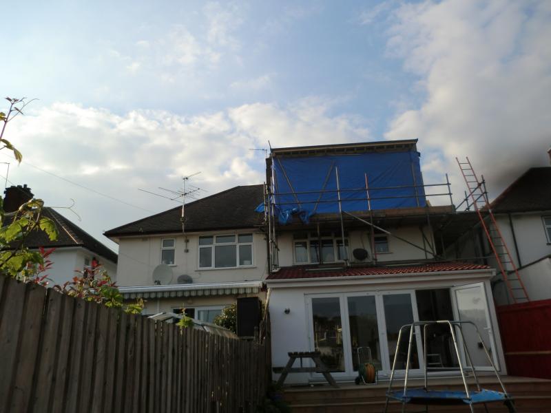

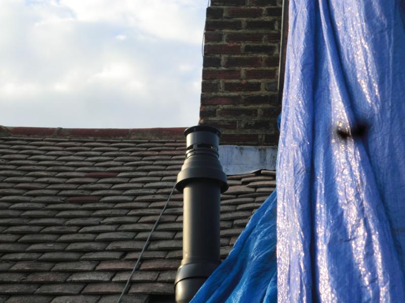

Sorry for the delay, I was out enjoying the weather. I have taken a couple of pictures. a close up and then one from afar, which may not show you much due to the scaffolding. Thanks again...
An interesting situation, not AFAIK clearly covered by the standard diagrams illustrating permitted and non-permitted flue termination positions.
there are two issues: products of combustion entering your property (through the dormer window) and the proximity to the new dormer cheek interfering with the combustion performance of your neighbours boiler.
I don't think either will be a problem.
I believe 600mm is the standard clearance from a vertical balanced flue terminal to a velux window horizontally adjacent: it looks like there is 600mm to your window.
I don't think that your neighbours boiler with a fanned-draught balanced flue with air intake and fume output so close together will be affected by any pressure fluctuations caused by wind turbulence in the proximity of the dormer cheek. And if it did, its your neighbour's problem, not yours. His plumber should not have sited the flue so close to the boundary line where there was a possibility, albeit remote and scarcely forseeable, of a structure being built there.
I'm willing to be corrected if others disagree.
There are three dimensions to be complied with.
The distance of 300 mm away from the boundary, this is usually taken to be to the centre line of the party wall and the nearest part of the flue. That is probably achieved.
Most of those flues need 600 mm from any wall, that might not be achieved but is only a problem for the boiler user.
Then the distance from a velux window. I thought that was 1200 mm ?? Probably not relevant in this case.
Regardless, products of combustion should not be able to enter your new windows!

First time I have seen scaffolding supported on a roof like that. Makes me wonder what prevents it slipping down the slope!

Looks like a baxi flue terminal and they only ask for 300mm from terminal to an adjacent wall
If the flue was there before you started building your extension/dormer then it is up to you to ensure that the dormer is the required distance away from the flue, or you will cause a contravention of the boiler's installation instructions and will most likely invalidate the warranty. Imagine the situation - your neighbour has an in-warranty breakdown, the manufacturer's engineers come out and blame the failure on the flue's proximity to your dormer. Your neighbour would have a very good case for claiming the cost of the boiler repairs off you. You could, of course, ask your neighbour if they would be prepared to have the flue altered at your expense so that it is not too close to the dormer

Where does your dormer rise up compared with the centre line of the party wall?
If the flue is more than 600 mm from the flue there should be no problem.
I am not convinced that your neighbour could legally sterilise development on your property because of the location of his flue. Although paying for it to be relocated might be required.
