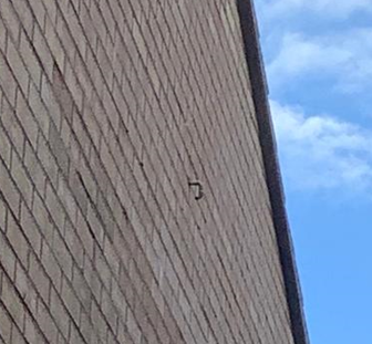

UPDATE: The neighbour has now had the flue moved and taken down the scaffolding so we can see the new wall without obstruction. To our amazement the neighbour has still left a small copper pipe that bends back on itself protruding from the wall over the boundary. I am told this is most likely a vent for a pressure relief valve for the boiler. See picture.
Why would they think leaving that pipe over our property will be accepted when the flue wasn't!! :mad:
Does anyone know if a boiler pressure relief valve vent is allowed to vent like this (on to others property) under building or Gas Safe regs? We have asked the building inspector but not had a response to date and have arranged to meet the neighbour on Monday.

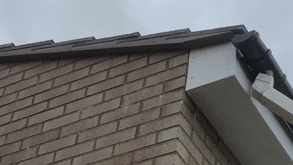

We have also noticed the roof of the two storey side extension and now the single storey rear extension protrude 3 inches over the boundary on to our side. This is visible now the scaffold is down and the tiles are on. See the following picture. I assume this is also not permitted as the brick wall is the edge of the boundary and everything this side of the brick is our property?
I'm not a builder but, I think technically/legally nothing whatsoever is supposed to breach the boundary line. This includes things such as downspouts, gutters, vents etc
I think you right about the pipe being a PRV and, even though it appears to breach the line, it is doubled back to disperse against their wall. Not sure how much of an issue this is for you, especially as it seems to be quite high up. As you say, if you build an extension then it may be in the way and have to be moved at a future date anyway.
As above, if the wall is the boundary then nothing should overhang. How can you prove that though? If you are 50mm off then the neighbour may be ok.
The flue would have constantly vented a visible plume over your property and needed to be moved. It should not have been there and the neighbours have moved it to comply. The pressure relief pipe may never discharge and if it does, it will probably only drip down their wall. The roof tiles overhang by 3" way above head height. Is that a big deal? Are you always going to look up at that wall and feel offended? Probably says more about you.
