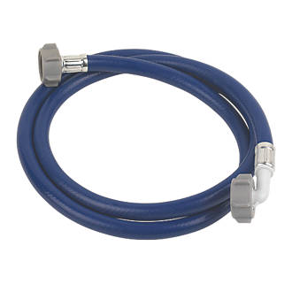

I didn’t fit isolation valves on mine - I heard they could restrict flow and couldn’t really see the point of them unless you wanted to remove the whole filter unit without draining the system down. In my case, my filter is fitted next to the boiler which is in the loft, about a foot away from the highest point in the system should I ever need to remove the whole filter. Making sure the boiler is switched off, I just remove the magnet from the top to allow any metal particles to sink to the bottom, place a container underneath the unit and undo the valve. Being a sealed system, a quick blast is all that's needed to clear it out. I think the installation looks neat enough to me but it does look a bit tight to drain on your relatives one but after removing the cap on the bottom, couldn't you fit an angled washing machine hose onto it and drain it into a container? One of these:
Thanks, that's a good idea for sure.
