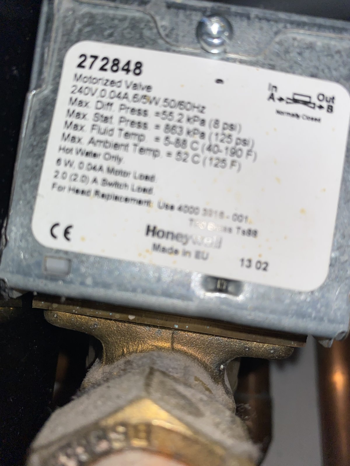

So that leave me with the Honeywell valves. Is there anyway to find out which of the 3 are causing the issue without disconnecting the wiring.

You could isolate the unit and test the resistance between earth, and the live+neutral wires of each valve.
Ideally you would use an insulation resistance tester but a multimeter might be able to pick up the problem.
You would still have to disconnect the live and neutral otherwise you'd get a false reading as you'd be testing all the neutrals at the same time. And in turn, the lives.
The alternative is known as the "bang test" and you just switch it on and see if the protective device operates.
Yes another option is to remove the casing and look which one is in worst condition. I believe you can just remove the electrical head alone and leave the valve in place.
slacken that small screw at the top of the valve cover(with power switched off) and remove the covers , see if you can see any water ingress in any of the valves, or smell any burning smell in any
