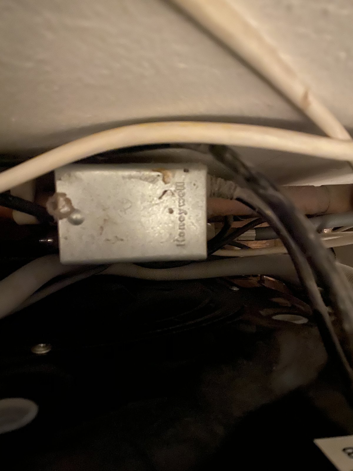

Bad news , the boiler has been leaking for sometime and needs a new part a silver rectangle box at the mid left of the boiler, not sure what it's called. It will take a few days before it arrives.

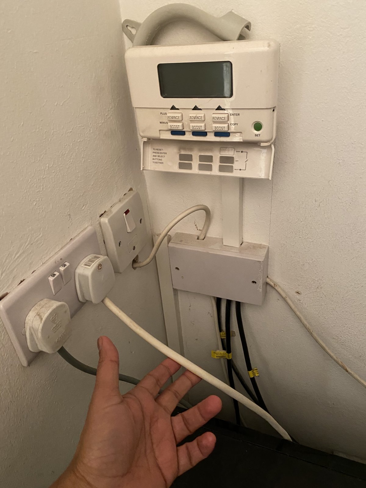

The ugly, something else is tripping the electricity thats on the fused spur that supplies the boiler, the engineer has ruled out everything bar the horseman, and the values that connect to the horseman. unfortunately as the engineer had been on the job longer his manager had decided to make an excuse of messy wiring being the issue, so rather than diagnose the underlying issue they recommended a rewire of the junction box. His manager didn't know I could hear everything on the phone.

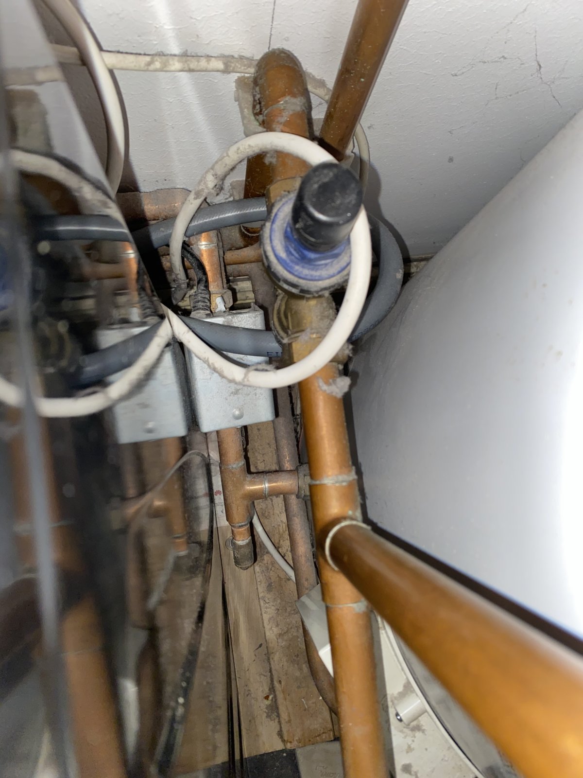

I was planning on tracing each of the cables for the values and the horseman back to the junction box and disconnecting one at a time to isolate the issue? is this is a good idea?
BTW does anyone know how to remove the horseman, I've added a picture on
Picture of the Honeywell valves and horseman.
the three black cables that are hanging down from the junction box connect to the Honeywell values.

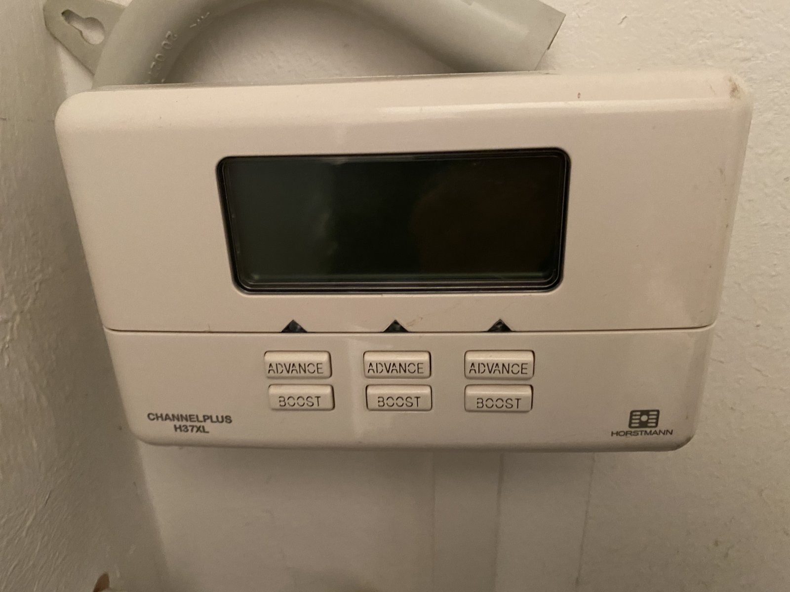

Push him off, it would be very unusual for the Horstmann programmer to be tripping the RCD but is possible which Horstmann do you have ? post a pic
Im pushing and pulling but it doesn’t want to come off. Is there a technique?

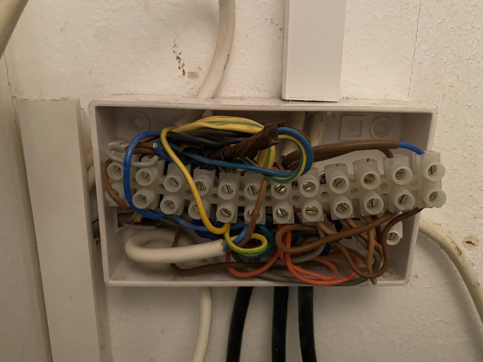

This is the mess that was left by the previous installer.
That's a home-made job. Almost adequate but untidy. A proper "wiring centre" as sold in the heating trade is just a fancy version of the same, but neatly laid out, and often includes labels and/or cable clamps/stress reliefs. Often 12-way or 16-way. Boilers are usually fused at 5A or 6A so you don't need big terminals.
I sometimes use them when I have a complicated wiring to lay out.
You can often get them on fleabay at low prices.
I'll look for an example pic.
edit here are some
example ad https://www.ebay.co.uk/itm/Drayton1...633703?hash=item56cffcb967:g:WsAAAOSwbv9d3sjJ

As a side possibility to your issue "something else is tripping the electricity that is on the fused spur that supplies the boiler" >>>>
Some years back my boiler kept tripping my RCD.
I spent months of looking for solutions, and having engineers change items.
It was then pointed out that the mains cable going to the boiler was now touching a hot water pipe (in my case the pipe feeding the radiators).
It was explained to me that when the radiators came on, they were heating one side of the cable more than the other side.
This was lowering the resistance of one of the cables inside (say the Live Phase) more than the other (say the Neutral Phase).
This was seen by the RCD as a imbalance in the residual current and tripped my RCD.
Quick solution was to put cloth between cable and hot pipe to test this issue and it instantly solved the problem for me.
I only highlight this possible solution as in your pictures I see some cables resting on pipes.
