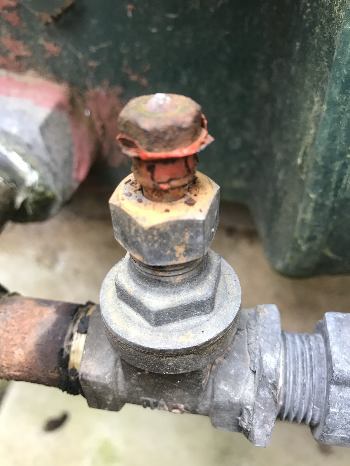

Long story short I replaced my broken oil tank monitor a number of months ago with a smart monitor provided by a popular oil broker. The meter has not been reporting accurate levels so they sent an engineer to measure and get details of the tank to ensure the monitor is calibrated correctly.
The engineer turns up, has a moan that he can't remove the monitor as its been glued on (not true!) and that the tank installation is dangerous as its not supported across its base and when my wife explained that its been like that for a long time he decided to counter that by telling her its clearly been done recently. Well I can tell you now that it was installed around 24 years ago and is fully supported across the entire of the base.
Anyway thinking no more of it we woke up to a colder than normal house and went to run the shower and to our surprise the water was cold. Going to have a look at the boiler the heating and hot water was set to be running on the controller and the pump was circulating nicely but the boiler was dead. Looking behind the front panel and to my surprise the lockout button had popped. I pressed this and the boiler fired but the flow pipe was only getting slightly warm. A couple of mins later the boiler shut down again. I went outside to have a look at the tank and specifically at the oil tank shut off valve and to my surprise while this was not closed it was not fully open either and was very very easy to turn despite the red handle on the top of the valve having long fallen off I could turn this freely by holding the stem. I opened this fully and then nipped it back a fraction. It is without doubt in my mind that the engineer that came out to simply measure a tank and its oil level shut off the oil to my boiler and starved it. It would have certainly been running at the time as our hot water is on continuously and this was not long after the mid morning rush.

This valve on the tank outlet......did it originally have a red circular wheel to turn it - called a gate valve? For sure, I've never been able to turn the valve stem by hand and I think your first investigation should be to find out if the valve is actually passing kerosine.
Be careful what you undo though, you don't want an oil flood!
At the same time, it's worth checking the filter bowl that should also be there for sediment or water within.
John :)

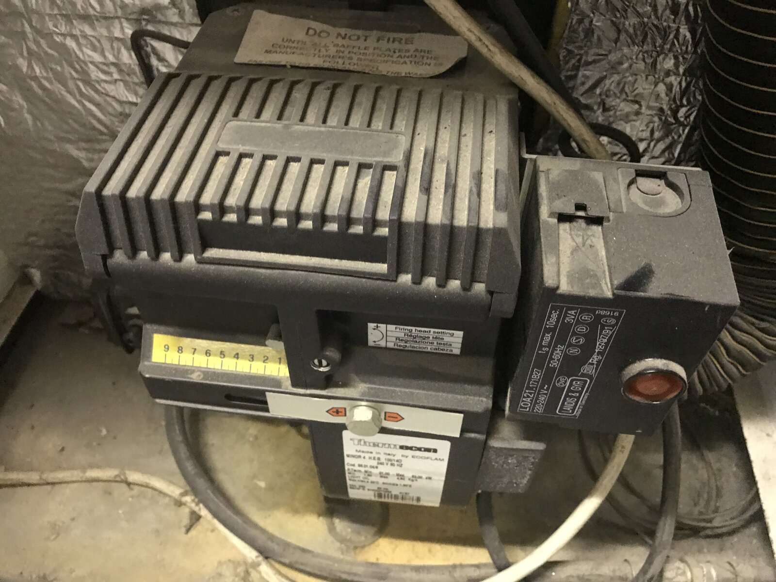

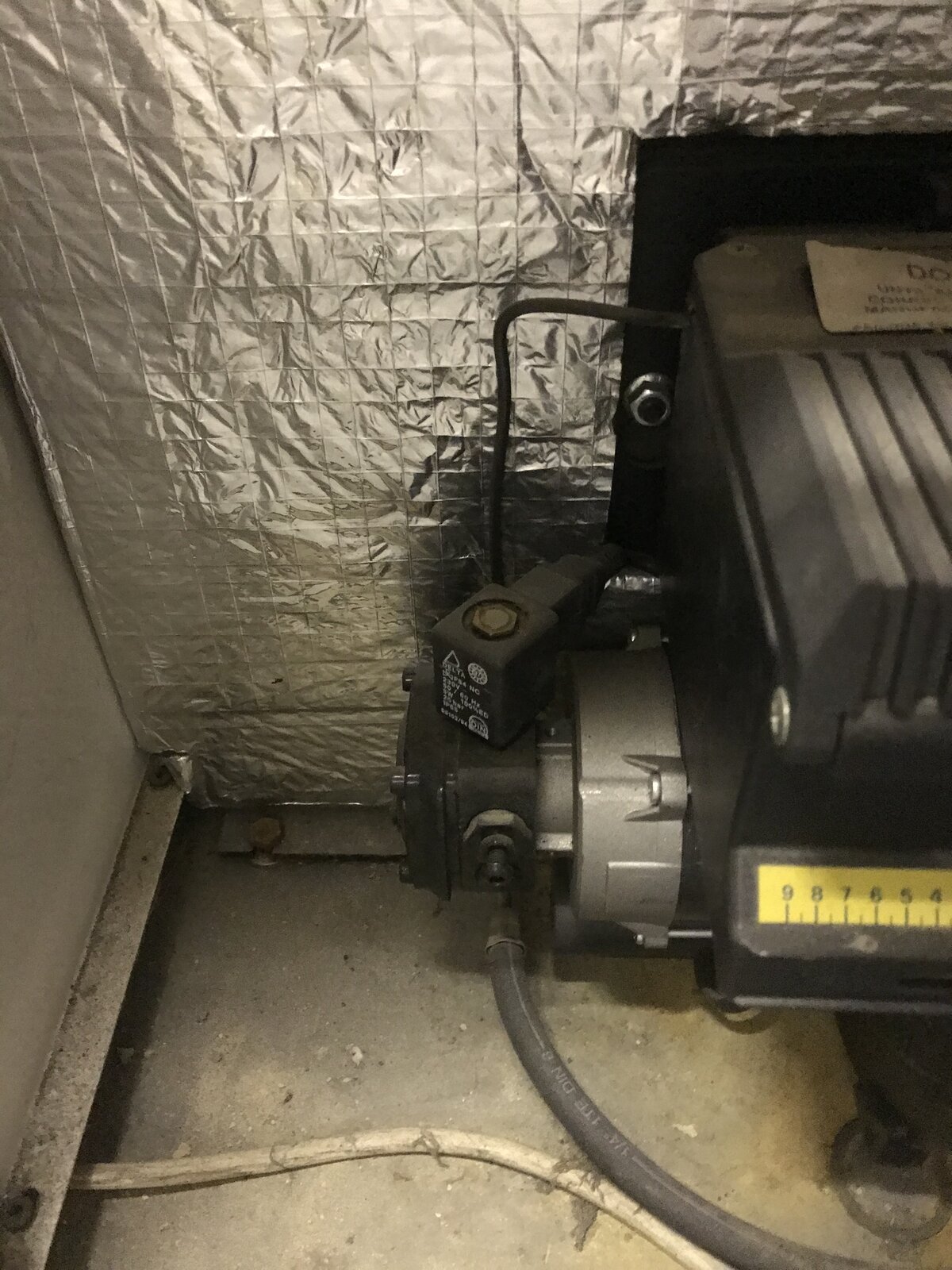

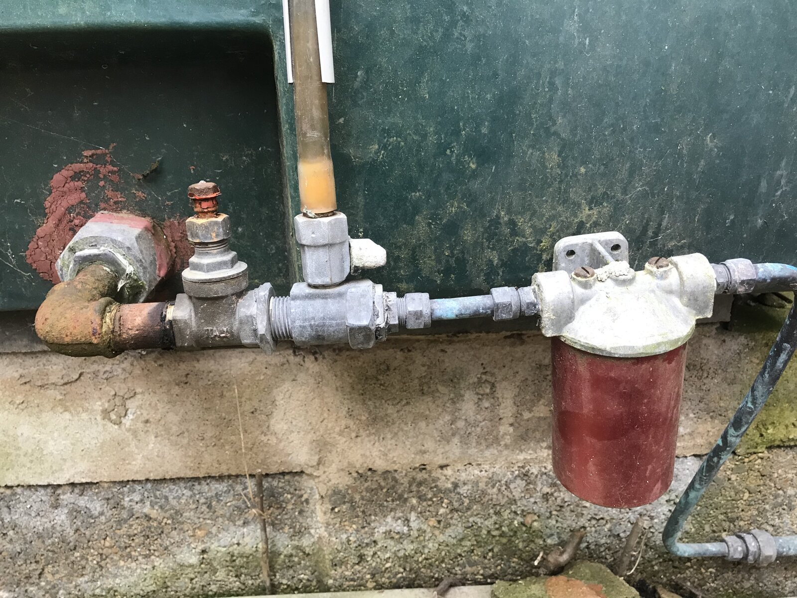

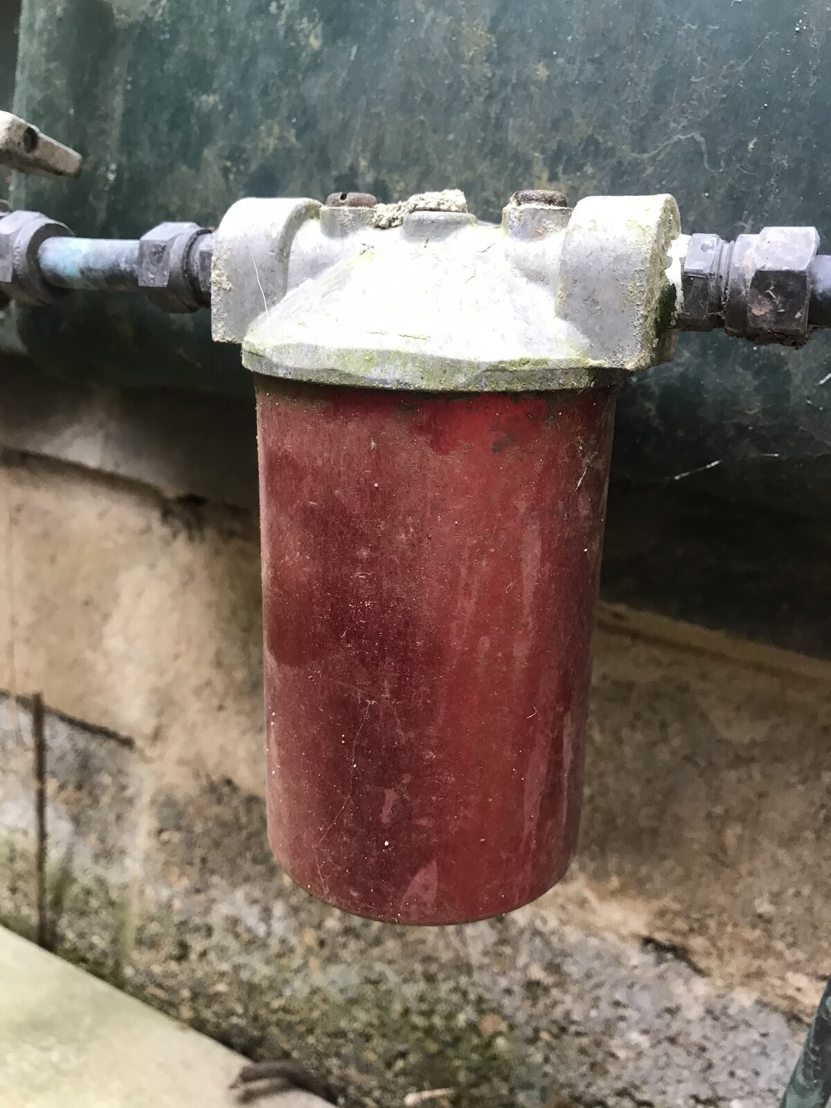

Yes that’s right it is a gate valve (thank you for the correct term!). The boiler has been running at non stop since I posted but it’s cut out now and there’s a bit of an exhaust smell in the garage (not crazy).... I have carbon monoxide detectors all over the house but still I’ll shut it off for now!
I have taken a couple of photos of the valve and what I think is the filter housing.

Yes, thats an elderly gate valve with the hand wheel long gone followed by a Crossland filter with the two bleed valves on the top.
If you do as Bob suggests you’ll see if there is enough kero flowing through the filter and down the pipe.
I’d be very cautious about undoing anything on your set up there, just in case you get a leak which you can’t stop, but if I had to it would be the one one the pipe exiting the filter.
John :)

Looking at that sight gauge I’d say there’s water about as that looks like emulsified oil and water so be careful not to drag any through the fuel pump. Bob
You can close off the tank, and then open the vent screws . Open the tank valve to how it was, and you will soon see if the oil flows, and be able to close the tank off quickly.
If it is now running for a reasonable period before locking out, then the fault could be in anyone of 4 areas, especially if the service is long overdue. The fuel may be contaminated if the tank is 24 years old,(the sight gauge shows signs of this) or the filter could be clogged, the oil pump may have developed a fault ot the photocell may be obscured, or the nozzle may be worn. These can be the cumulative effects of a long period of non service.
Why has it taken several months for you to decide the new gauge is faulty? The only adjustment for these is based on tank depth, and is easily measured and checked. This is something that should have been done when fitted. You need to also adjust the level to the outlet rather than the bottom of the tank as that is about 3-4 ins above the base.
Thanks oilhead and Bob. That’s a fair point about the sight gauge as it was left in the open position (presuming my photo shows it closed) assuming the engineer did this. Maybe that has leaked some water into the fuel and contaminated it.
