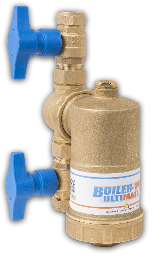

Hi, can't seem to find too many reviews or much information on these, dimensions etc. They look pretty good though. I'm contemplating fitting one to my central heating system, but I only have limited space below the boiler I can use. Can anyone please advise? Thanks in advance.
Thanks for the pointer, yes it looks just like the Flomasta CCB01T0097 on Screwfix. Still not much info on that though. It does give dimensions, but no diagram, which would be useful. It's getting on for twice the price of the Boiler-m8 too!

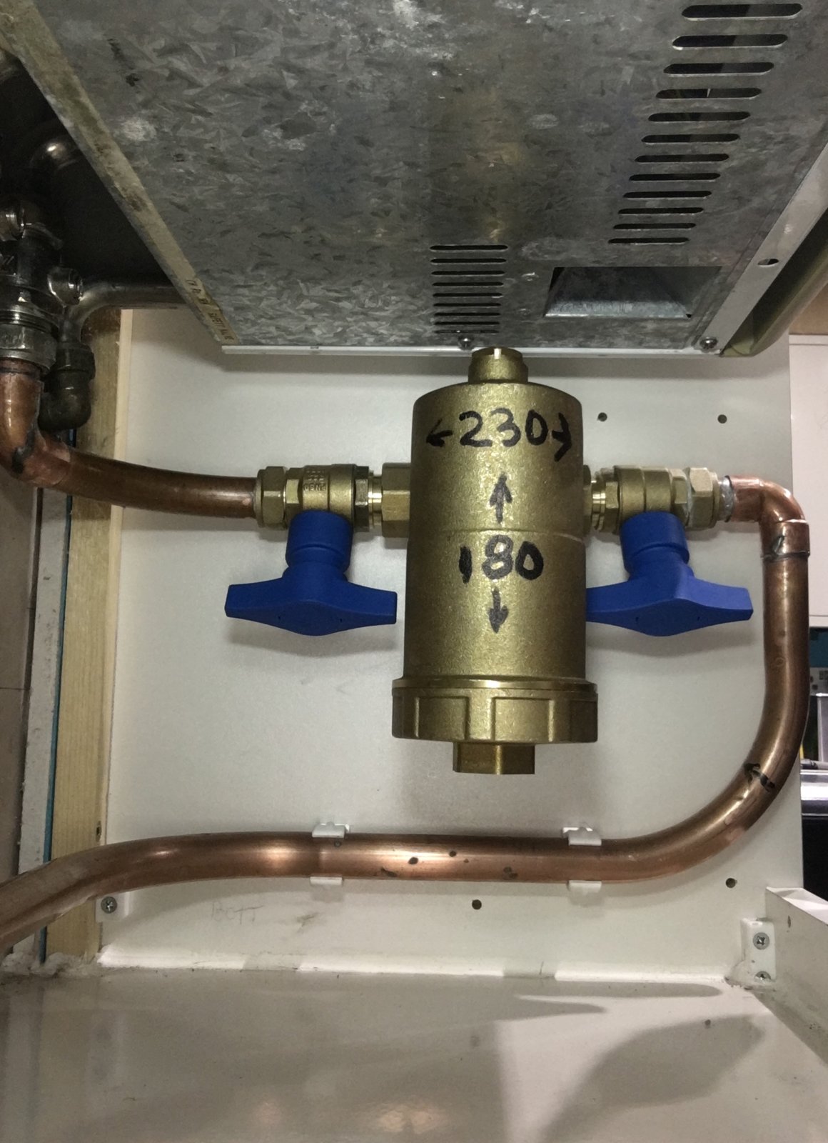

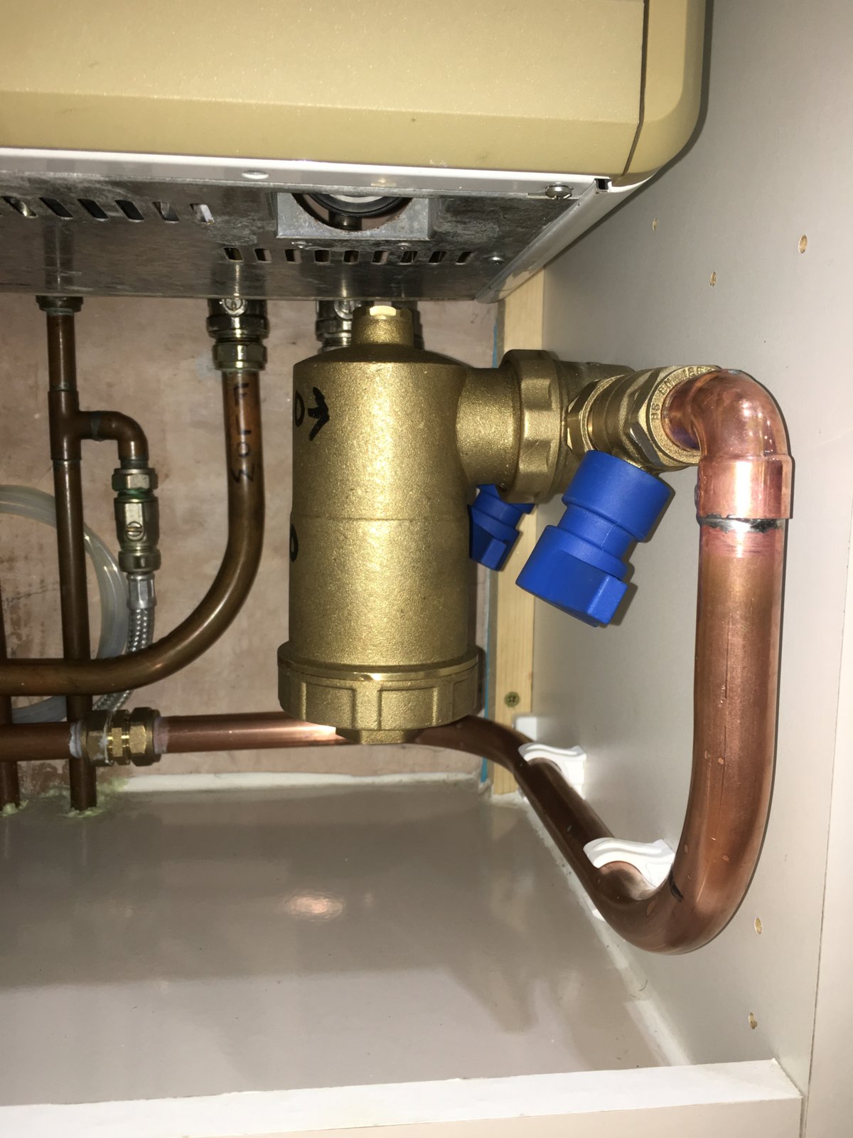

Got myself a 22mm Boiler-M8 Ultimate off boilerfans.co.uk through eBay. Really fast service. Arrived next day. Thought I would put some pics up of it installed. I’ve yet to see how much muck it picks up. Will be interesting to see. Approximate sizes are as follows: width from end to end of valve nuts (handles stick a little further past when open) 280mm, height 180mm, depth 145mm.
