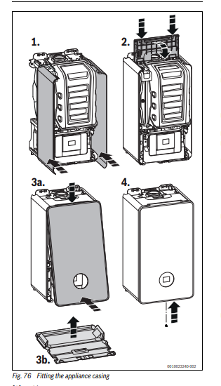

Hi had a boiler fitted and it looks tilted, I thought it was possibly the window making it look out of true but the window casing is as near as damn it level (.1deg vertical) so I put my level on on the boiler casing and it’s 1.4 deg off vertical, so it might just be the casing that’s been fitted off kilter.
my question is, would this tilt; if the internal parts are fitted tilted make any difference to the boilers function or is it just an aesthetic thing that can be corrected by adjusting the case and regardless of whether the internal working are slightly out of true the boilers function will not be affected.
Are there tolerances for this sort of thing?
You've not said what boiler you have, some would be affected more than others by this, but it shows a poor attention to detail from the installer and makes you wonder what else they didn't do too well
That’s what worries me, they have said it’s just the casing but I’m not so sure. They are coming back to sort it and I’ll be there this time, not paying until it’s done right, the boiler is a Worcester Bosch Greenstar 8000, I’ve sent an email to Worcester Bosch regarding the fitting as I don’t want this issue to void any warranties. Are there any technical documents re installation online as I can’t get back to the flat just yet and would like to gen up on any specific details on this issue.
If the casing hasn't been fitted correctly then that's a safety issue, as the casing forms the room seal that prevents carbon monoxide being leaked into the home, so definitely don't be fobbed off by "it's just the casing" excuses
That's interesting. Looking at the the appliance casing fitting instructions it would appear to be just sliding fit side panels, with push fit top and bottom panels and the front panel semi hinged into position and secured with a screw for electrical safety. Cannot see that being an effective barrier against carbon monoxide gases although it would prevent exposure to hot surfaces and electrical wiring
Actually you might be right with that one, I've only ever seen one and I'd forgotten it had an inner casing
It will not affect the correct working of the appliance in anyway
