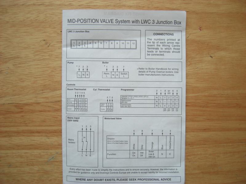

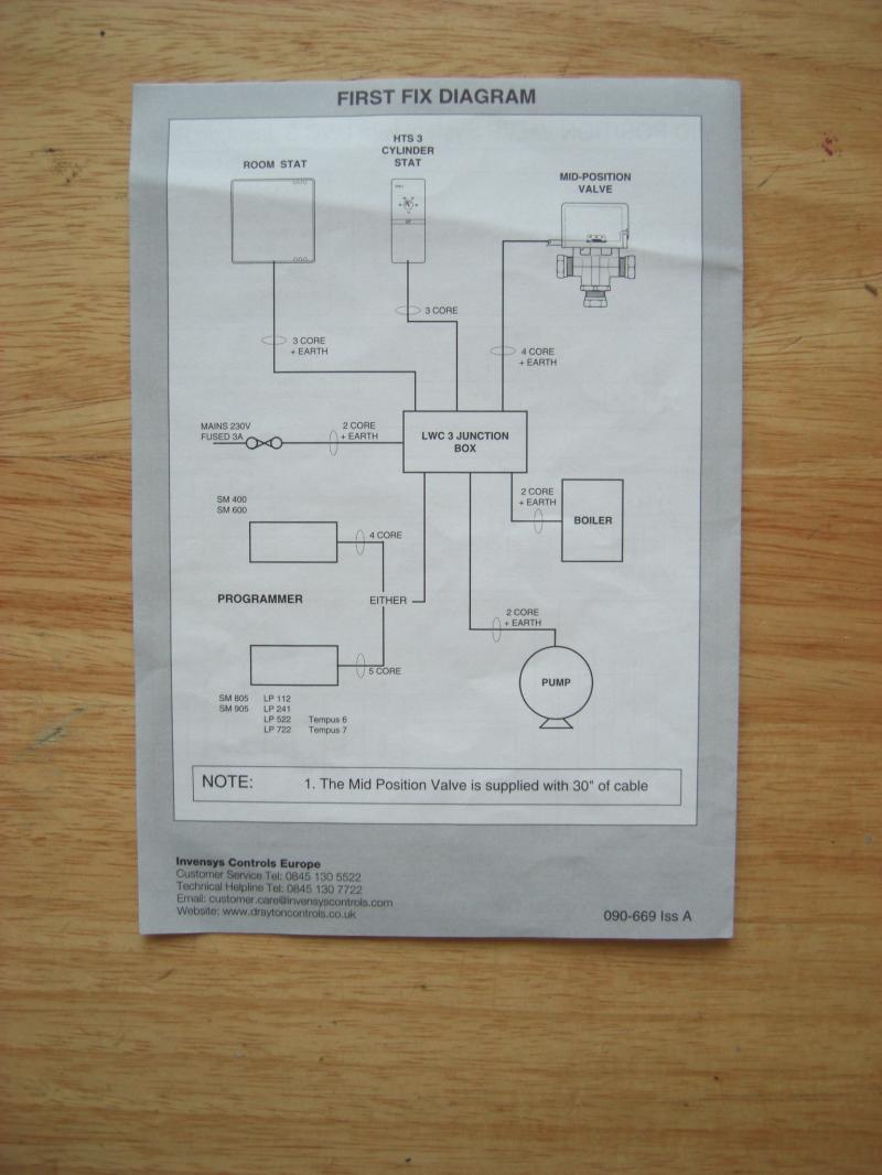

you need to post a wiring diagram, the pictures dont tell us much.
looking at my jtl wiring plan for y system no it does not look right get some one with part p or 17 edetion to have proper look maybe on electircs forum
Wiring diagram is not to standard format. Starting from left, it would normally be live, neutral, earth, CH from programmer to roomstat, from roomstat connected to white of 3 port etc.

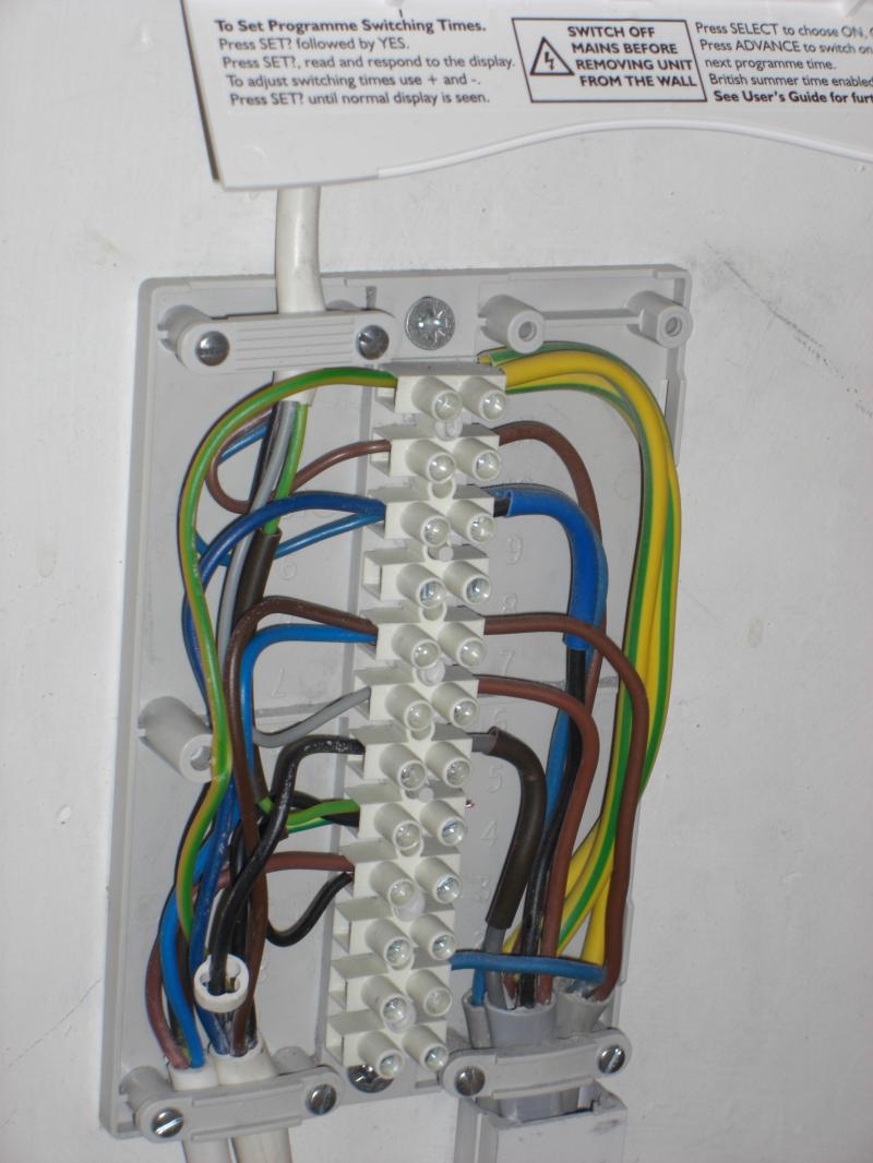

By wiring diagram do you mean the diagrams from the install wiring guide – I have taken pictures of them and also flipped the image of the junction box the correct way up as you see it
As you look at the wiring the box is numbered 12 to 1 with position 12 being at the top of the box and position 1 at the bottom. The left hand side of the wiring appears to deal with the Three port valve / Boiler Stat/ and Programmer whilst the right hand side appears to deal with the feed to the thermostat and the mains electricity (but this is strictly a laymans point of view).
I have done my best to jot down the positions and wires attached, not being a sparks I have referred to the colour of the wires as on a plug so Live is brown etc
Position 12 Left - Earth (3 Port V) Right - Earth x2
Position 11 Left - Live (Prog) Right -Live
Position 10 Left - Neutral (Prog) / Neutral (3 Port V) Right - Neutral
Posiiton 9 Left - Empty Right - Empty
Position 8 Left - Live (3 Port V) / Neutral Boiler stat Right - Live
Position 7 Left - Grey (Timer) Right - Live
Position 6 Left - Black (3 Port V) Right -Grey
Position 5 Left - Black (3 Port V) / Earth (Boiler Stat) / Earth (Timer) Right - Empty
Position 4 Left - Black (Timer) / Live (Boiler Stat) Right - Empty
Position 3 Empty both sides
Position 2 Left - Empty Right -Neutral
Position 1 Empty both sides

Remove the LP522 from the backplate and make sure the switch/link on the back is in the P (pumped) position.

Unfortunately colours mean nothing when it comes to wiring up heating systems. Blue and Green/Yellow wires are often used as live conductors.
There is no mention of the Grey, Orange and White wires from the motorized valve.
Which are the room thermostat and cylinder thermostat?
We really need to know what device each wire connects to including terminal number on the device.
you have a "nuetral " on its own, so the wiring is all over the place, in this case I would disconnect all the cables, trace them and start afresh following a y plan diagram.

I asked about the switch on the back of the LP522 and I am assured that its set in the P position. I really dont have a clue where the electrics are concerned what I have marked down is that the room thermostat must come from the right hand side based upon how the wires are chased into the wall, whilst for the cylinder stat I have referred to this in the diagram as "Boiler Stat".

Ask the sparks to provide you with a diagram/list stating what each wire does. Then if it still does not work, you can post his info and we can analyse it for errors. (But don't tell him the last bit. ;) )
I had a similar situation a while back with my own 24Ri but with the boiler not turning off straight when the demand finished on CH, although if you left it alone it would eventually switch off when the boiler reached temp.
It turned out that when the demand finished on CH there is a small voltage (69v) on the orange wire from the 3 port, this is not present when the demand finishes on HW. This voltage is enough to keep the board from shutting off the boiler & fitting a capacitor between the orange wire & the neutral will get rid of this stray voltage.
You seem to have the same situation although in reverse which makes me wonder if your 3 port is on the right way around? it will be marked up A & B with the B port going to the cylinder.
