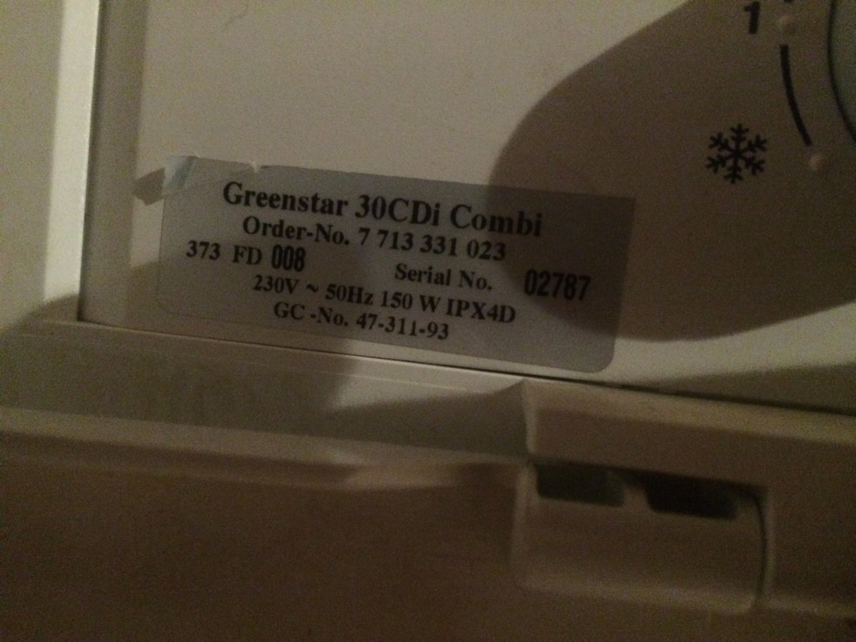

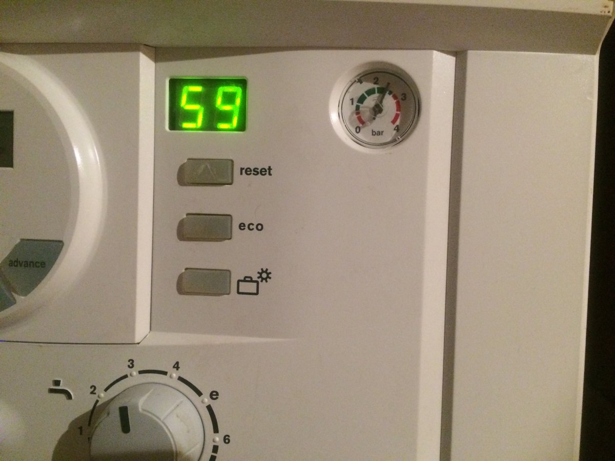

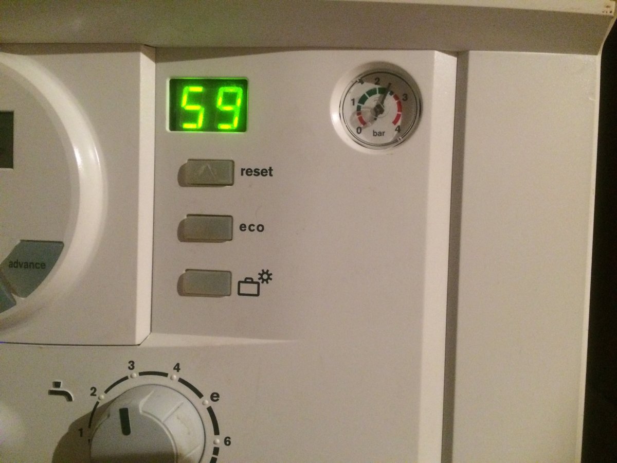

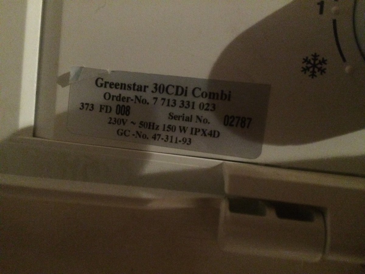

A little concerned about my boiler pressure. This morning the needed was hovering around 1 and I decided to re-pressurise it and the needle went to 2 before I could close the valve. It's now at 2.5.
I have bled the radiators and it moved slightly.
Read something about releasing the water using a flexible loop but can't see anything that looks like it.

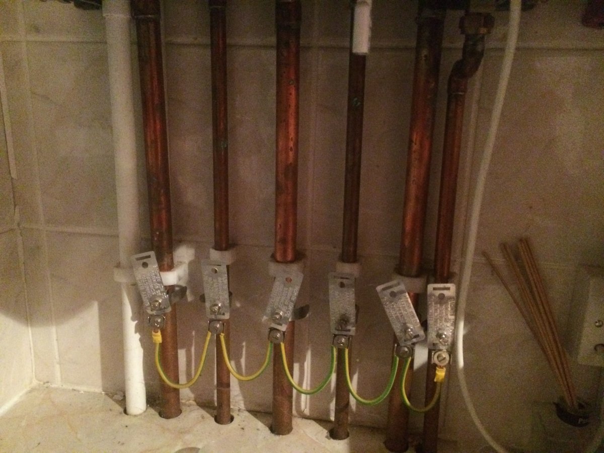

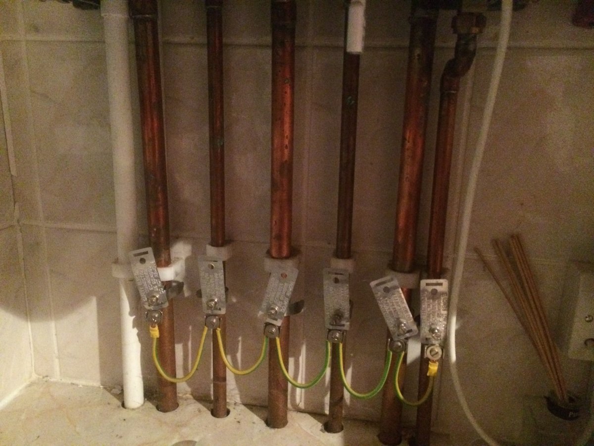

Boiler is WB. Some pictures attached to help.
Didn't service the boiler last year because I changed some rads and the gas safety guy said the system was fine.
Any thoughts greatly appreciated.#

Easiest place to drop the pressure for a novice is the bleeding points on the rads (air taps)
Get a little tub to catch the water
Hi PlumbB 1979 and PrentinceBoyofDerry
Many thanks for your prompt response.
I initially started to bleed a rad with a TVR on it but black water started to come out and stopped - I take it that isn't a good slgn - maybe i have some sludge in the system.
I then tried again with the bathroom rad that doesn't have a TVR; the water that came out was clear.
The indicator has returned back to 1.5, so again many thanks to to you both.
