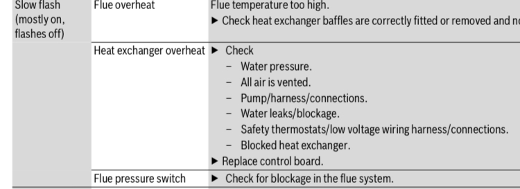

Hi
My conventional boiler a Greenstart Ri has started shutting down occasionally. Usually in the morning it won’t come on until it’s reset. It’s done this a handful of times in the past couple of months, normally when it’s frosty.
I have noticed it ejects quite a lot of water from the siphon. There is a gush every few minutes (when working “fine”) but I also see air in the system as I frequently have to bleed a couple of radiators. I don’t see any leaks.
I am going to get it serviced but just wondered if anyone has any ideas about what this could be so I can brace myself.

Nope sounds great. When it fails to start I think it’s the attached error.

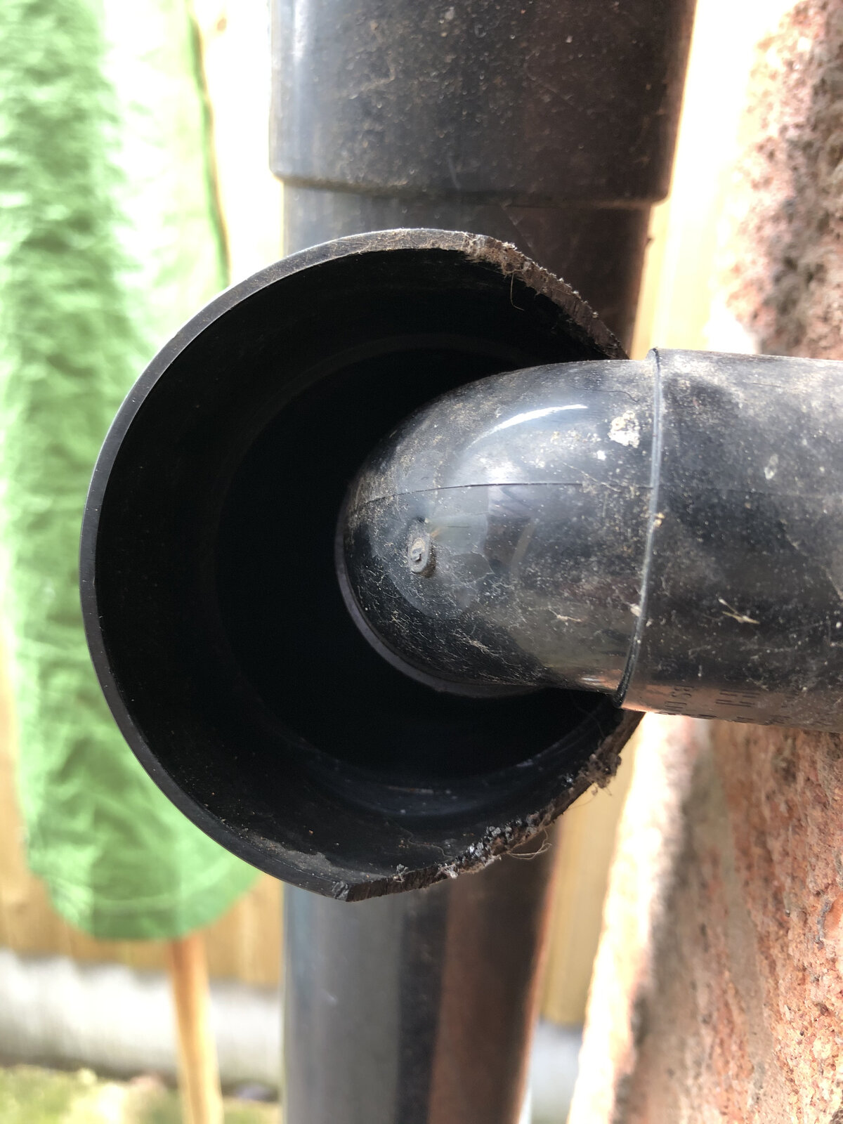

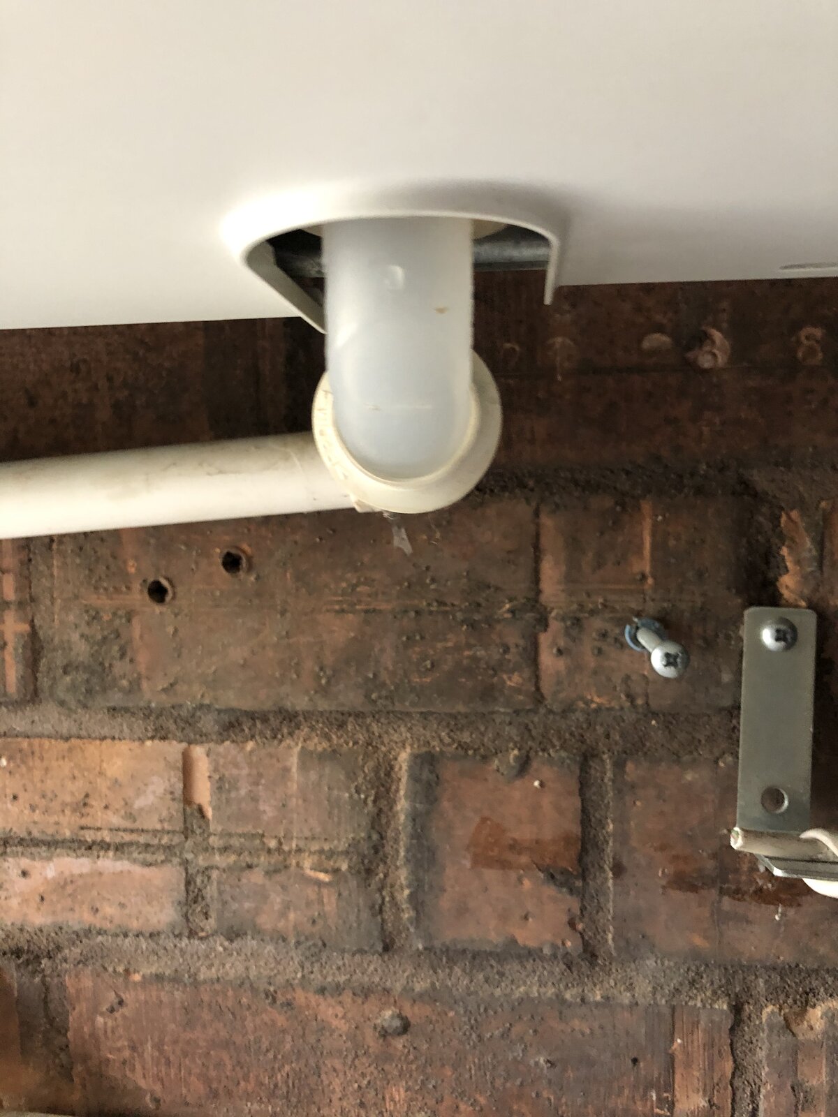

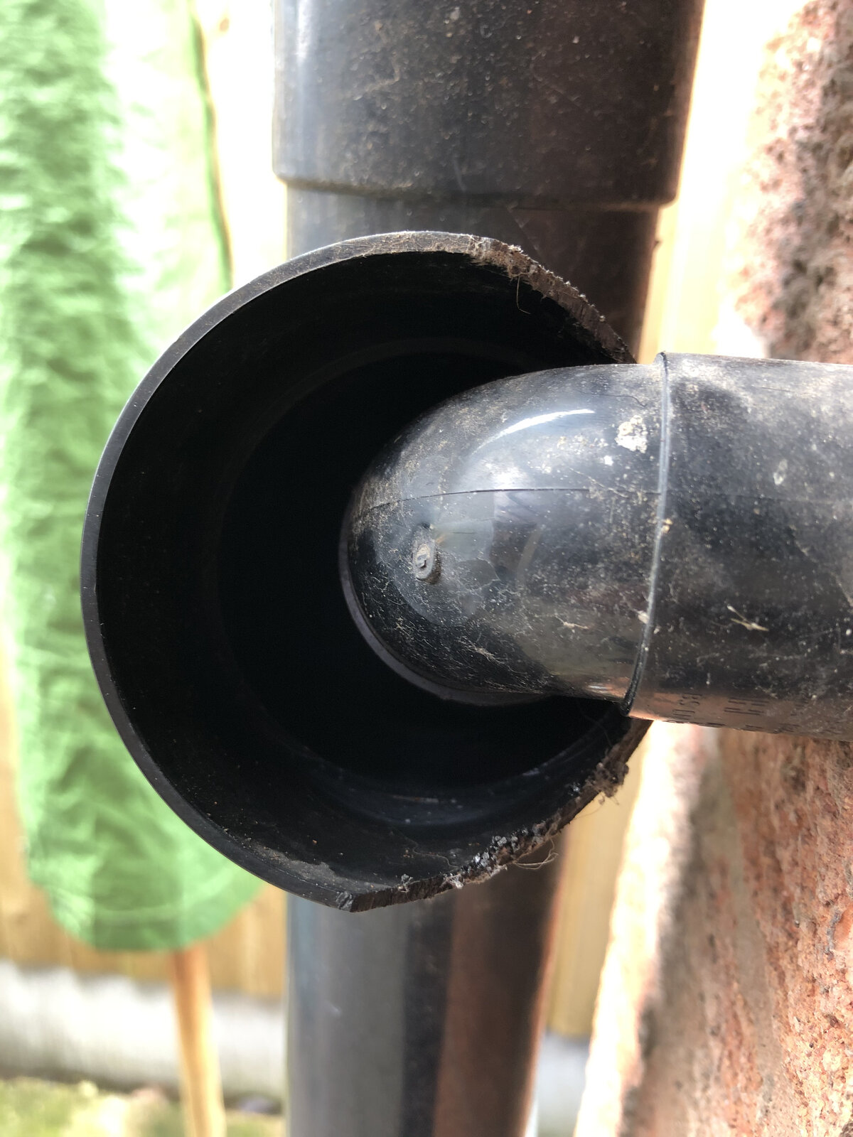

By syphon do you mean the plastic condensate pipe to outside?
Yeah.
It goes in to a drain pipe outside that’s not enclosed so I can see the water (and steam when it’s frosty)
That sounds like it’s working normally. The condensate is a result of burning the fuel efficiently.
