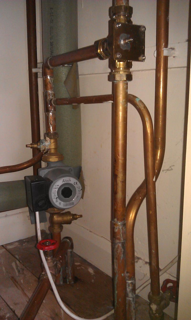

Hi, I am very inexperienced with central heating but have been having problems that get worse. NOW i have a boiler that works, but does not seem to heat the water or the radiators. The boiler lights up starts heating but then makes "kettling" sounds and turns off. I thought radiator pipes were blocked, put in sludge remover, left for several days then drained off each radiator and the drain above the boiler. Muck came out then clean water on each when it had run clean for a while I stopped. I was also told it could be the pump, I checked but it seems to be running vibrates when system on, the by pass valve may not be working, not sure on that. The pipes from the boiler up to the hot water tank get hot, as does the pump and pipes near it but still "a non working system". I was then told to isolate the pump and check if the ??inverter was working, no idea what this is, had a go at isolating pump, could not stop water coming out - now not confident that isolating valves are working/were turned the right way. Any helpful suggestions welcome - I can criticise and ridicule myself - lots!! HELP.....

I would not stake my life on where pipes come and go from without taking up the floorboards. I have attached a picture (i think) of the pipework in the airing cupboard.
There is a pipe coming into the bottom of the pump that is hot, the pipe in the foreground where the front of the by pass valve has been taken off is hot.

Where has the Silver Box (Actuator) gone from you three port valve??
the Brass fitting with three pipes attached above the pump??? :?
The silver box is still attached to the electrics, a plumber I had recommended, told me he thought it was not working properly and took it off before he went off to finish another job. He has still not finished the other job yet.
It is actually just out of shot down bottom left.

get a heating engineer to test and re-connect the actuator or replace it if it is faulty, you may be able to just replace the synchron motor if that is all that is at fault, get rid of your plumber that removed the head and dissappeared
