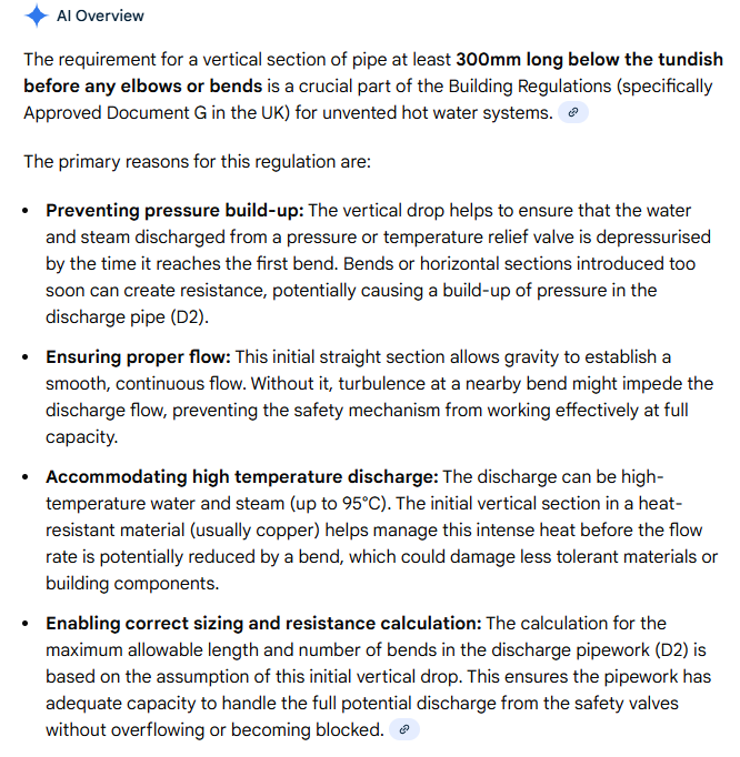

Hello All
On page 11:
6. INSTALL THE PLASTIC VENT ASSEMBLY
It says "The inclusion of the vent pipe conforms to UK building regulations.Outside of the UK it may be removed, please check local byelaws.".
Could some kind person tell me why our UK standards are "higher" in this regard than our neighbouring countries? What are the implications (other than legal building regs ones) of ignoring and choosing the smaller vertical pipe assembly I wonder?

Hmmm yes. But what is it behind the regs? I mean why is the taller vent pipe superior ?
Maybe to give the steam time to form into water droplets. No idea to be honest.
But all it's saying is the vent pipe may be omitted outside of the UK if allowed. It will still release steam below the sink, therefore I think I prefer it to be connected to the wate pipe rather than not.
Interesting - thanks.
In all cases, the tundish is connected through to the waste pipe. The issue is whether or not there is a "long" pipe between waste and tundish. I think....As you say less likely to enter the 40mm waste as steam if first it goes through a vent pipe.

If I read correctly it could be the primary purpose of the "long" vent pipe is to prevent anything in the waste pipe coming out of the tundish. That makes a lot of sense to me.
The hose loop I don't get that. The discharge hose leads from the boiler into the tundish. The smells from the sewer would be coming out of the tundish. I guess a second trap in the waste pipe downstream might work but there's no space. Or maybe I could fit a gulley outside to break the pipe leading to the sewer proper. I dunnot, maybe I'm worrying about nothing here - perhaps there is some kind of gas check valve incorporated into Qettle's design somewhere to prevent this. I can't believe customers would be happy if their tundish stunk the whole time.
