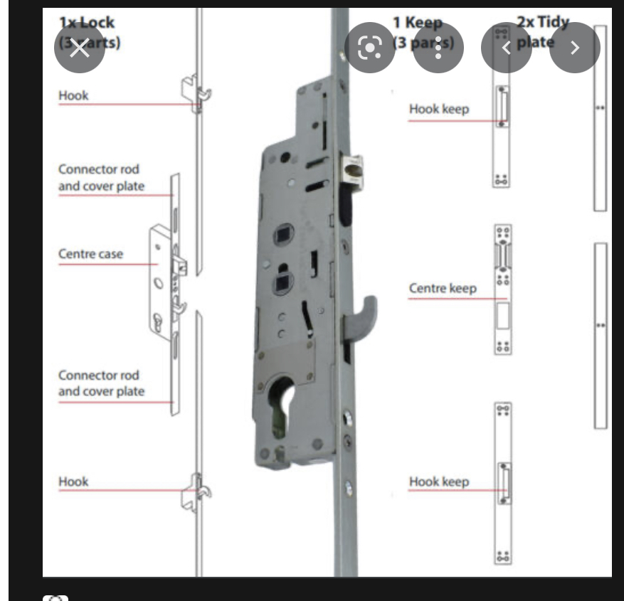

When pulling up a upvc door handle, the door clicks and some bolts move into a fitting to futher lock the door. Does anyone know what the technical name of the bolt is and the fitting in the frame which it locks into ?
I’m not quite sure what parts you want but try looking up up UPVC door lock mechanisms and you might find the names of the parts you want. Here’s a couple i found doing a Google search.
Its usually a combination of hook shaped bolts and shoot bolts.

Multipoint door lock.

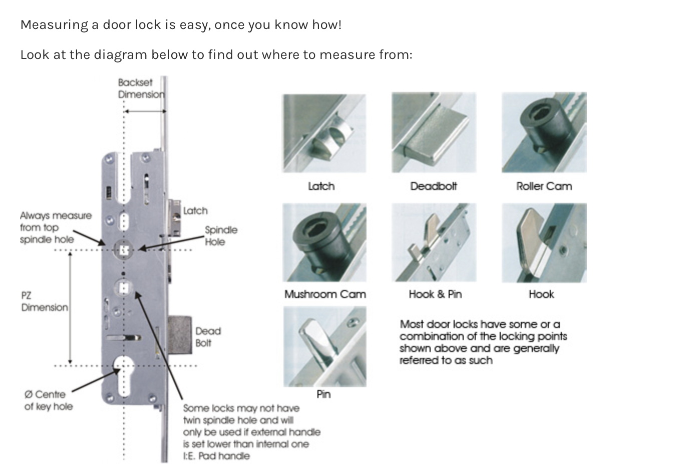

Thanks guys. Its a roller cam keep. My cams roll up and down and I'm trying to find an adjustable keep that will push the upvc door about 1-2mm closer to the frame.
Your cams can be adjusted with allen key to tighten or loosen the compression. Theres a line on the face . Facing horizontal is tighter or looser. If gap is top or bottom it might be that frame isnt plumb
