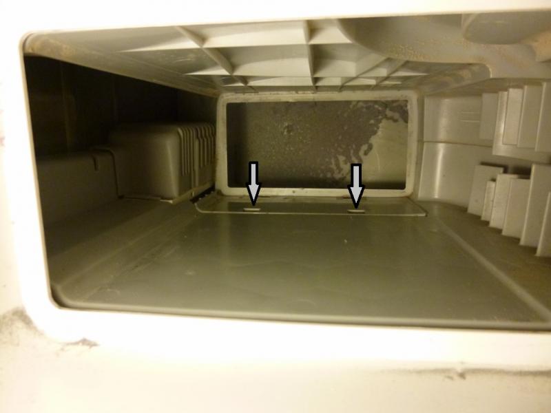

Hi
It looks just like the photos for another machine in a previous post ...but this is mine as well - click on the image to see the larger version...
grey arrows show where the catches are you put your finger in the hole and pull toward the front. As a PP poster said - I find doing one with one hand whilst pulling up the edge with the other hand works best...
Second photo is when it has been removed
Good Luck...its a mucky but satisfying job... :LOL:

Thanks to Bnaji I found the secret flap, have cleaned out a lot of sludge, but the problem still persisted. I just had a visit from an engineer who fixed the problem and explained very nicely what happened. The water that comes out of the wet laundry first goes into the chamber that is covered by the secret flap, then get's pumped up to the container at the top. When this container is full the water overflows back into the chamber at the bottom and the sensors read the water level down there. The sensors sit by the side of this chamber (next to the pump, they can't be seen without opening the machine) and when they get covered in lots of sludge they still think they sit in water even though they aren't, that's why cleaning the chamber under the secret flap helps. However when the sludge gets also stuck on the sensors it might become necessary to open the side. The engineer also said if it happens again to try reaching into the secret chamber to the back/left with a small soft bottle brush to remove sludge. He also recommended to use as little fabric conditioner and washing powder as possible as this is (along with unavoidable fluff) the main cause for the sludge build up.

Found this great post, took apart my dryer, hoses clean, no problem... Then I found a "secret door" flap, whatever, located in the bottom panel in the slot where the large cooler/filter thing goes. It is in the way back on the bottom. Lies flat has two hinges that you pull in with your fingernails towards you. Lift the flap up and you have a small holding area that gets full of gelatinized sludge! Pulled out about a cup full of lint filled slime gel, dried everything, put cover back on, viola! Works like new.
