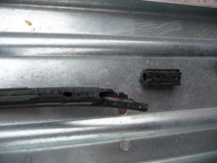

Hi Rocks1
You are a clever thing! You were quite right - it was the tube. The mice had been in the machine and had eaten part of the rubber pipe along with stored some acorns in the top...
I assume that I could make up a bit of similar pipe that would do the job, or would I need to buy exactly the same part from a Bosch dealer or general washing machine shop? If it is the latter, presumably I will need to get a part number from Bosch.
Thanks so much for your help.
I have attached a picture to let you see what mice can do to a Bosch.
JB
any pipe will do as long it fits on the pressure switch .try a motor factors ie washer pipe that goes on the window washers on a car ,look under your bonnet see it pipe fits or try a scrap yard :)

Thanks for that. One more thing - I tried to repair the pipe with some tape and it still did not work. I then noticed that the pipe seems to have a T-section. Is that correct. Does it run from the top electronic pressure unit (a cylindrical brick-coloured thing) then down to the RHS middle of the drum then downwards and around to the bottom/other side of the drum?
It is not possible to see where the pipe goes by looking in from the top.
JB
they can run to 2 different places tilt mc back and you can see underneath .
Hi again Rocks1,
Found it and repaired it with a piece of narrow watering tube that I slipped into each end of the now-shorter (thanks to the mice) rubber hose.
The wm is happily trundling away and all thanks to you. Do you wish to make any charge for your advice? If so, let me have your email address and I can send you what you request via PayPal. If not, thank you so much for your help that have saved me having to lift the wm into the car and drive over the mountains to somebody who would have probably charged me a fortune and told me that I needed a new machine!
