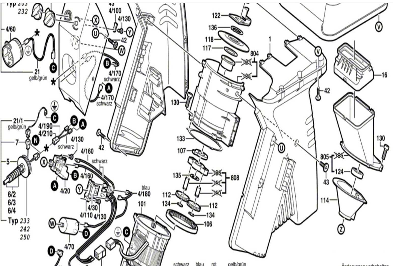

AXT1600HP Bosch Shredder - Can anyone help me locate a switch for sale anywhere?
The switch is item 4/20 in the parts diagram but I am unable to find it anywhere online for purchase.

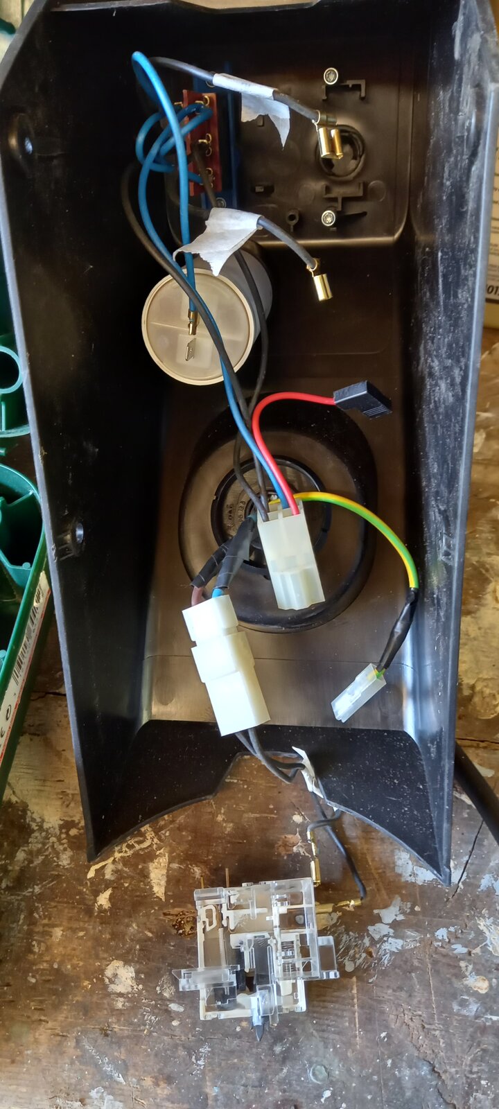

The switch mechanism is actually broken. I'll put up a pic of it.

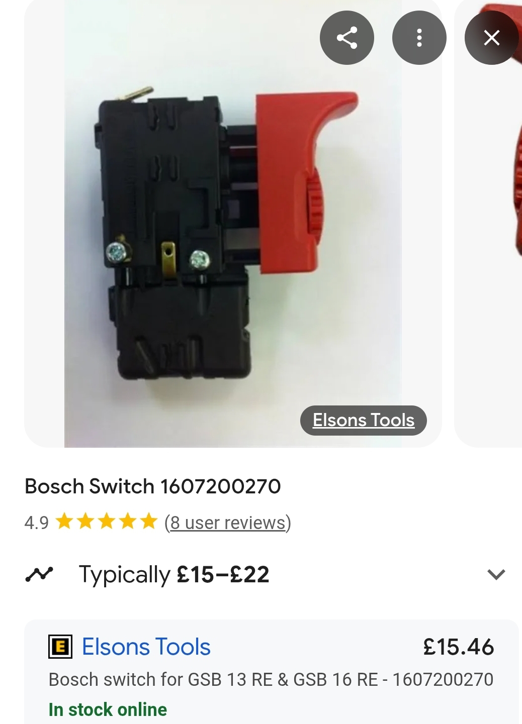

Did a Google Search for
"700 2/6 switch"
and it looks like it is a c£25 switch also used by Karcher:

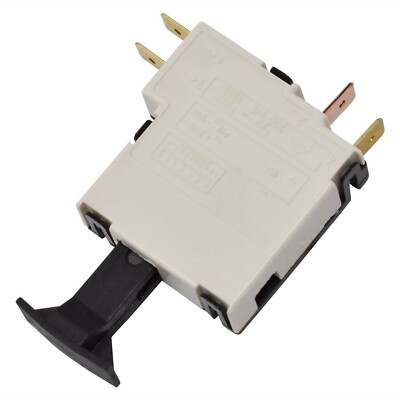

Better picture here:

Thanks SFK for the info.
The Karcher black switch lever appears to be a push/pull type, whereas the Bosch shredder is a rotary switch.
I'll have to see whether the switch can be modified, or the shredder can be wired as a push switch.
The problem is that the on/off switch plastic control knob (not in the above pics) is ganged to the forward/reverse switch to ensure the machine is switched off before changing direction.
Just realised the control knob is shaped such that when it is rotated, it converts the round motion to a horizontal motion to operate the switch.
I will order the switch and see how it goes.

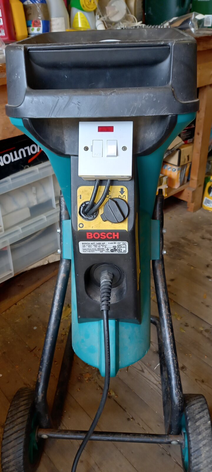

The recommended switch was wired differently so not suitable.
Manage to find this switch in amongst my 'odds and sods' box.
