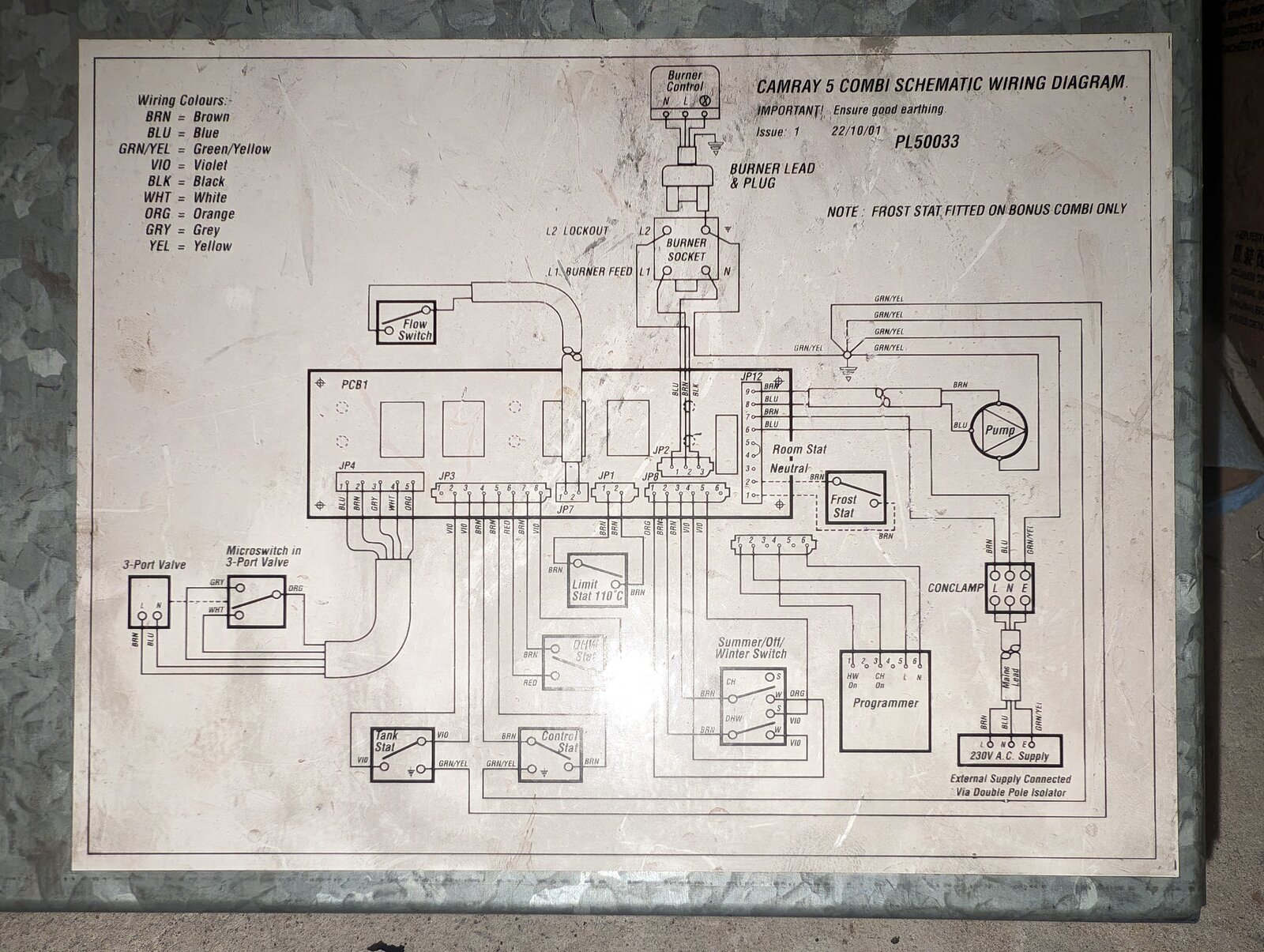

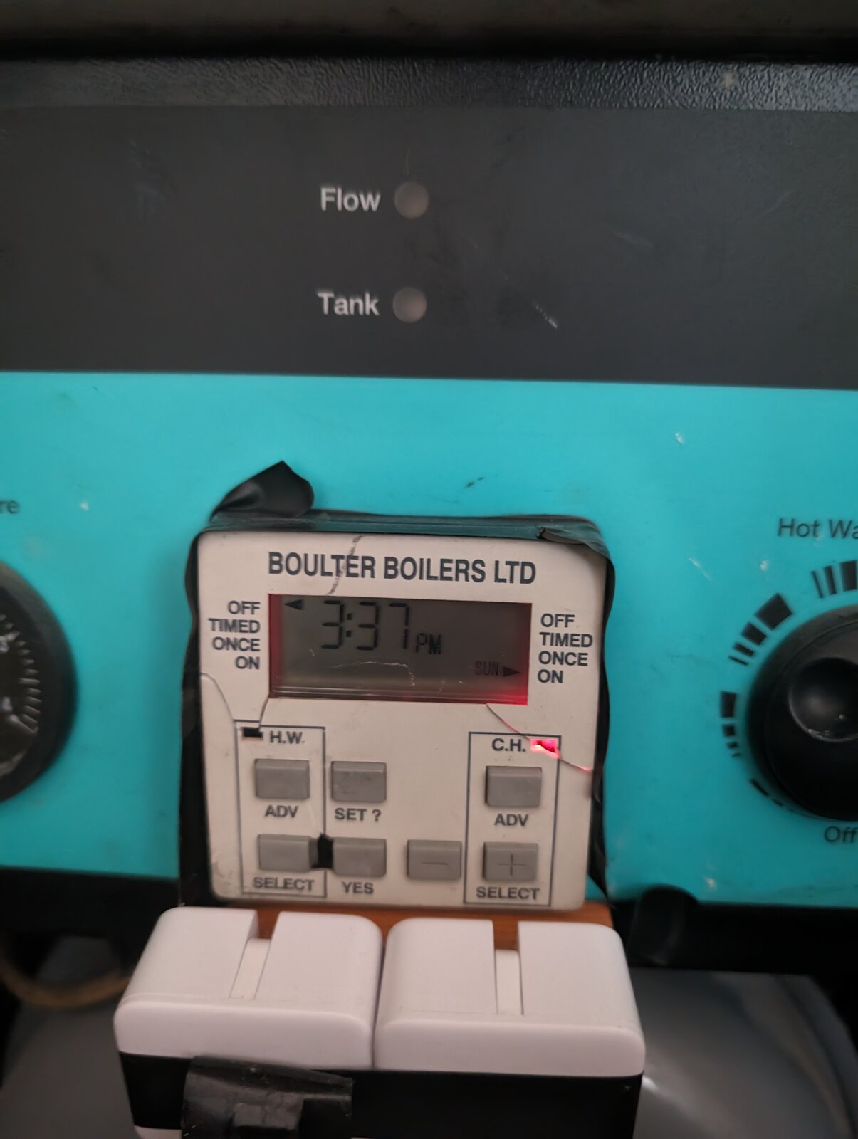

I have a programmer fitted to the boiler which is original as far as I can tell, with the programmer and wiring diagram shown in the images below.

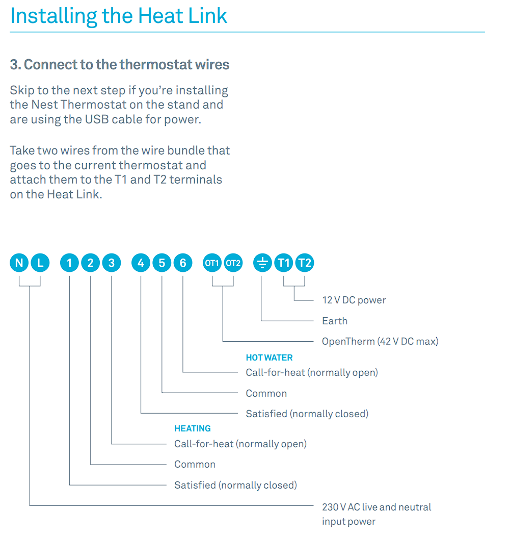

I'm confused as the Nest Heat Link wiring diagram (also below) shows multiple wires for both HW and CH, while my current programmer is only using 1 for each.
Ideally I'd like to simply disconnect the wires from the old programmer, and use them to feed the Heat Link - but perhaps there's more to it?

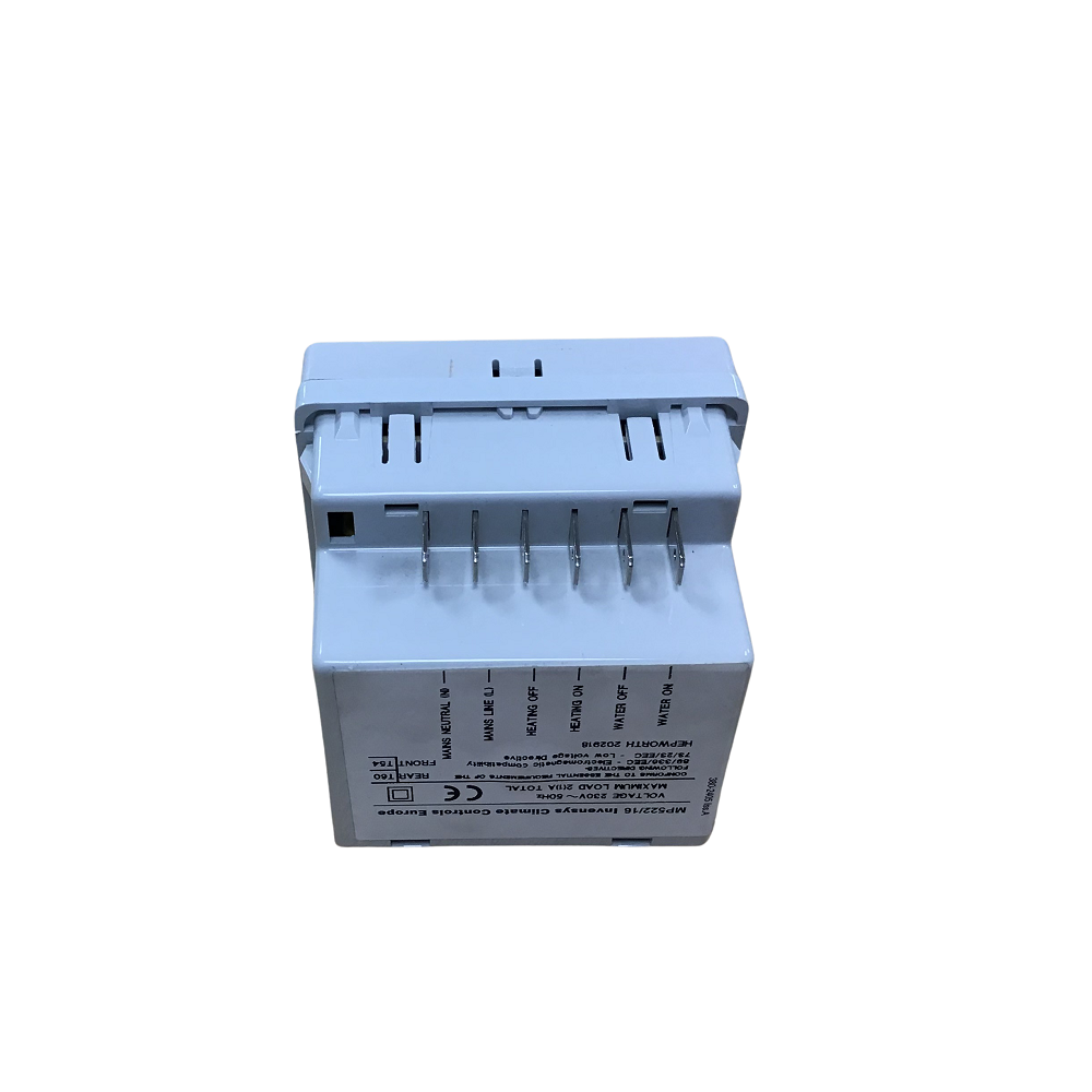

Have you investigated the wiring behind your existing stat?
I believe it's hooked up using spade connectors...
(Image from... https://www.trustapart.co.uk/product/glowworm-programmer-control-s202918/ )
It may be necessary to adapt, or change the existing cable to connect up the Nest.
Your existing programmer has built-in links between Live and the common connections of its relays.
The Nest Heat link has 'Voltage free" contacts - this means we have to make the links ourselves.
You would connect...
L on your existing controller to L on the Heat link
N to N
Heating On to Heat link terminal 3
(Heating call for heat NO)
If there is a connection to Water On (although you have a combi), it would attach to Heat link terminal 6
(Hot water call for heat NO)
Additionally, you would require two short link wires, to connect L and the common terminals 2 and 5 on the Heat link.
Oil burners may have higher current loads to switch, than gas boilers.
In this case, your existing controller can switch 2(1)A (2A resistive, 1A inductive) in total.
The Nest can handle 3(1)A, which is fine.

Need to figure all that out next, but sure beats pressing buttons on the tiny LCD programmer I used to have
