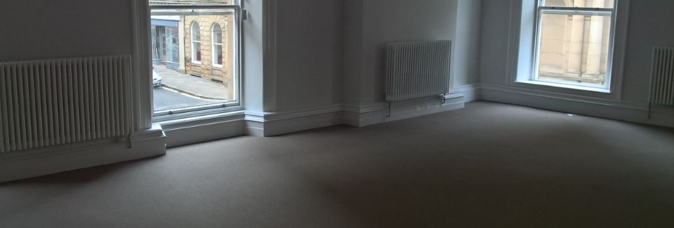

If you decide to re pipe I would consider going round the walls at skirting level. You can then fix a batten to the wall at skirting height then fix the skirting to that. It will then look like thick skirting and hardly noticeable. You could do the same around doors with the architrave.
Yes, in the way I mentioned in my previous post? Here's an example of part of about 700 liner feet or so of the stuff I did on one job
