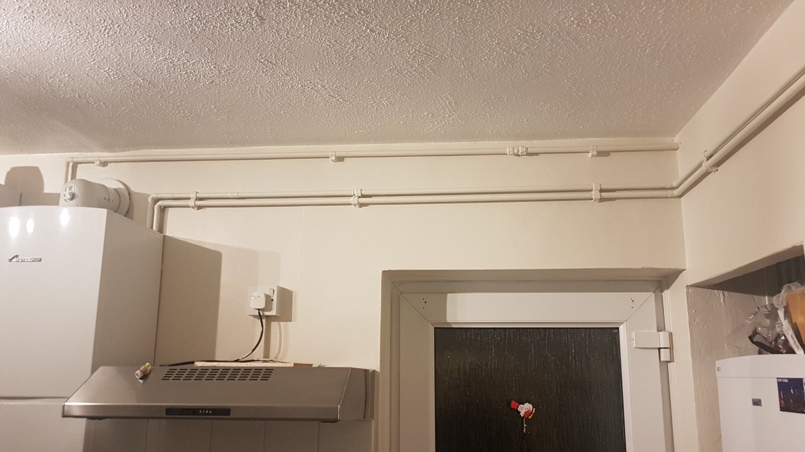

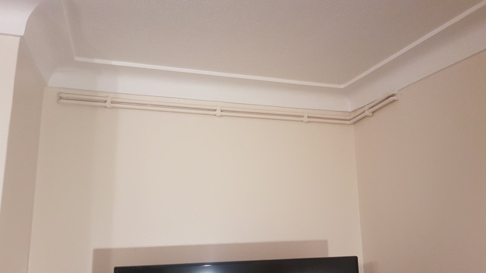

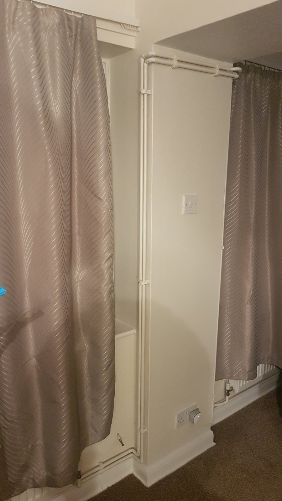

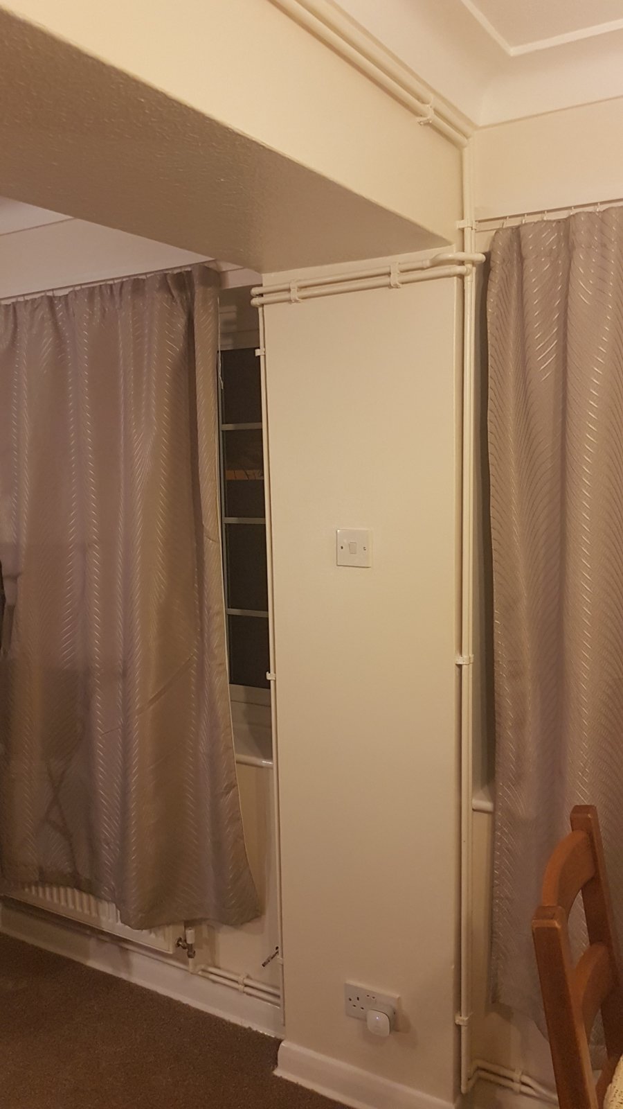

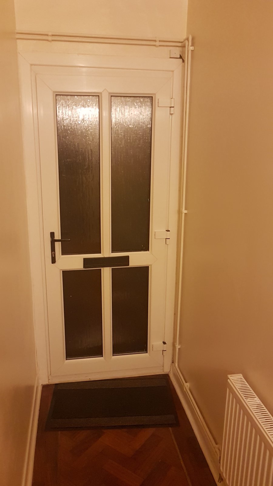

Morning,
I've attached photos of the various radiator pipes around the flat, and would love some ideas on how to best cover them up, by boxing them in.
I've searched online and noticed some people use mdf, anyone used plaster board for a smoother finish.
Would appreciate some ideas on how to cover them and try to blend them to the walls and coving.
Thanks in Advance

you could use Talon snap and clip pipe covers - from SF an others, or similar plastic pipe covers. it will be well fidly but doable if you take your time.maybe a mitre box would help for corners.
Looks a mess with little thought to appearance, you will struggle to box in , pipe covers are the best you could hope for.
Plasterboard is no smoother and requires corner beading and skimming to finish. In situations (such as at floor level) it is very vulnerable to damage - which is why professional joiners, etc use MDF or plywood. It also requires some form of timber framing beneath it. Of the two MDF tends to paint out far better.
The quick way, used by people in social housing, offices, etc are commercial systems such as Pendock and Talon - mainly for speed, although they also tend to be smaller in section than home-made boxing-in
TBH your pipework is an absolute mess. I think the best approach would be to use the lowest profile pipe boxing that you can find from a firm such as Talon
Or just do a proper job, box out in either mdf or plasterboard on a frame and redo the covings where needs be. That's the only way you'll get it to look correct. Those covings will need to come down and new ones set further across.
Now as photos have arrived,boxing in will help some areas.
Personally we would re-pipe re-route the to conceal the pipes. doing a similar job next week,weather permitting (y)

Any photos of before and after Old&cold as I might go down that route too on some areas.
...not sure if it was the because the previous owner did it on the cheap as it was a rental property in an area where the demand for rental properties is high, or because of the solid walls and floor didn't give him much option
If you were doing it "properly" you'd tend to run the pipework beneath he floor or above the ceiling with runs up and down the wall chased back into the wall and maybe plastered over. I've also boxed pipework at floor level into extra deep skirtings on many occasions over the years. TBH I think it was done on the cheap, or done by someone who frankly didn't know any better
I think it was done on the cheap too, as the flat has solid walls, floors and ceilings and this would've made it harder to hide without making it more expensive for him.
I think I'll have to re-pipe and re-route them to a level that will keep boxing to a minimum and more discrete.
Thank you
Boxing is going to make that lot look worse- obv paid for by someone who had no intention of living in the place. Yes solid floors makes the job trickier but if you plan it carefully you can make it look a lot better. Shame really, the actual pipework is done quite neatly (all nice and parallel except that up angle under the coving and the crossover between the windows). Depending on the layout of the rooms it might be easier to put manifolds in and then hide microbore behind skirtings/covings. Or you could try stripping the paint off and going for the steampunk look with lots of polished copper :)
