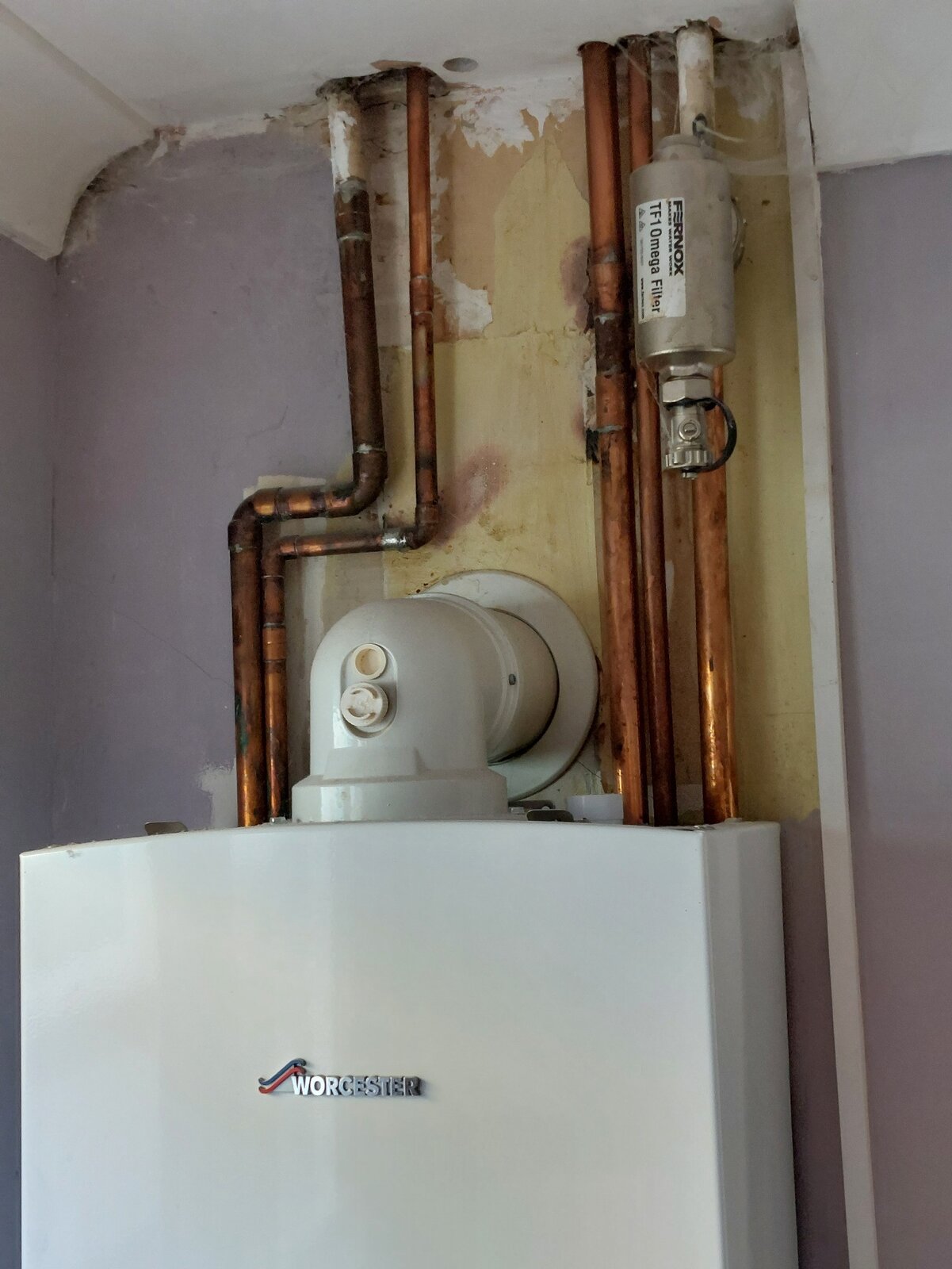

I have decided to do this myself as I have been unable to get someone. No negative comments please I am over 70 and have Vertigo and Crooked Fingers so jobs are a struggle. Can anyone advise on how I could attach a box covering to the wall? I am hoping not to have to use Brackets as for me it would be difficult in terms of reach etc using a heavy drill etc etc

You can buy boiler pipe casing. Look it up
As above, or if you want to build the box yourself, make it sit on the boiler or hook it on the pipes.
If it sits on the boiler, use some little foam blocks to avoid vibrations.
It must be easily removable because of the flue which is tested annually (hopefully).
Yes, as above that would be the easiest solution, if gravity works in your favour you don't even need to fit them, they just sit there, thus instantly removable if needs be, you could get one to hide all of that including the white extract flue pipe eg https://www.ebay.co.uk/sch/i.html?_...itleDesc=0&_odkw=boiler+pipe+boxing&_osacat=0 or a lower profile one that you cut a bit out to go over the flue pipe.

Thank you all so much she says ! also I did think about having it Freestanding so will take a look at UKBoxings.
