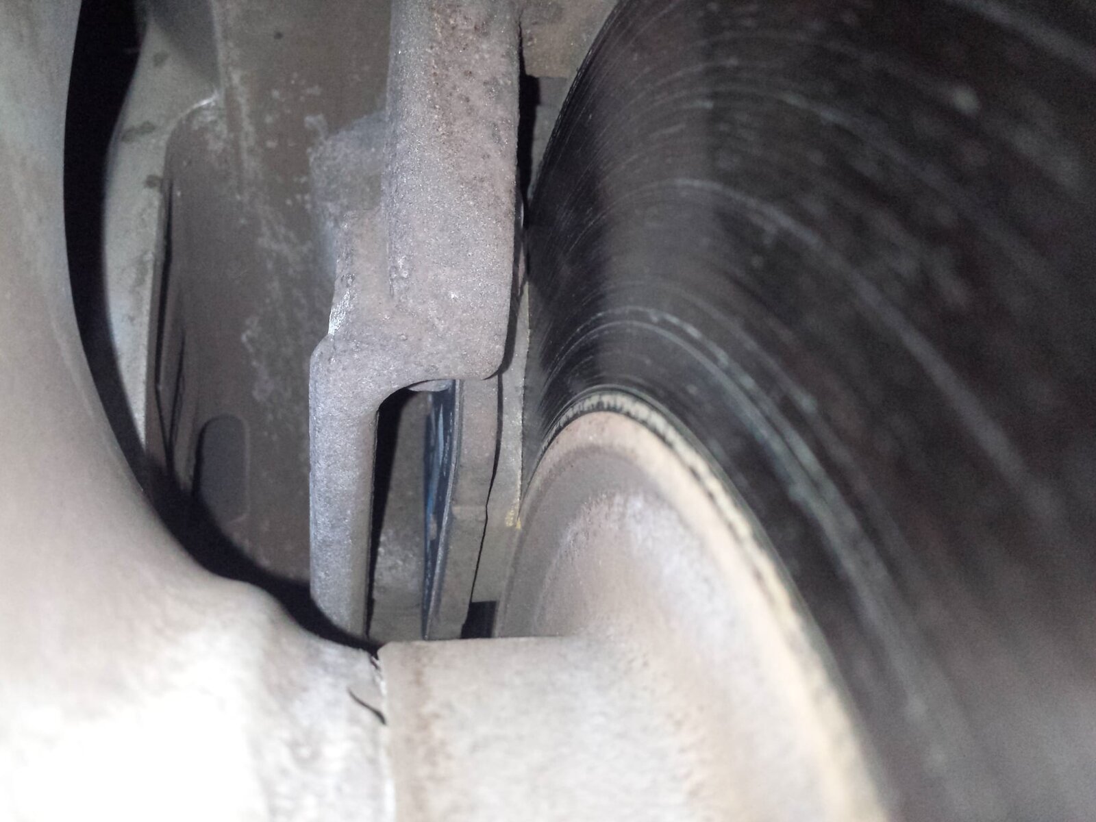

Just started hearing a slight, and I mean very slight squeak/squeal when using my brakes. But, it only seems to be at very low speed (car park manoeuvring speed). It could just be the colder temperatures perhaps.
A visual inspection shows this, do they look fine? I would guess they are OK, but thought I'd post here. bpad.jpg
The last service was only end of July when they checked out fine, and I've only done 1500 miles since then (I am also a light break user). I can't see a wear indicator tab thing.
They do look clean enough from here, but we can't tell how easy it is for the pads to slide on their lands......also, the discs do appear to be glazed a bit.
All will add up to a squeal, and it's nothing to do with temperature.
