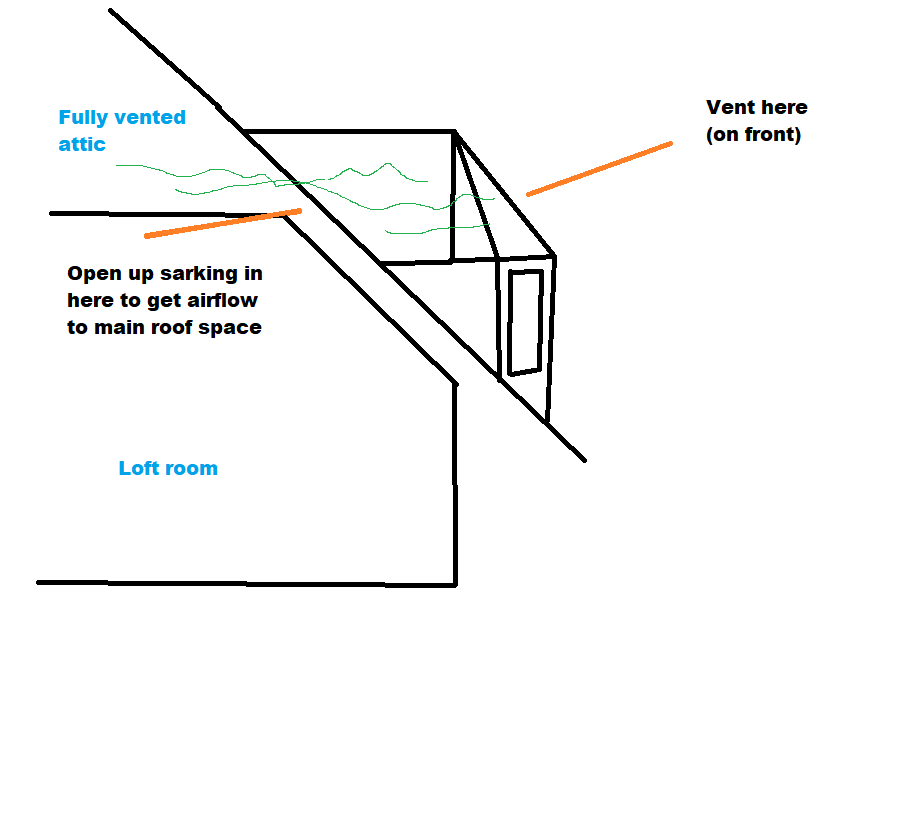

Well, while it won't make it watertight, it does help against wind driven rain which we seem to be getting a lot more of over the years, which is what I wanted it for since rot required the removal of a few dormer rafters and new ones installed. Damaging the membrane by walking all over it wasn't a concern - it was a small dormer that could be leaned over to on both sides from the scaffolding. I did look up the manufacturer BBA certificate and it did state it could be installed on sarking boards directly, so we stapled it on and then nailed in slates.
The only thing I'm thinking about now is ventilation. I know some breathable membranes will not require the usage of additional ventilation, as they are considered open air enough. I don't know if Vent3 Pro fits this, as the BBA certificate doesn't explicitly state if extra ventilation is required or not either way. It just gives vapour permeability figures.
It gives a figure of 0.151MN, which I am not sure how to translate into real world practicality. Do note that this is just a dormer window rood, the rest of the roof is completely open air ventilation - just not sure how much of that would now reach the dormer. I do plan to board the ceiling below it with vapour check plasterboard as is usually advised for loft rooms in order to prevent any potential leaks ruining the plasterboard. Just not sure if that's all enough.
Ok, maybe I can just install one of these (I haven't finished the front dormer peaks slating yet due to the weather, only sides are done. I heard the Ubink vent is one of the best flush ones you can get.
Doing one on each side would have probably been best but if I can do one at the front and then open up the sarking a bit at the back (where it connects to the open ventilated roof space) that feels like it would be enough, yes?
I'd say so; what's your insulation buildup?
For the dormer, I'm planning 200mm of fibreglass over the joists, and in between the joists I will fit 75+50mm rockwool. Avoiding PIR mainly because it has zero sound insulation properties and the walls used to be lath and plaster, so there is significant sound transmission to the room. I could have put 25mm on the bottom but then I'd have issues with the tilt and turn window opening inwards - it's pretty close to the ceiling as is, so any curtain rail would be a disaster with loss of height.
Attached a very crude drawing showing the plan. Green squiggles are how I expect airflow to behave with one vent into the dormer and a path for air to reach the main attic ventilated space.
