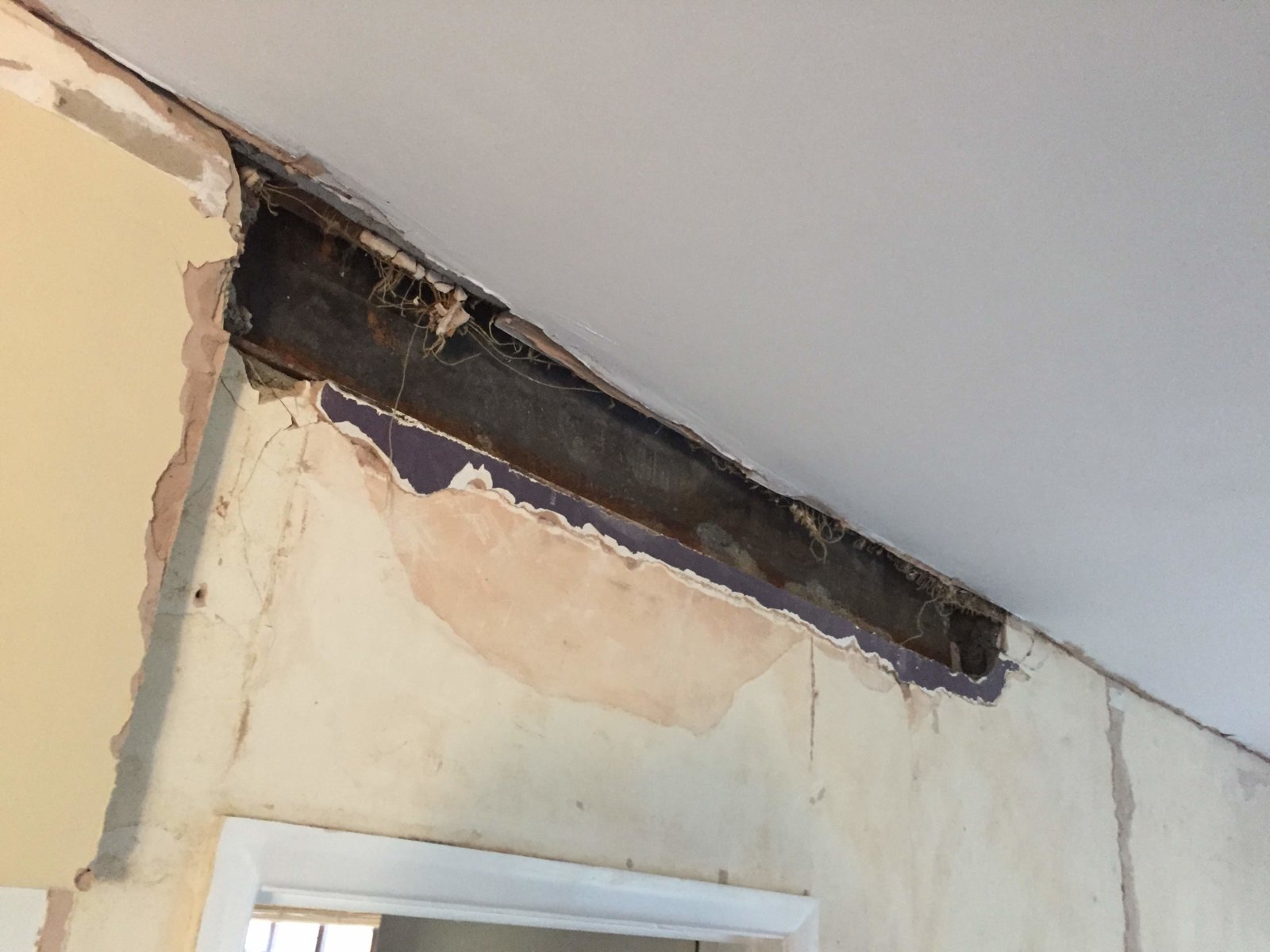

please post a much larger view of that area.
the odds are that its loose filled the length of the beam?
isthe "beam" an RSJ an is that the edge of the RSJ flange we can see?
what is it supportin - are ther joists restin on the brickwork above the RSJ?
is the "beam" above window? does the beam have a soffit?
the black background looks like felt paper - is it felt? is this a bay?

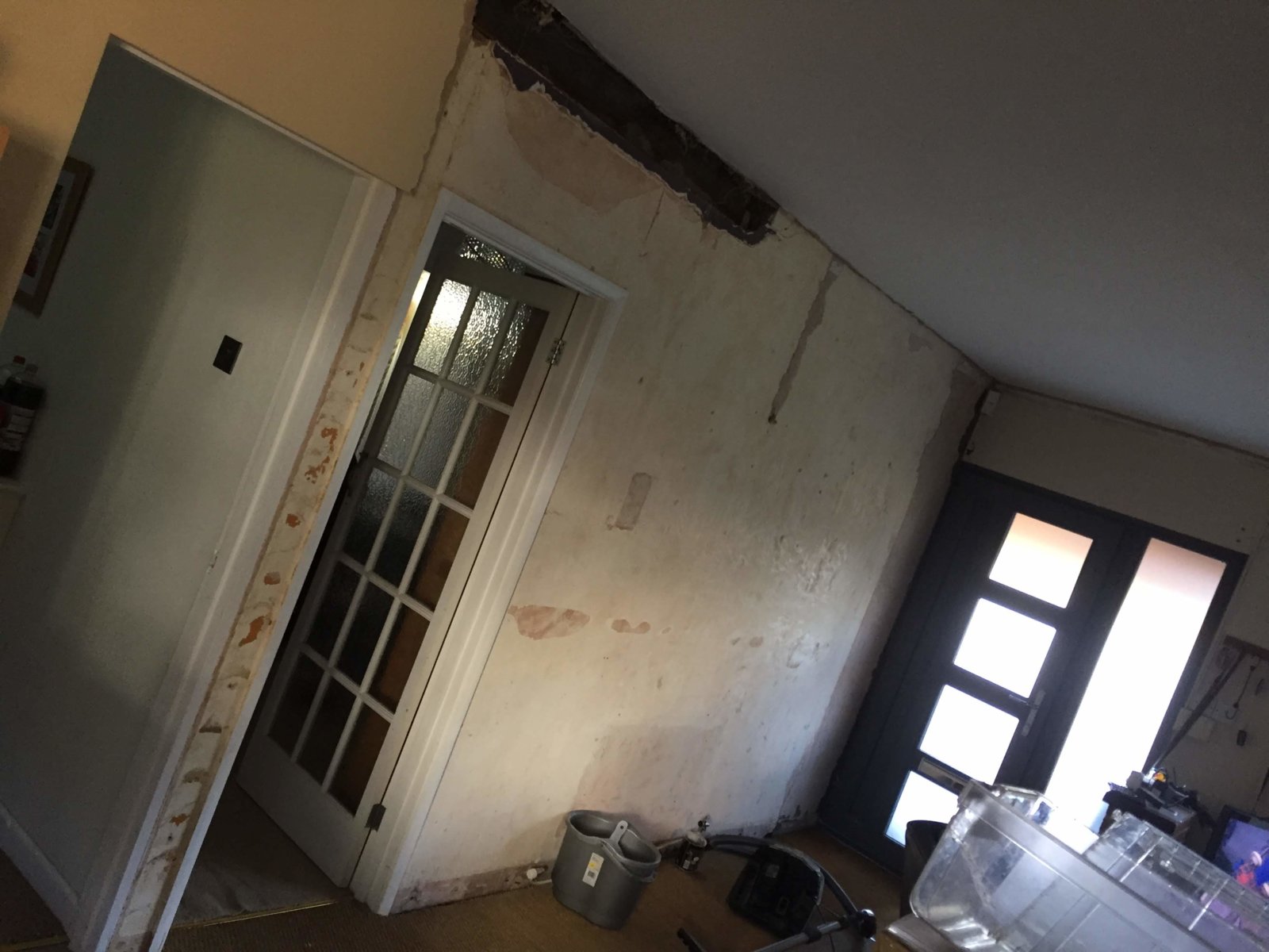

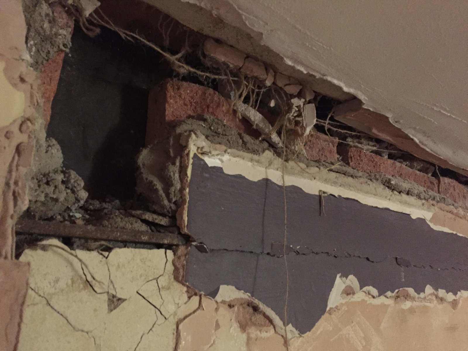

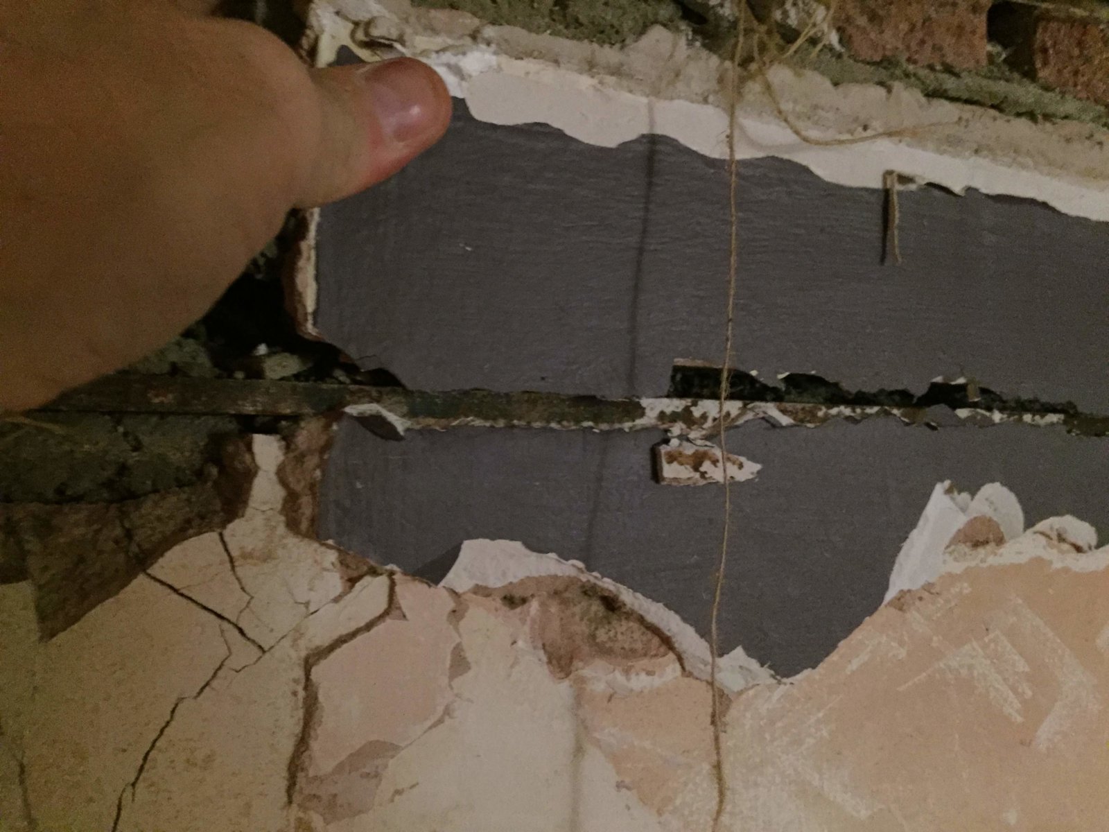

here's a couple more shots - basically I removed the loose bricks and cleaned it out (have small kids running around, didn't want to kill one with loose falling bricks!). And the beam is only slightly longer than what you can see here.
I let my plaster know (sent him these photos) and he said its not something he could fix and I need to call in a bricky to "get it stitched in". I dunno, he seems a bit flaky so Im thinking about getting a 2nd opinion.
As for the cealing - I assume youre taking about the gap? I plan to cover that with coving .

I think it's a wall plate not a beam.
the plasterer is right - repairing falling-down brickwork is not a plasterer's job. Nothing flaky about that.
I think you need to strip out the loose stuff and rebuild it. Lightweight concrete blocks would probably be adequate. You will need to support the floor joist that rest on the wall plate while you do that. It is not very difficult but rather than hiring or buying the equipment and learning how to do it, you may to better to ask around for personal recommendations of a small local builder. Take off all the loose plaster so you can see what you're dealing with. Quite likely the brickwork is standing on the door lining which is not now permitted.
Any thing less than a proper job will crack again, and perhaps fall on your head, or your family's.

The brickwork is sound I think - What I was talking about was a row of half bricks that had been cemented into the "H" of the beam. Its not structural in anyway, it was simply filler to give something to plaster over.
Maybe Im misunderstanding though...
On my PC I can't see an H-section. I wonder why it's there?
Steels are usually boxed in with plasterboard (for fire resistance) then plastered.

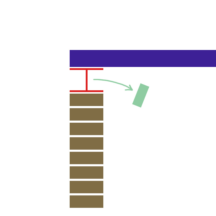

Heres a basic diagram, hopefully this might help.
Brown is brick, red is the metal beam, and blue the ceiling. The bricks that I pulled out where just cemented onto the gap in the beam (see green). Im 99% sure they are doing nothing other than filling the space so plaster had something to stick too.

Get some lengths of 2x4 and wedge them vertically into the web of the RSJ. Then screw some plasterboard to the wood and as long as the level you end up with is behind the current plaster the plasterer can pack it out to the right thickness.
