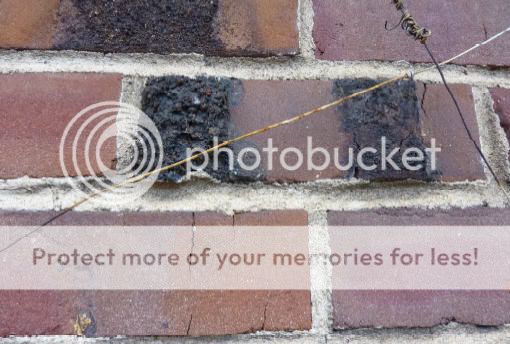

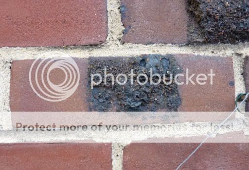

I have been looking around a 1950s house with the view to purchase and have noticed a a black tar-like substance on a lot of the bricks. Any ideas what it could be?
[/img]
If it’s hard & flaky, it isn’t tar; my 60’s built property uses “Redland Flettons” which have a very distinctive vertical bar pattern identical to that but I must admit that’s far more pronounced than mine! Not an expert in brick firing but if it's iron, as nose says, maybe the “boy” put too much on for that kiln firing :?:
So if iron is the cause, is it just a cosmetic issue or will it cause problems? What would be the best way of improving their appearance i.e. could they be cleaned, replaced or rendered. Or would you give the house a wide berth :?:
Cosmetic I would say... Enjoy the differences and uniqueness they bring. I see far too many identical houses made with identical bricks in identical streets :/
If it is merely a process of the original brick firing, it wont affect the structure & is certainly not a reason to deter you from buying; I assume its random over the whole structure?
I don't think it's any reason to give the house a wide berth unless you find it really objectionable; as FUBAR says, enjoy the differences and uniqueness it brings, I quiet like the look of my property which is very similar. :wink:
I was more concerned if it was a structural issue. It wouldn’t put me of buying the house.

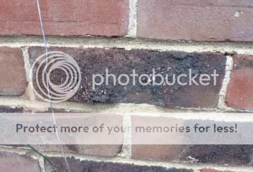

As you can see in the photos some of the bricks are actually protruding. I’m not bothered by the colour but would be interested how they would look if they were sanded off flat? As you mention it does give a bit of character.
:D
Sorry, yes in answer to your question it is random. It seems to be more common on the side of the house than the front. The garage which is freestanding also has bricks with the same effect.
I wouldn't grind it off, it's not likely to look good at all; or at least try it on one where it can't be seen.
