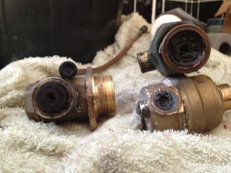

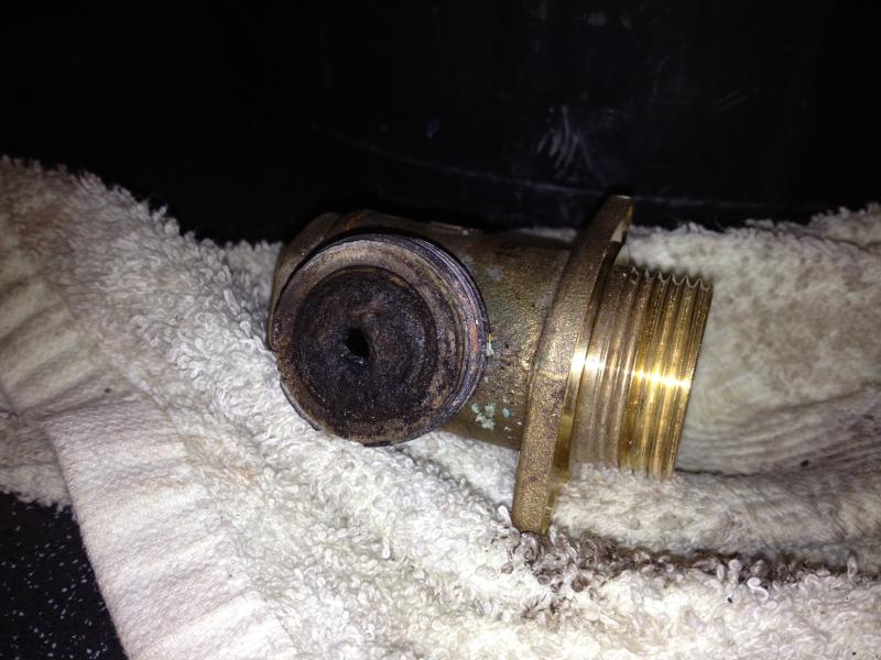

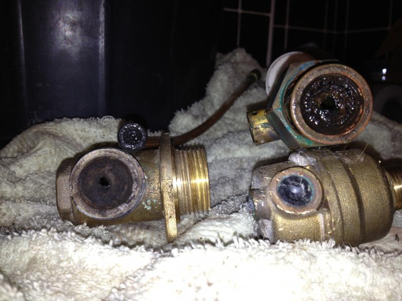

So what is the substance that the pipes are blocked with? is it hard water deposits? or other debri that may have entered through open vent system from the loft tanks? and what other things can cause this? too much heat for example i.e running the CH very very hot! ?
So what additives would have stopped this formation?
iron oxide mostly. Its basically radiators and sometimes cast iron heat exchangers that have corroded on the inside. Little pieces of metal break free float around and eventually collect somewhere else, or back in the radiator. For any type of corrosion to take place you need a reasonable supply of oxygen, which is why sealed systems don't suffer unless they have a leak, in which case the regular topping up re-introduces fresh oxygen.
Good job it is oxide and not chloride then iron chloride (ferric Chloride)dissolves copper, :p
So I get that, oxygen reacts with metal (iron) and produces the oxide, but there is a hell of a lot in that, some of it must be the scale from hard water and running at very hot temps like in kettles.
You wont get much scaling unless your constantly refilling the system, ie a leak, as there is only so much scale you can get from one systems full of water. Its much the same with any combination of ingredients for a chemical reaction. Hence why vented systems with unlimited access to oxygen and metal tend to be the ones that get problems.
