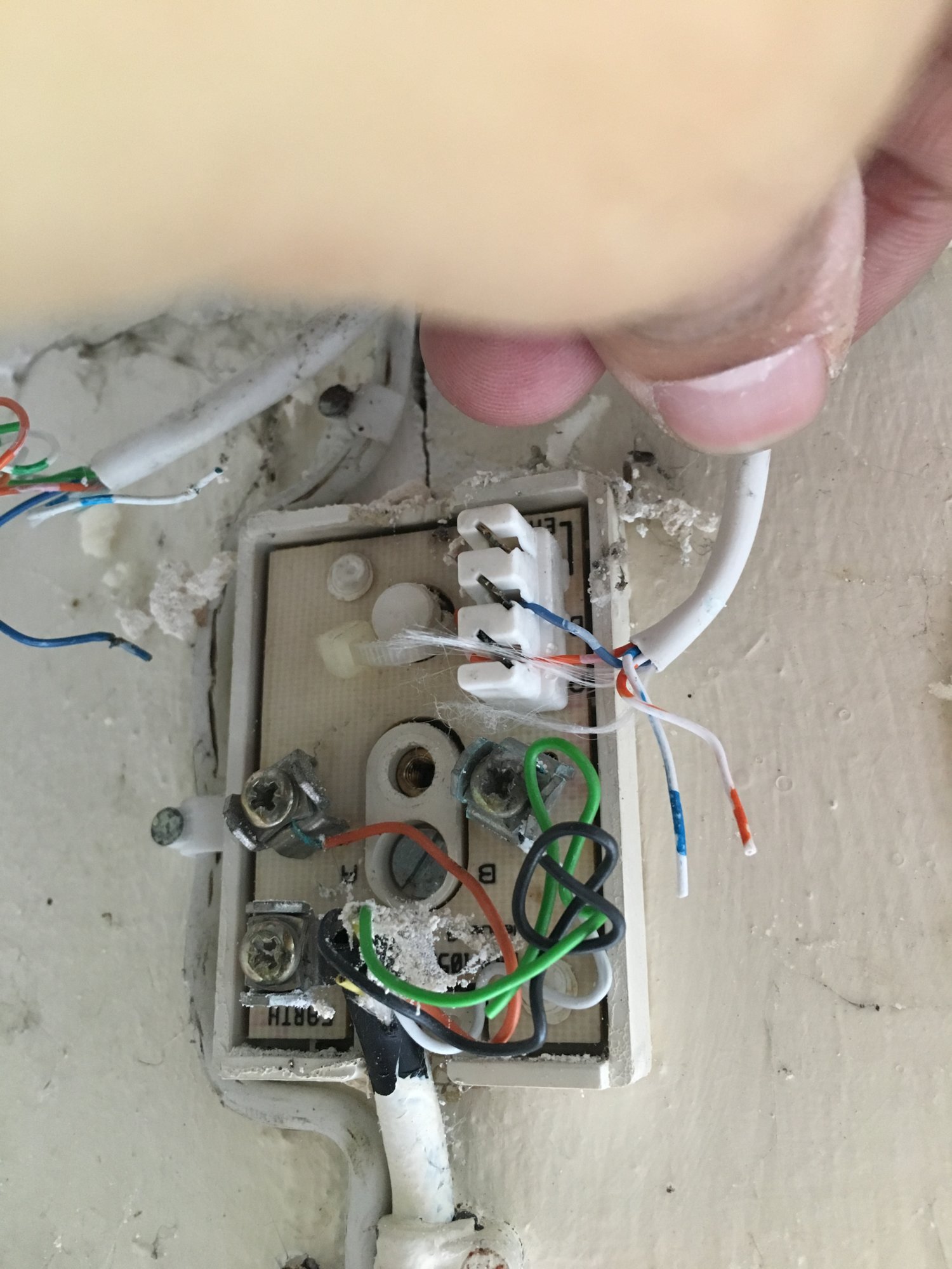

I have moved into an old house last year where the previous owner was 92 and not interested in broadband. The phone line works like this. The drop cable meets the house at the roof where there is a junction box. Another cable comes from the junction box into the cellar where it goes into a BT80 style junction box (see pic - this has the old 'T' telecom logo on the casing). An internal cable comes form this into the cellar where it goes into a normal (non NTE5) socket.
I am not interested in having a landline and I signed up for superfast fibre with BT. What I have done (and i know i can be shot for this) is connect a CW108 cable from terminals A/B in the junction box directly into the house to a ADSL filter faceplate. This is giving me download speeds of 3MB/s which is poor and not what i am paying for. I told BT and they want to send someone out at a charge. Now do I need a VDSL faceplate instead? Or is there a more fundamental issue? I dont have a master socket so wary about asking openreach to have a look..
You have split the pairs. You use either the blue pair(normal) OR the orange pair, not one wire from each.
The incoming wires look a little corroded, too. As you have a tiny amount of slack to play with, snip off the corroded end and strip the wire again to get a fresh bit of copper.
Change it to the blue pair at both ends and report back with the speed.
Also just noticed, your incoming line also has the same problem, the colours should be either orange and white OR green and black, not a mixture. Only BT can fix that though as you need access to 'the other end', which could be up a pole/underground/inside the roadside green boxes, etc. They ought to do that for free as it is their error.
Thanks for the quick reply. I made those changes including the corrosion stripping and slightly marginal gains with a longer ping. The incoming does use orange and white, the photo is deceptive. Could it be the faceplate i am using?

Possibly, if it is just a cheap ADSL splitter which only has a few components on the PCB, like...
The latest BT master, NTE5c Mk4 has loads of components on, most of them for filtering out unwanted noise to improve speed.
https://www.ebay.co.uk/itm/323845185543
You should have a master anyway, so would be worth fitting one IMHO.

Thanks for these replies. I see where I have gone wrong. My faceplate is fitted into a backbox NTE5a which i bought at the same time as the ADSL faceplate. It was this one
https://www.amazon.co.uk/gp/product/B006V1P39A/ref=ppx_yo_dt_b_asin_title_o05_s00?ie=UTF8&psc=1
I have been running the tests over wifi :rolleyes:. So that coupled with my confusion between bits n bytes has led me down the garden path......still i wouldn't have figured this out without your input so thank you.
I will buy the NTE5c master -thanks for the link - and use that instead to see if it makes a difference. My concern with asking openreach is that they may see I've tinkered with the junction box and whack a painful charge on.
