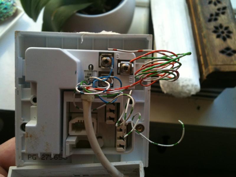

Hi, Our landline phone has stopped working, but our broadband continues to work. I have included some photos to show our set up, any ideas on what might be wrong? We pay for broadband, phone and tv with sky.

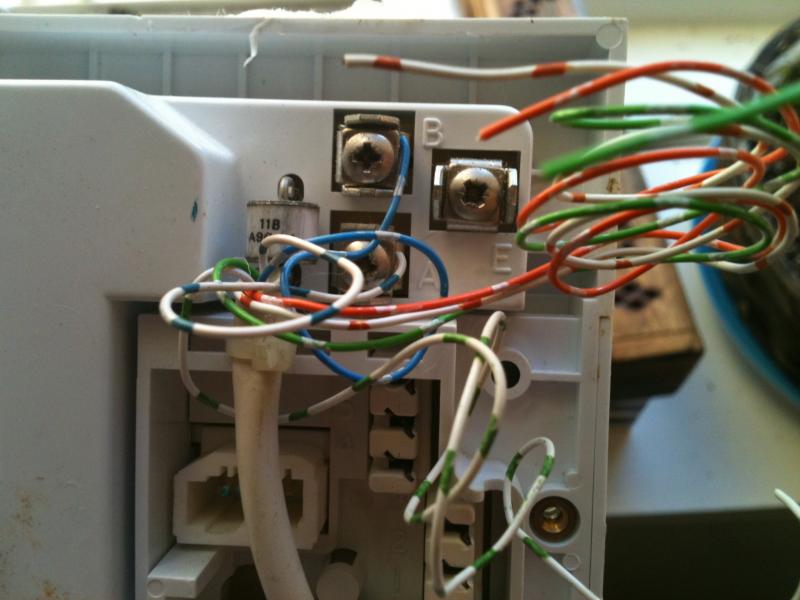

I'm wondering if the thing that says 11B on it has broken/gone?
The cable comes into the house by the window, to a small box with a screw on the top (see 1 of the three pics) and then the cable runs to a bt master socket? (unless that is what the thing by the window is? I'm not sure what these things are all called), anyway, and we don't have a dialling tone, but our internet is working? It's only the two blue cables that run to A and B.
Any ideas please?
Try plugging a known working phone into the test socket behind the removable front portion in the Master Socket (NTE5), you aren't meant to play about with anything in the back of this socket.
If you still can't get a dial tone then report it to Sky as the fault is at their end.

the main nte master socket (big one) will only require 2 wires connected to it, on the back plane 2 & 5 A & B
normally blue (touch of white) and white/blue.
The removable front plate is used to connect all other wiring (extension sockets in the premises)
If you have any other extensions in the house removing this section will disconnect them.

If not check the connection to the terminals, yours looks ok from the pic ( give them a tug), the wires are only stripped back a bit to expose the conductors.
The cable will go to the block terminal (small white box )
Same 2 cables will be connected to an external feed, Maybe screw could be idc (punch down)
If both in/ out screw give a tug, looks bit damp on the window still.
