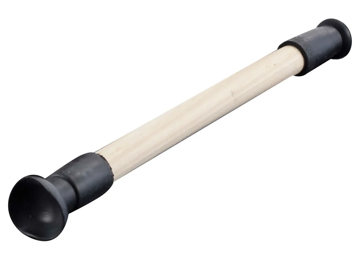

When my pop up plug stopped working, I used my valve seat grinding stick to get it out. Worked for months!
