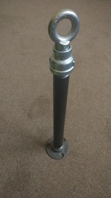

I’m making a loading pin for weight training (rather than dropping £30-£40 on commercially made versions) using a floor flange, threaded pipe, reducing socket and eye bolt. In my ignorance I thought 3/8” was 3/8”. Having since read up on BSP I now realise why a 3/8” eye bolt will not fit with a 3/8” BSP thread.
I’m wondering if there is a bolt thread size which will fit, or if I’ll need to use a nut inside the reducer to thread the bolt through.
