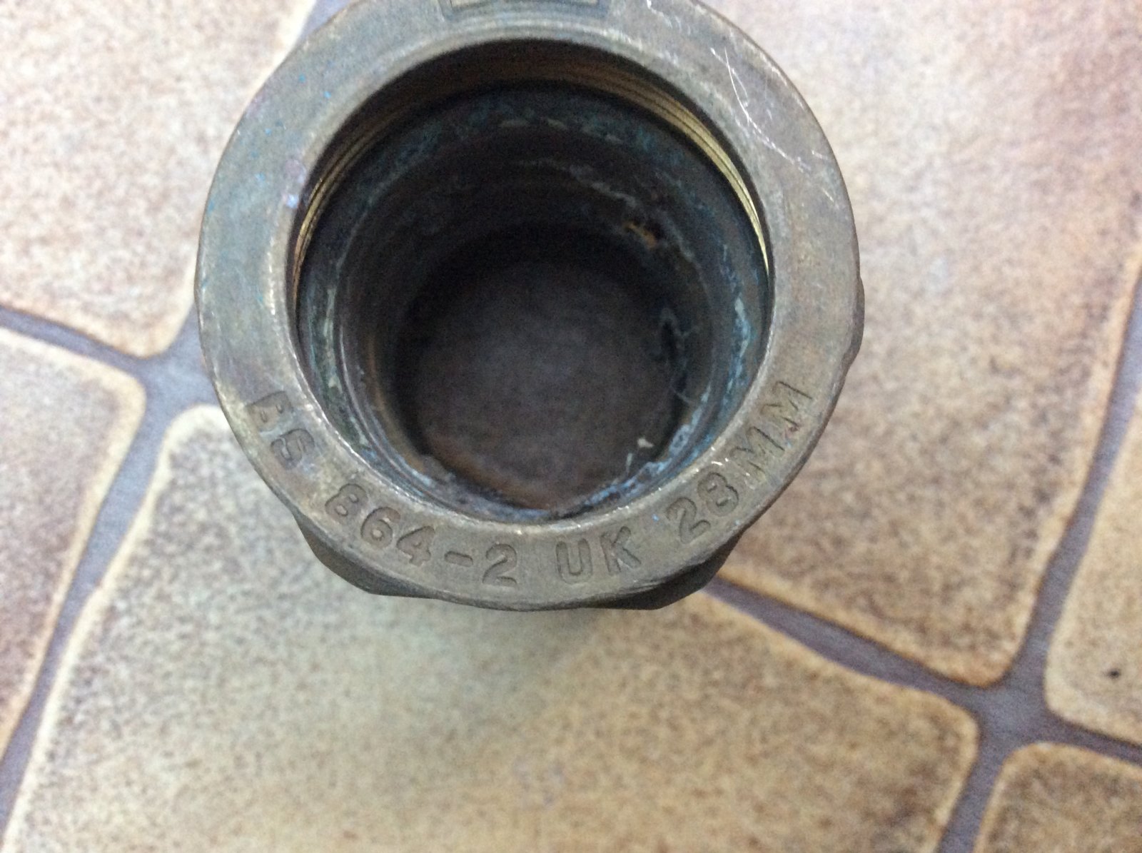

D25D060F-5D5D-48DA-8FC7-39529C0362BC.jpeg 713B8955-1AC9-4EBB-A2A0-A7A6BD18807D.jpeg

Nige, you were spot-on! I ordered a 28mm compression fitting and the ring on it is a perfect fit, thanks!
The text on the nut gives it away!! BS864-2 was the (obsolete) British Standard for compression fittings. 28MM is self-explanatory.

I went into the workshop as I knew I had loads of old fittings kicking around specifically to find something 34.88 diameter which I did...then found a nut to fit.
When I re read the thread and saw Nige F ‘s post I thought Id better post the pics to confirm his suggestion
hope that makes things clearer?
