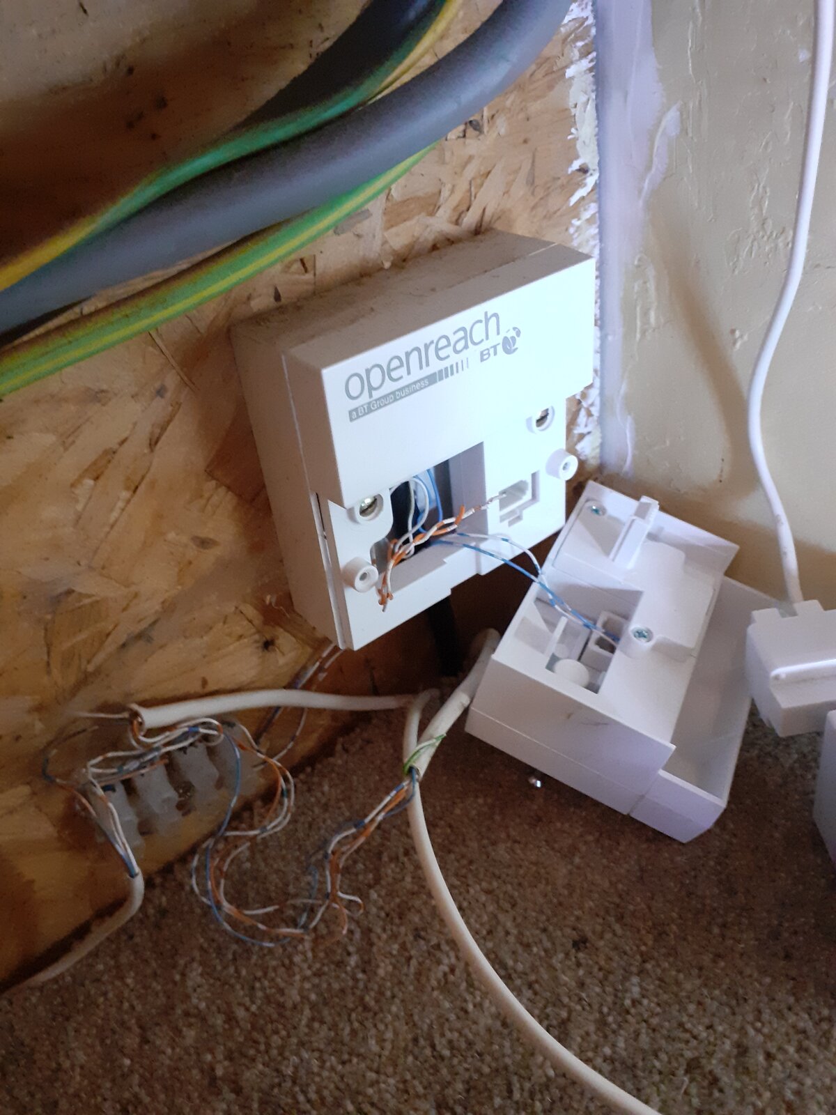

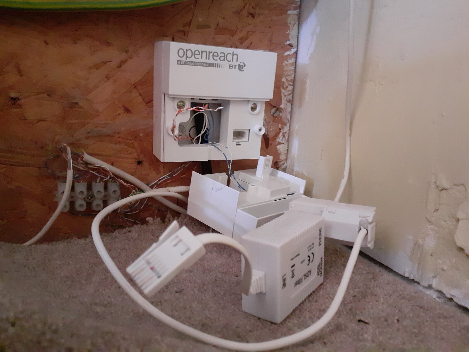

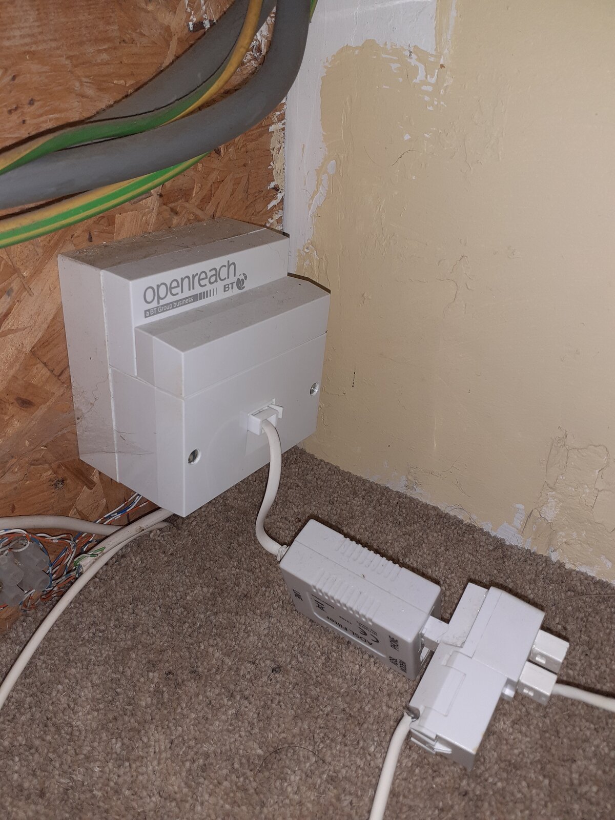

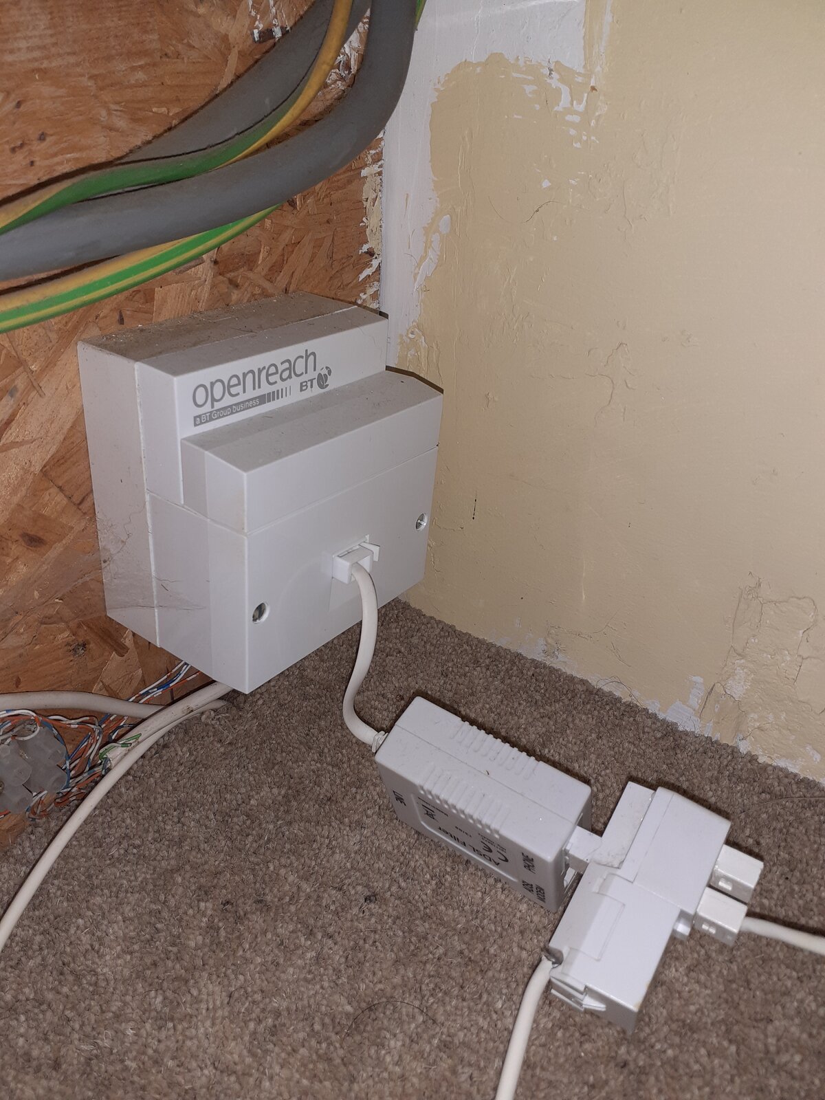

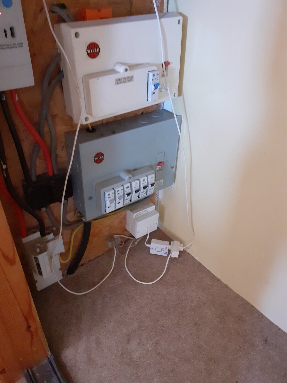

Wonder If I can get some help.

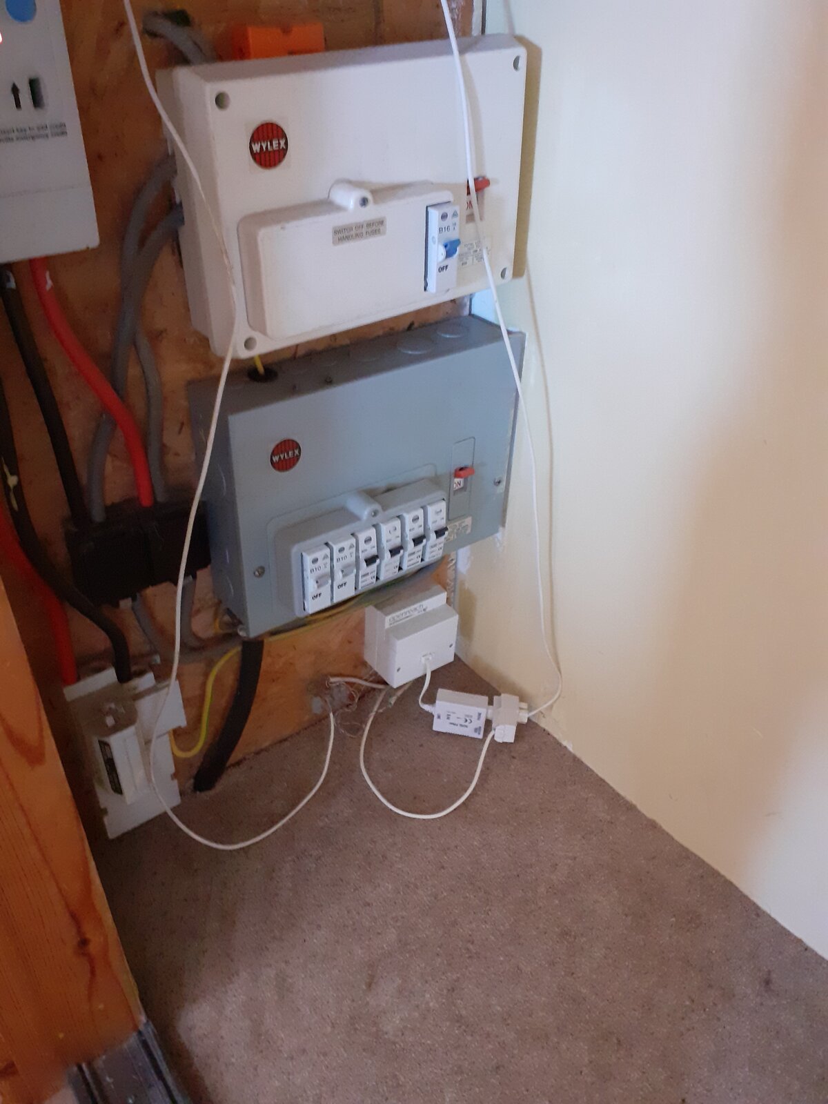

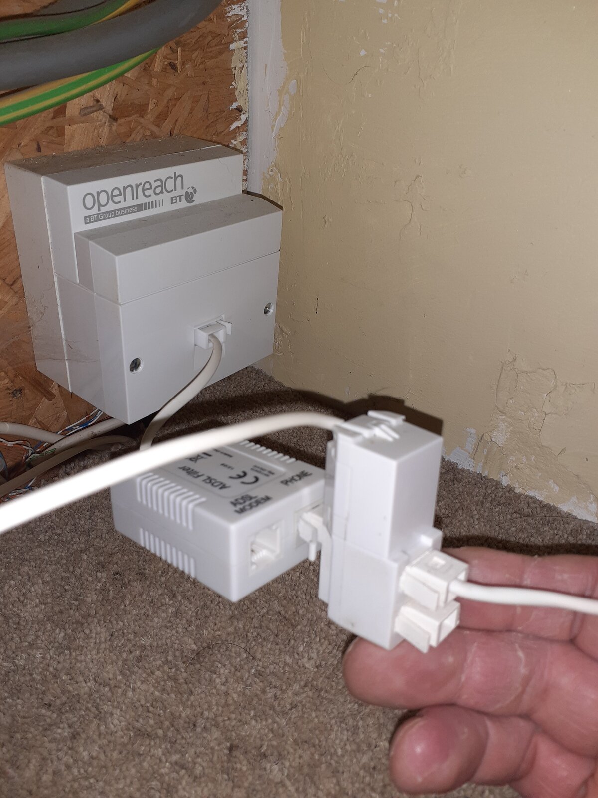

This is my master socket sited on a coat, shoe cupboard ( right under Consumer unit ) as we enter the house. When we bought the house there was a Tel Extension socket in a good few rooms. These have been blanked off as we decorated the house. As you can see on one attached photo the wiring for extensions seems to have been a DIY affair using terminal blocks. We now just have 2 sockets left. One is in the down stairs Lobby where the main telephone is. The other is in small down stairs bedroom the other side of the Cupboard which we use as an office with PC and Router. The routers plugged into this and works ok. You'll see that there is a socket plugged into the master socket after the filter that has another plug into that, but there's no plug in the filter for Modem. The Plug that's in the back of this "Connector"? seems to unclick but wont pull out. This has been the way it was since we bought the property. I want to start tidying things up and wonder if I can get the answers to following questions
What type of master socket is that and can I upgrade the face plate to any advantage.
Should my router extension socket be plugged into the ADSL plug on the filter. Given the way things are, how do Identify what wire goes to bedroom / router socket
Do I need that plug that plugged into the filter.

You have what looks like an NTE5a master socket.
It's up to you how to tidy things up, but for the fastest broadband speed, it would be best to get an ADSL faceplate, something like this:
https://www.amazon.co.uk/Solwise-ADSL-NTEFACE-SOL-ADSL-Faceplate-Splitter/dp/B003H6GUNA
The modem would then connect straight into the ADSL socket with as short a lead as possible.
It would still be possible to clean up your existing wiring, but wouldn't be as optimal!
I hope that helps :)
Hi Thanks
I am sure we are on a FTTC connection although a good distance from the cabinet. I have Talktalk Fibre Broad band 35mbs. Max poss speed from cabinet is 20.5mbs and I get 15-17. ADSL or VDSL face plate required or does it make no difference???
Also, with these face plates is it possible to hard wire the Modem extension socket in office straight into the face plate using Cat 5e. The cable run would only be approx 2-3 m. Like wise, can I just start from scratch with the telephone extension socket wire and hard wire this also into face plate so no need for plug ins to the face plate.

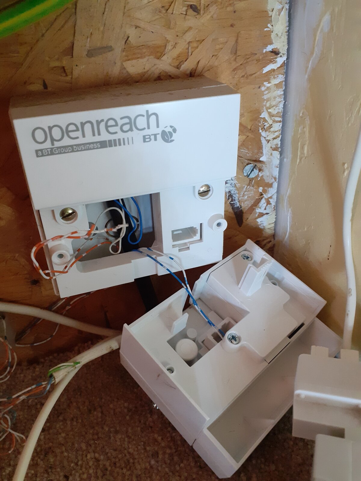

...and just relooking at the photos, it might be worth taking your existing faceplate off. Something odd might be going on underneath!
Hi again,

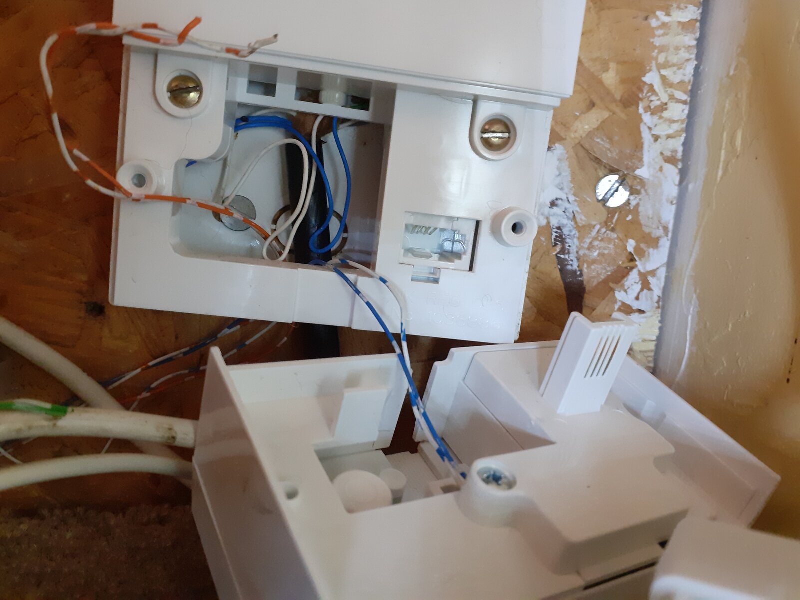

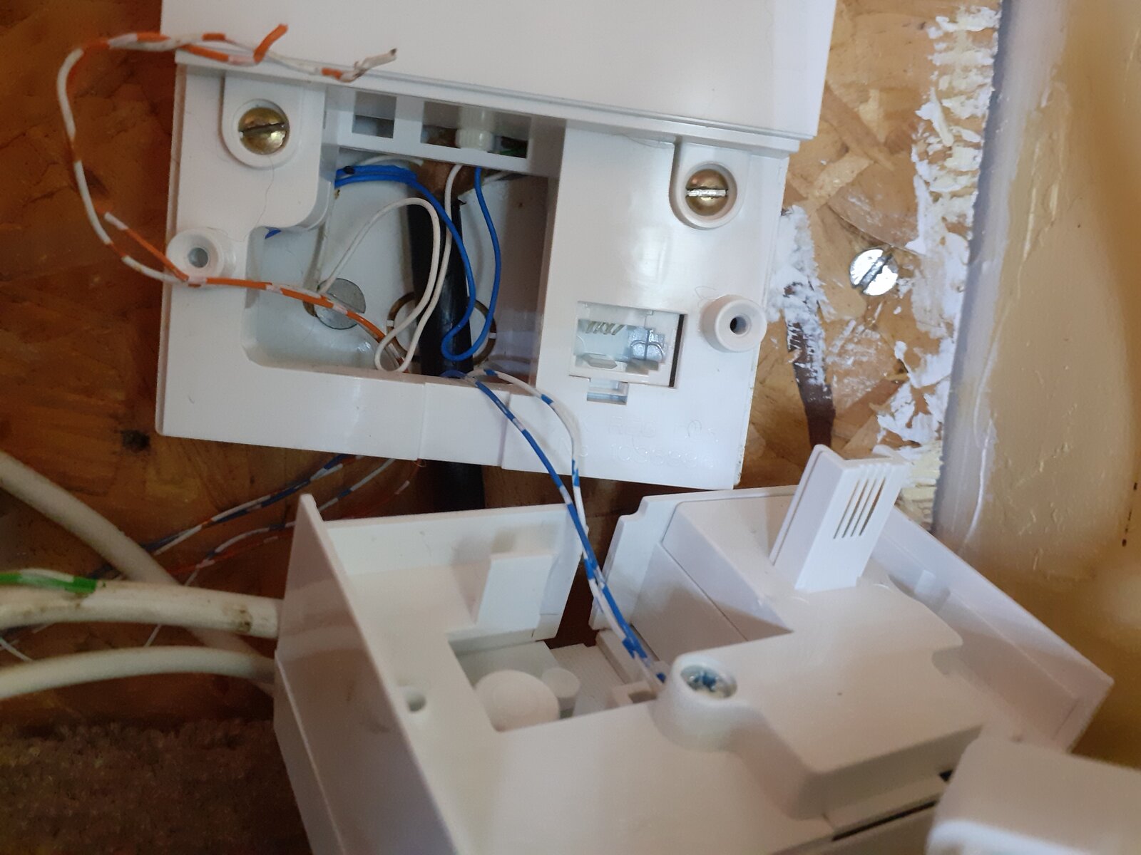

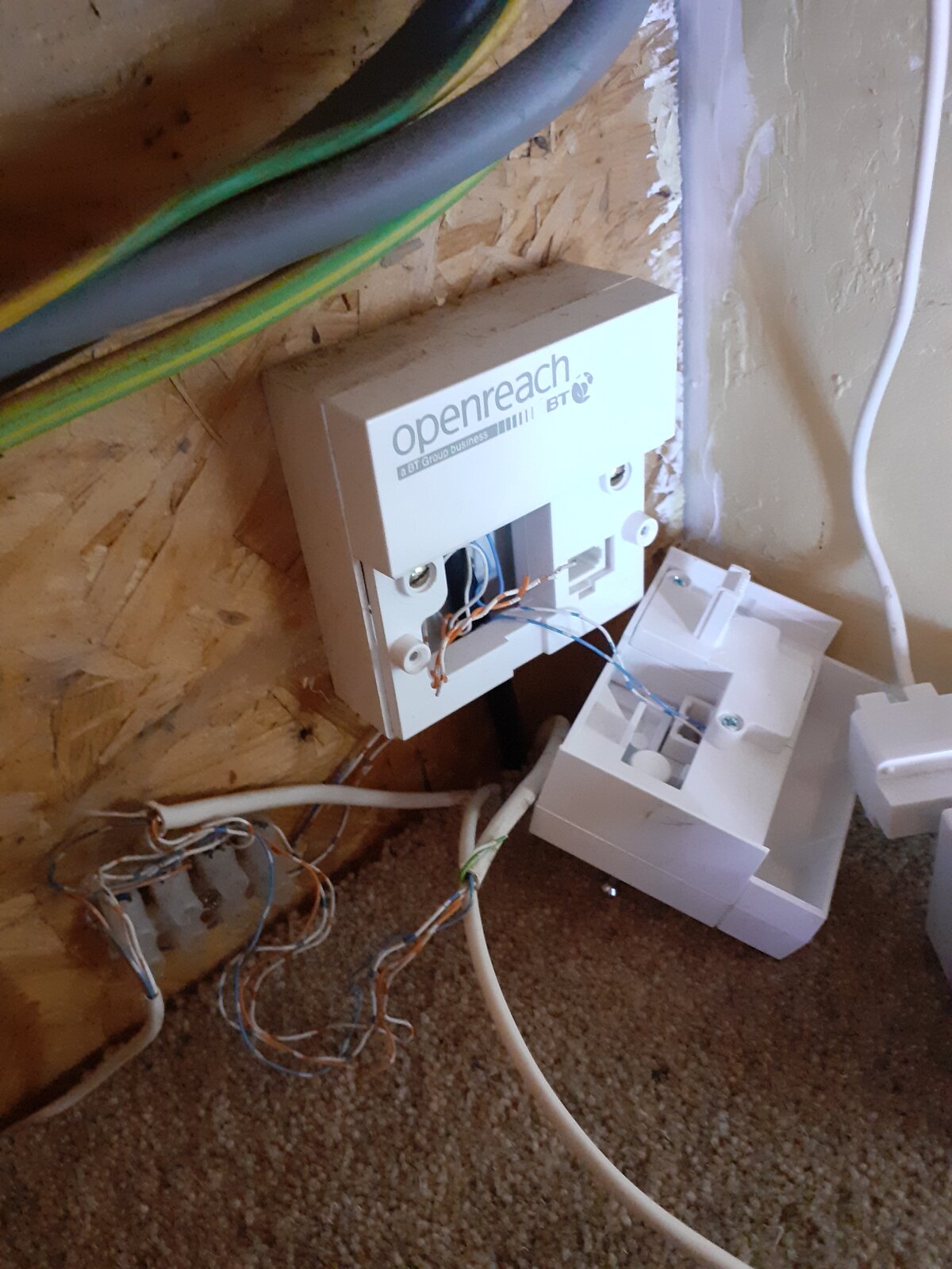

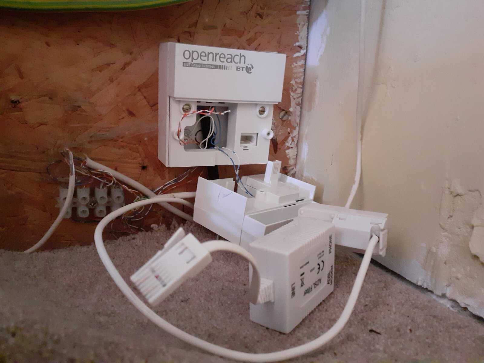

Thanks for the links and advice. I'll probably be ordering the item from Run-it-direct which replaces both just in case. I have a cheapo punch down tool as I've just run data cable from my router to dining room tv, and some spare cat 5e. Your last comment "something odd " has spurred me into taking some more photos with the face plate off. When the micro filter is unplugged from the face plate, the existing phone in the Lobby was dead and no internet so I guess these are the only 2 wires in use on this face plate plug. There were a good few extensions in the house original ( even to the Garage ) so I'm surmising that all the other mess of cables and block connectors can go ?. The Blue-white / white-blue wires to the face plate are actually coming from one of the block connectors. The orange white / white orange that are not terminated run from the block connectors also. I really want to get rid of these connector and just make a tidy job of it. Anything odd in the photos ?

It wasn't clear that there was a terminal block in your original pics.
I think that looks fine. As long as it is only the blue/white pair that is connected and the orange/white pair are disconnected, that can all be removed. It would only be an issue if any of those cables was going into the back of the nte5 box (the side that shouldn't be touched! ;))
Just a bit confused. if the blue white - white blue from terminal block are feeding the face plate, what's feeding the terminal block ? shouldn't these to wires come from the Master socket ?
Sorry if I caused confusion. I meant as long as it is only the blue/white pair that is currently connected to the faceplate, then the whole terminal block can be removed (including the blue/white pair!).
The nte5 box should be fed from a BT cable inside the box.
I hope that makes sense.
Yep, Perfect sense ( I think ) The wires coming from the Face plate are what's feeding all the extensions. They are only fed when the face plates plugged in
Thanks again
