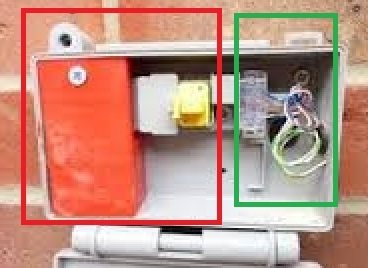

This is an External NTE
You must not touch anything inside the red rectangle but you can ( and may have to ) connect your internal wiring to the terminals in the green rectangle.
