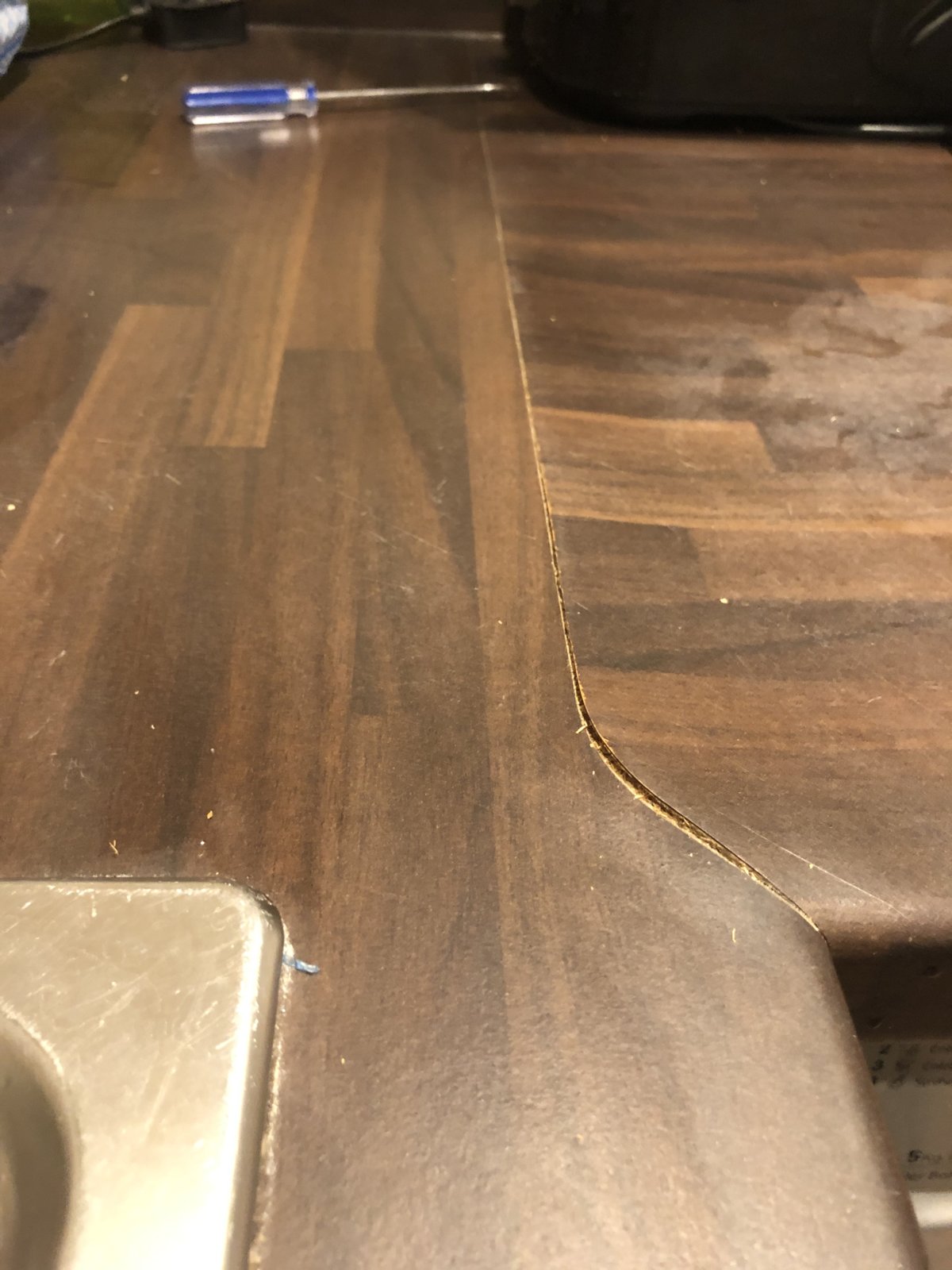

found this large bubble along the seal. Is there anything I can do to reduce the size and re seal the joint?

No, nothing to be done.

Water has got in and swollen the top , the inner chipboard will disintegrate , only option is replacement .
