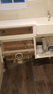

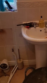

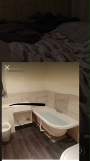

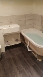

Photographs of before and during .
Well a pictures better than a thousand words !! I thought bath was lengthwise left to right !! Any way the basin waste looks as though it goes straight thru floor as well. All looks good from plumbing perspective there. Can't see how the fitters could go wrong its dead straightforward .only question really is what's blocked it up below floor again. Only real plumbing difference is new WC cisterns are limited to 6 ltr flush maximum and half flush even less. If your old WC was original 20 years old it would probably flush 9 litres or more. Maybe that's the difference ,especially if underfloor pipe run is not in tip top condition and someone if flushing kitchen towel. It will not breakdown like toilet roll. I think your fitters are pretty blameless. Goodnight for now.
