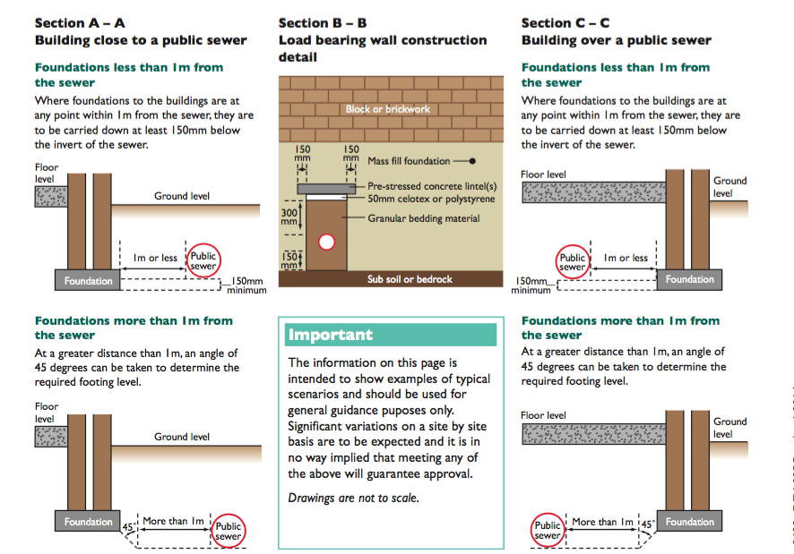

I am now thinking to do this myself... wondered if the drawings needs to be in detail or can i sketch up myself? i know where the man hole is and how pipes are running etc
or do i need architect to do the drawing properly?

I'm guessing the existing foul pipe now sits either under / over or through the new foundations? Thames water will only be concerned at this junction and will need the cross section detail including dimensions to make their comments. If for example the existing foul is clay and sits directly under the new foundation there would be a risk of fracture (if no measures have been taken), if its through the foundation (and again a clay pipe) it should be sleeved and a rocker installed. As noseall above say's if you could provide more details more advise could be given.
You are supposed to apply before starting work. They will then decide if they want to survey the sewer to see if it needs remedial work (which they will pay for) and if they are happy with your plans. Once you start you can't prove any damage was already there so it could get complicated.
Two options now. If building regs have been signed off then you could forget about it. Might become an issue if you sell or if there is a problem with the sewer but it will save you hassle now and a few hundred quid. Or apply for the build over agreement. You can do your own sketches. Just show the section through the footings, a plan view and list any special considerations. Hopefully they will just send you a letter saying they are happy for you to proceed. If they want to survey then it's time to get a bit nervous :)

Is the sewer serving only your house or does it also serve other houses or properties that you do not own ?
If it serves other properties then it "belongs" to the Water Company as far as maintenance is concerned. In which case they need to be told.
How did buildings regs sign off on this anyway? My private building regs inspector automatically informs Thames Water and this forms part of the approval as he wants it before giving any final certificate is given or indeed before works starts.
As noseall says - The distance & depth relative to your foundations is key here - General rule of thumb for public sewer.
